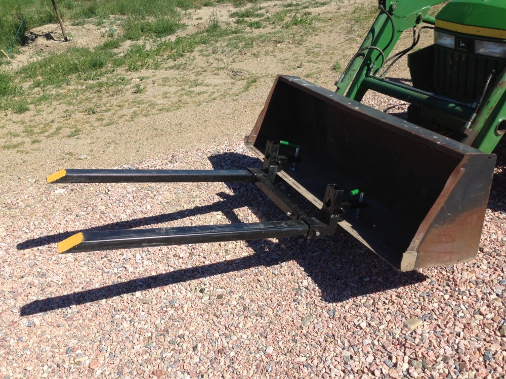

I work alone. On firewood duties I like to scoop up a bucket full of rounds and raise them to the wood splitter height so to avoid lifting rounds onto the splitter table. But, there are too many times during the course of the day I need the pallet forks and it gets old swapping between the two.
I'm wondering about cuttin slots in the back of the bucket and welding fork/tine sleeves to the top side of the bottom of the bucket. I can use the log grab of the forks to hold the bucket from falling off the tines when tipping the bucket.
Good/bad idea? Any issues you can see with it?

What about clamp on bucket forks?

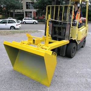

Google forklift tilt bucket. We use them at work with 2 or 3 yard hoppers. Would work well for firewood.
   / Bucket mounted on pallet forks - am I crazy? #8
That, or build a "box" that fits on the forks. Then you can roll wood into the box, or set it down and use the pallet forks to push rounds into it.
