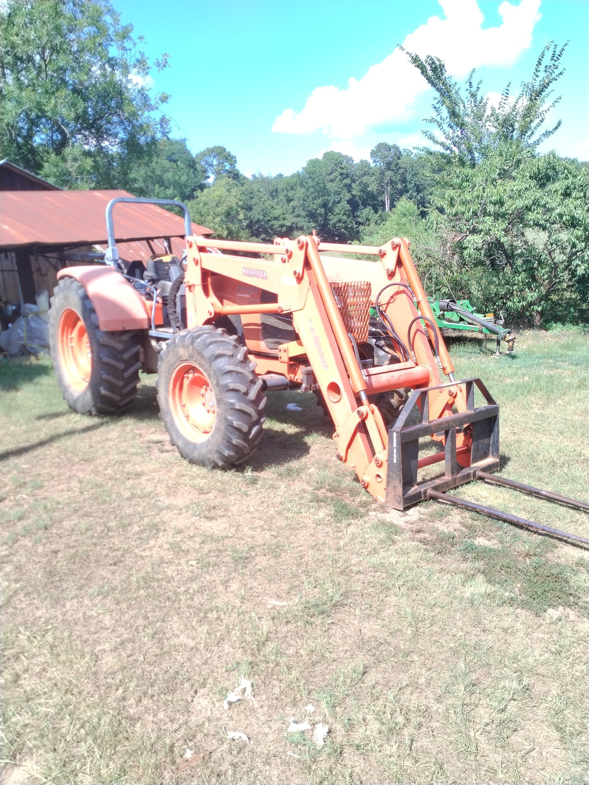

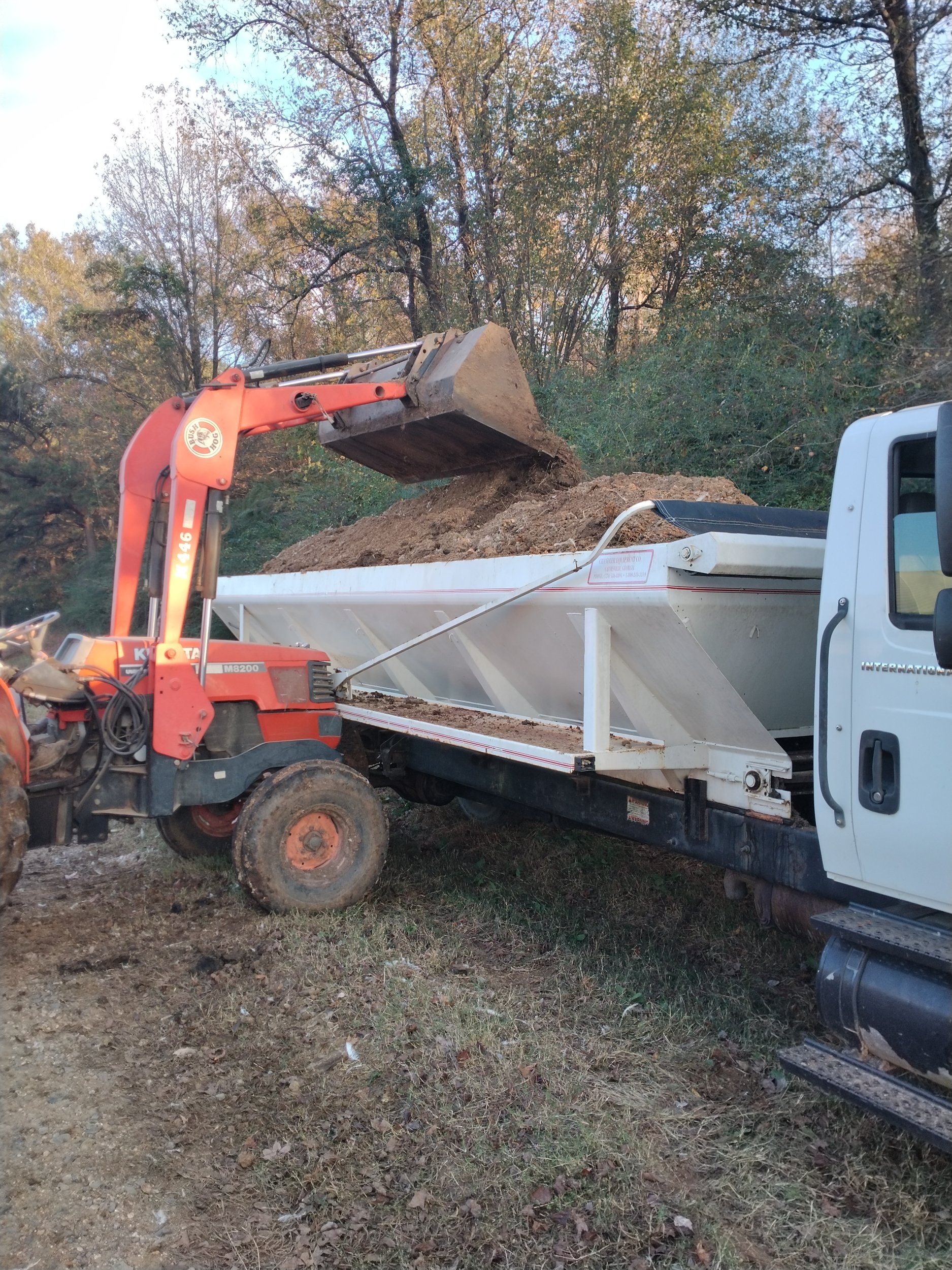

Cut the tube off 3/4" and be done with it. We use six tractors at the farm. None have bucket level indicators on them. Other farm I frequent has three loaders, no indicators. We load and haul 4-5 hundred loads of manure, truck loads, each season. As you can see, no indicators.
