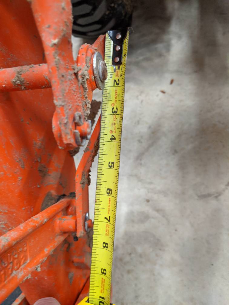

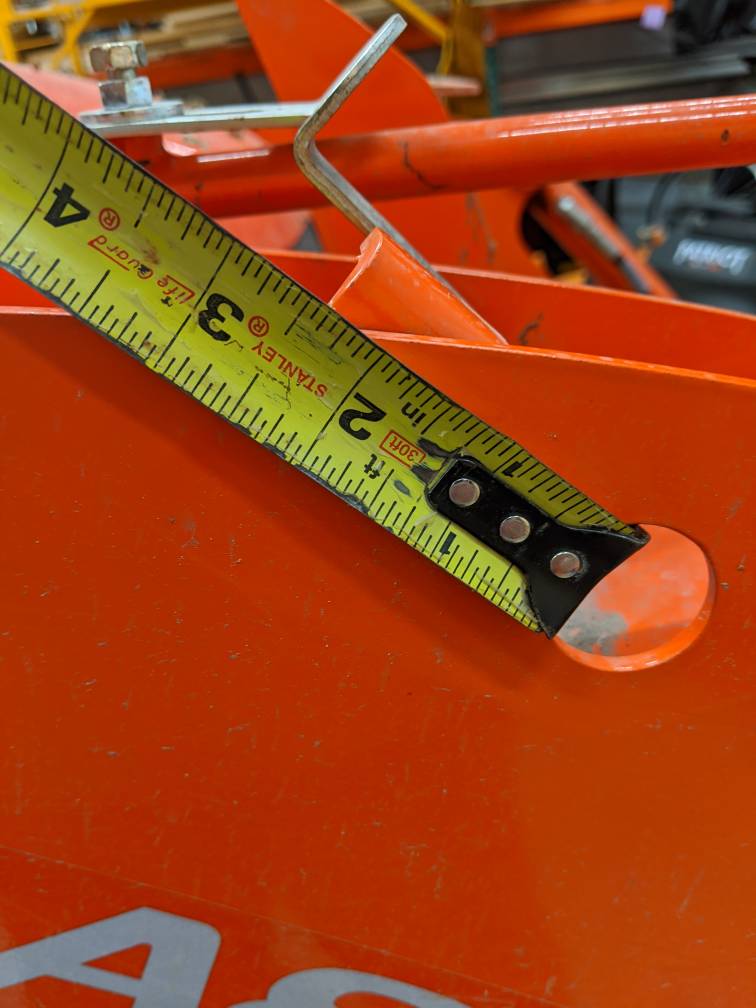

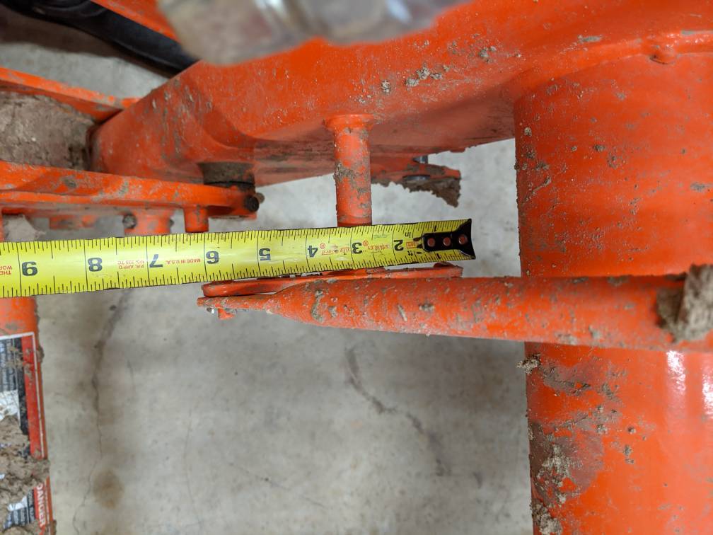

That area looks pretty good I think IMG_20200418_150554.jpgIMG_20200418_150617.jpg
   / Bucket Level Indicator Adjustment for Grand L #42
The position of that front rod holder looks different.

Lower stuff all looks real close

All the images I shot were taken with the bucket level and sitting on the shop floor
same here. bucket is down and bottom lip is level. what style bucket do you have?

Looking at the pics, aren't the very lowest links different between the two of you? Everything else looks the same.
