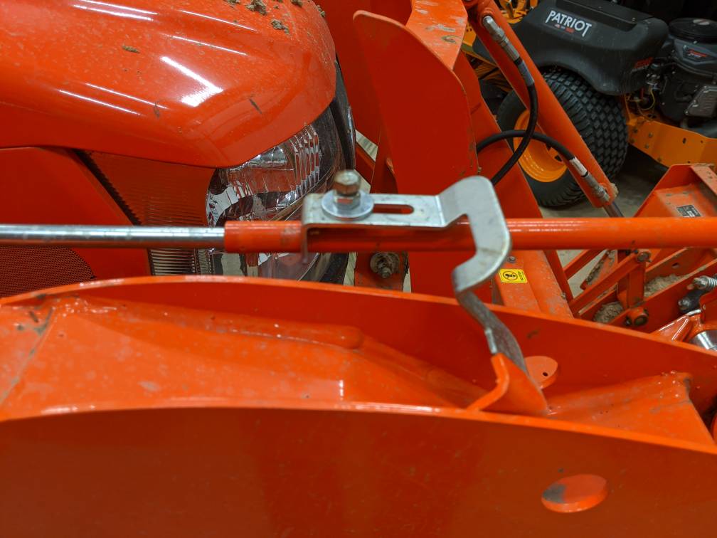

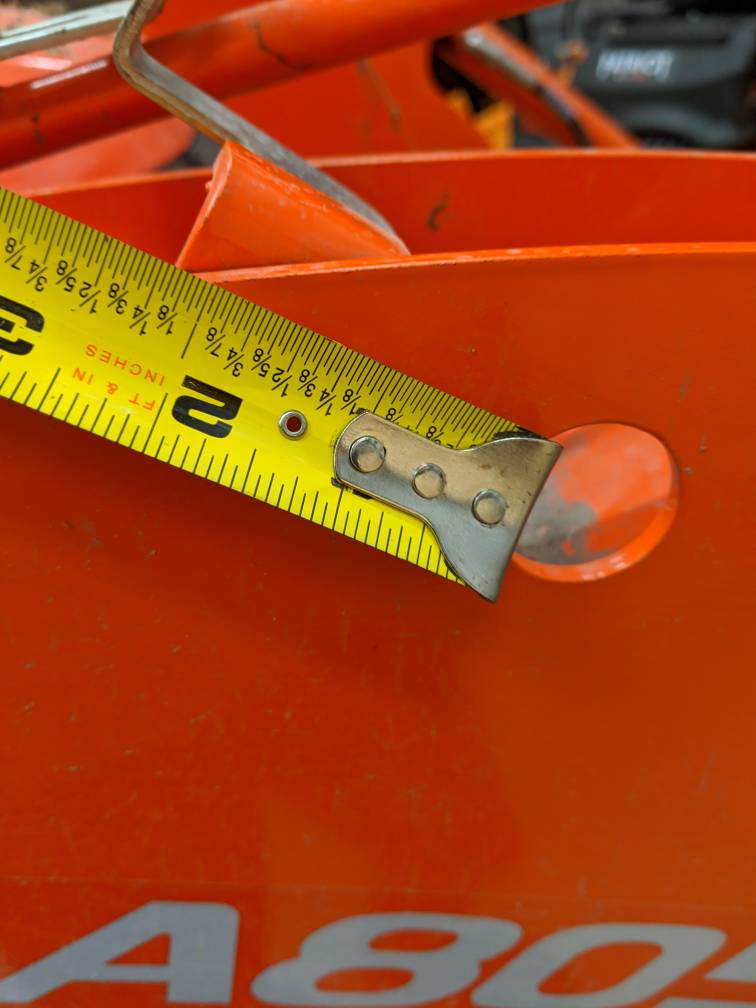

Can you show the dimension from the orange indicator plate to the hole in the loader arm?
Like these?
   / Bucket Level Indicator Adjustment for Grand L #32

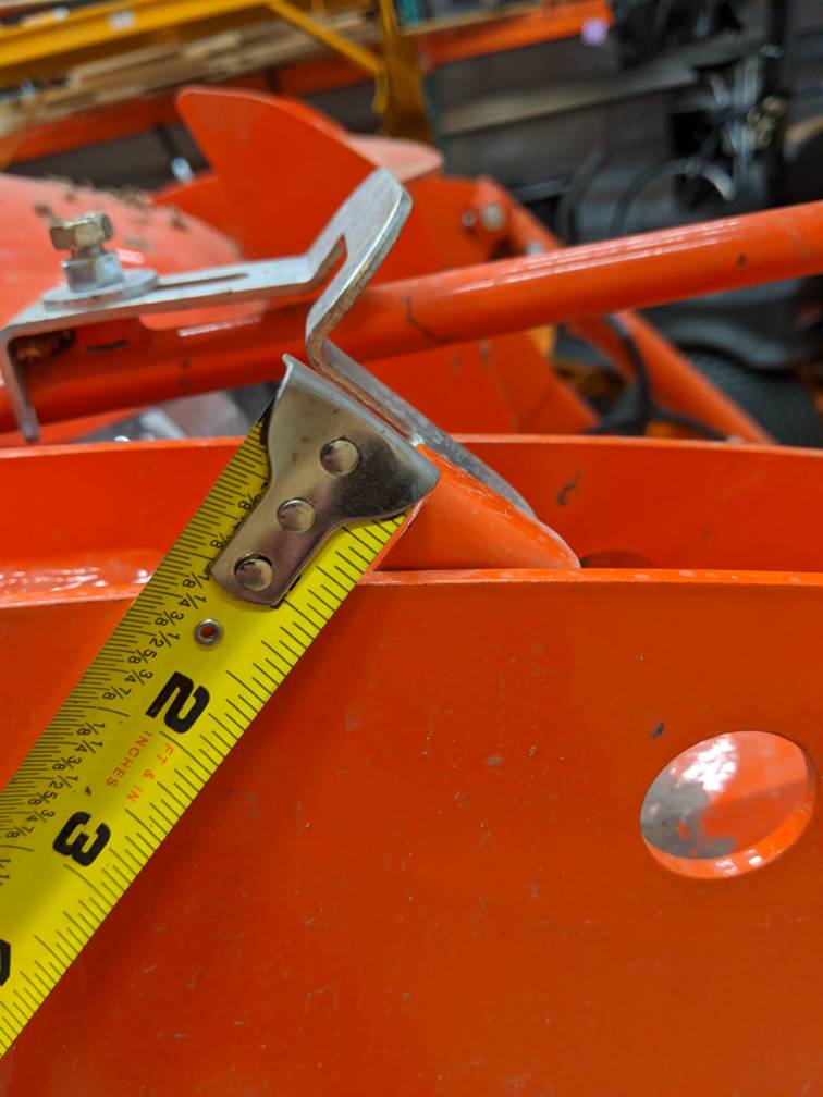

I've never adjusted the indicator rod since owning but being such a laid back day I decided to. I've read the manual and for no reason at all can explain why I'm unable to make this work. The indicator rod i can get adjusted but the plate I can't. Its almost like the plate isn't long enough. Photo attached is with the bucket level and you can see the plate is out of adjustment. This isn't a needed item but if its on here it might as work correctly. any thoughts?View attachment 651144
Can you try to take a photo from the same angle as the first post. Something is weird.
#33
Everything I've seen so far looks just like mine. I was really hoping for a bracket to be installed incorrectly or something. This is bugging me. It's a easy fix by just building a longer indicator plate but I'm not giving up yet.
   / Bucket Level Indicator Adjustment for Grand L #34
That's why I'd like to see a photo like post 1. Kubota acres bracket looks like yours, the orange bracket looks like it is welded in the same position. Somehow the orange tube looks out of position.
#35
It is. My bucket is level in that photo and the indicator bracket which should be parallel with the orange bracket can't be adjusted anymore.
   / Bucket Level Indicator Adjustment for Grand L #36
Oops, I meant AllByteNoBark. I'd like to see him replicate the photo in post #1.
Something is goofy with your orange tube.
   / Bucket Level Indicator Adjustment for Grand L #37
   / Bucket Level Indicator Adjustment for Grand L #38
I think I see the difference. On mine the lever the rod attached to is straight up and down. Yours is leaning back.IMG_20200418_083450.jpg
   / Bucket Level Indicator Adjustment for Grand L #39
What is the length of the tube/rod connecting the lower set of arms to the upper? Mine measures 28.5 inches center of hole to center of hole.
