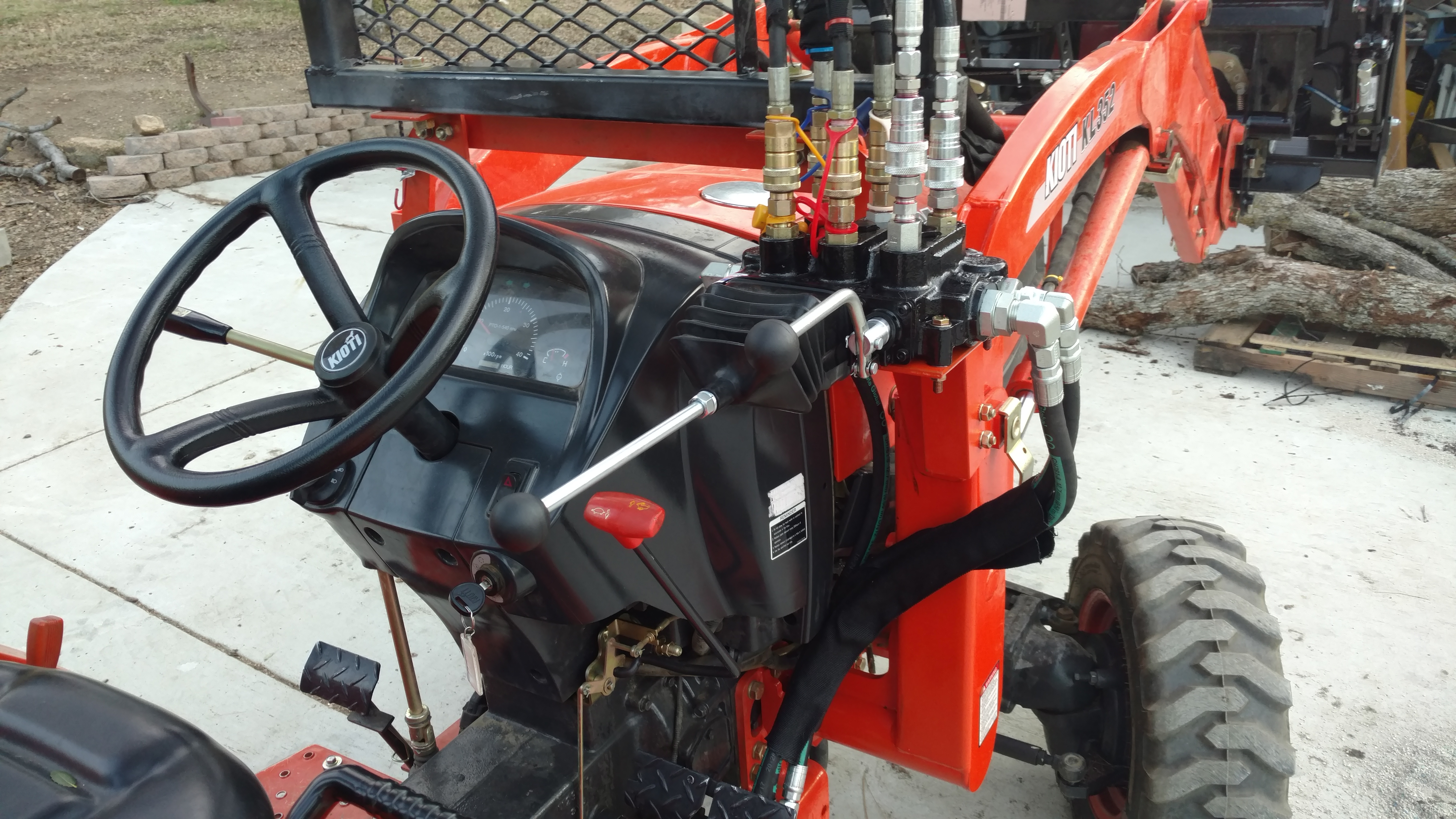

So...Other than this annoying issue...tractor runs and works great.
2013 Kioti DS3510 w/863 hrs. Float doesn't seem to work unless I hold the lever in place. This started up earlier this year but the tractor isn't used that much so not really an issue until now.
The lever will somewhat stay in the float position but it does have a little slop. That little slop is applying down pressure to the bucket so no float unless I hold the lever all the way up. It is in the detente and feels like it should be in float mode but it drops a little and hydraulics are activated. I have attached a couple of videos.
Thoughts? Thanks all!

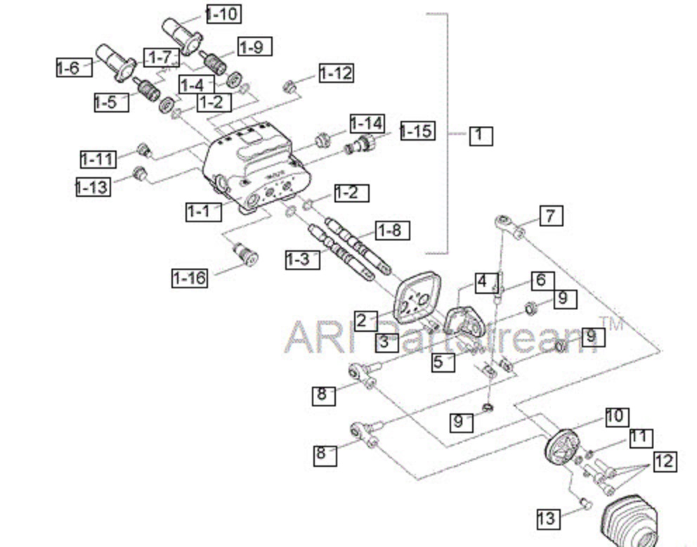

You need to remove the spool cap on the far side of the valve body from the joystick. The float spool controller will be the longer of the 2 spool caps. In the cap, there will be 3 ball bearings that engage is a slot in a spool washer. If the washer gets warn, the bearings won't lock in the groove. Often, you can spin the washer so the bearings have a fresh lip to lock in and re-assemble the spool cap. Make sure you grease the bearings and spring well before assembly. The grease will keep the 3 bearings in the holes at the end of the spool controller.

When you say spool cap, do you mean parts 1-10 and 1-6 in the diagram below?
(This isnt exactly like my valve body but the it gave me reference for another part I needed for the joystick itself.)

Yes, the spool cap is similar to 1-6 in your picture. The longer cap is the float cap. Be careful not to loose the ball bearings when you remove the cap!!

Thank you for the info!! And the diagram I posted was from your site. ;) Go figure! Looks easy enough. I should be able to do this without burning down the shop. :D I will hang a magnetic bowl under the cap so if anything drops, it will catch. I assume to expect a little fluid drain but nothing to have to refill or should i also get some extra fluid to refill?

Ok ... so I took off the cap...no bearings. No washer... I removed it slowly and nothing but the spool came out. Couldn’t see that well into the valve body but the spool looked good. Nothing seemed to be wearing abnormally... at least from my point of view. So I reassembled to spool and cap..still a very week hold for the float position. Then I thought of what you mentioned about turning the washer. So I disconnected the joystick from that one spool and turned the spool 180 degrees and reassembled. Float is working great again. So...either the bearings and washer stayed inside the body. And being very careful with it, they didn稚 move. So turning the spool gave it a less worn area for the bearings. Or...just a different spool. Either way... it is working again. Thanks for pointing me in the right direction!
