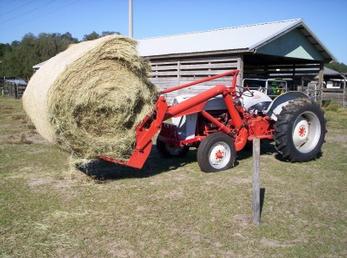

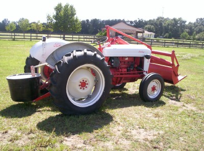

Actually.. she feels as solid as any 2-poster loader I've ever used. The bucket is mounted offset to one side a, dthe arm attachment point is offset tto the toher side. the connection under the tractor goes has 3 points and is angled to spread the load out pretty evenly.
I DID add rear concrete ballast weights to counter ballance her.. otherwise she's darn near impossible to steer with a 1000# bale on the front end.... and even then.. only when rolling..

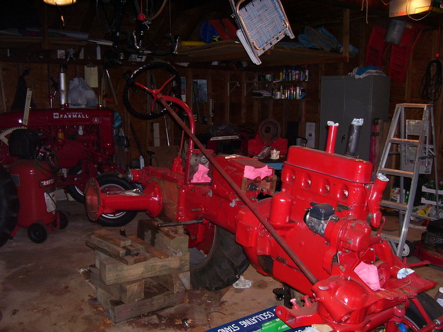

Evenin John,
Big wooden blocks are in my inventory and get used on a regular basis ! ;)

I like the look of your shop -- has that "lived in look". Good look'n restoration underway too.
You can tell a lot about a man's shop by the size of his wood (blocks that is, you guys need to get it out of the gutter....). Big projects just seem to need big hunks of wood. There was a radio talk show, Garage Logic, that was just talking about "garage wood". The precious blocks of wood that have been used for years in about every project and have the marks to show it. I know my hunks of wood are used as much as any other tool.

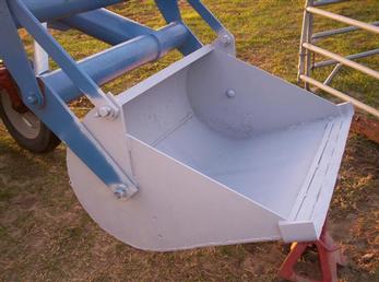

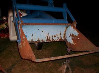

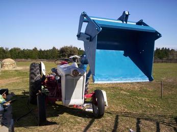

I hear ya. When i got my loader on my 55' ford 850.. the bucket wouldn't even make a good spagetti strainer it was so 'holy'. i had to cut a hug section out and reskin.
pic 1 is the cut, pic 2 is the new floor welded in, pic 3 is it in primer, and pic 4 in paint.
Soundguy
Hello Soundguy, I have never seen a FEL like you have in your pictures, could you post a side view of it. I have a Farmall A I might like to put a loader on like that one. Also on my MF35 FEL the cylinders ore relieved when the bucket is lifted high as it will go, I really don't like to leave it up in the air like that either, So I am thinking of building a hanger for it. Blackfoot

r & l sides.
Soundguy
