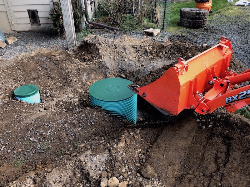

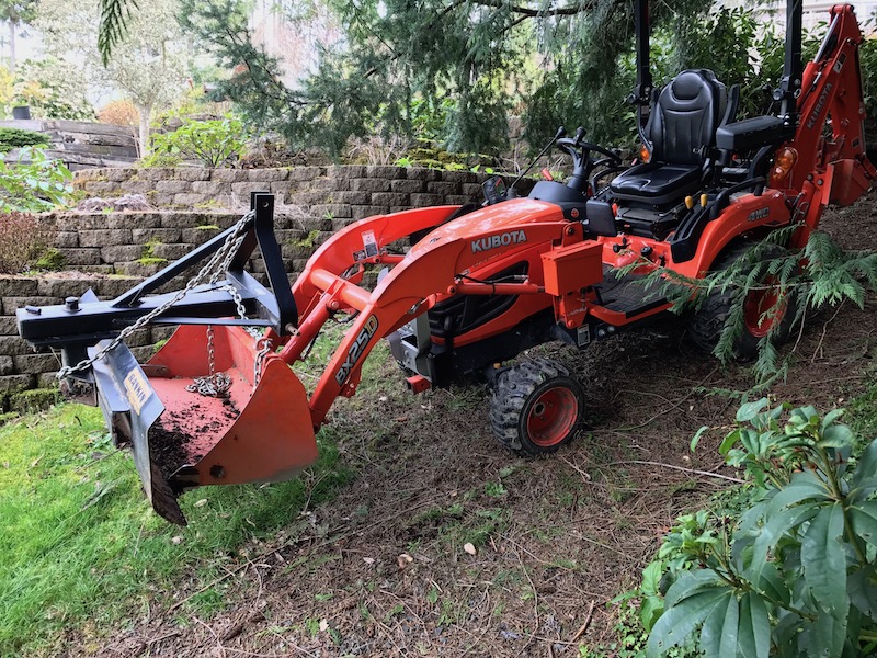

I have the BXpanded clip on hooks and they work great but expensive! Very handy because you can move them in seconds. I was looking for an abusive action shot but here is what they look like...

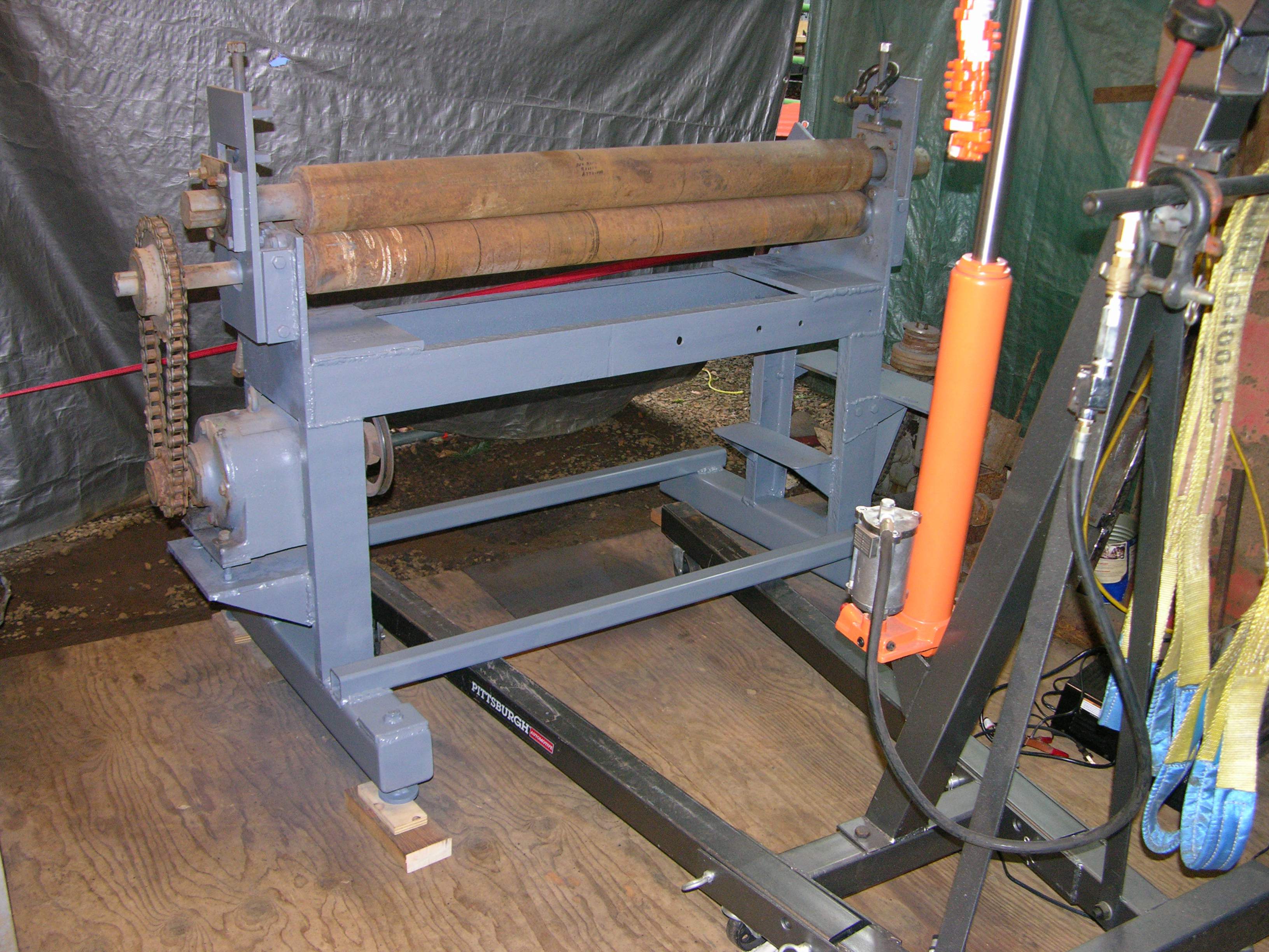

I made the mistake of thinking forks were enough ONCE, then swung (some would say drastically :laughing:) the OTHER way - the mistake caused me to replace about half the frame of a powered slip roll (pic temporarily unavailable due to computer crash) OK, found it on TBN - DSCN1243.jpg

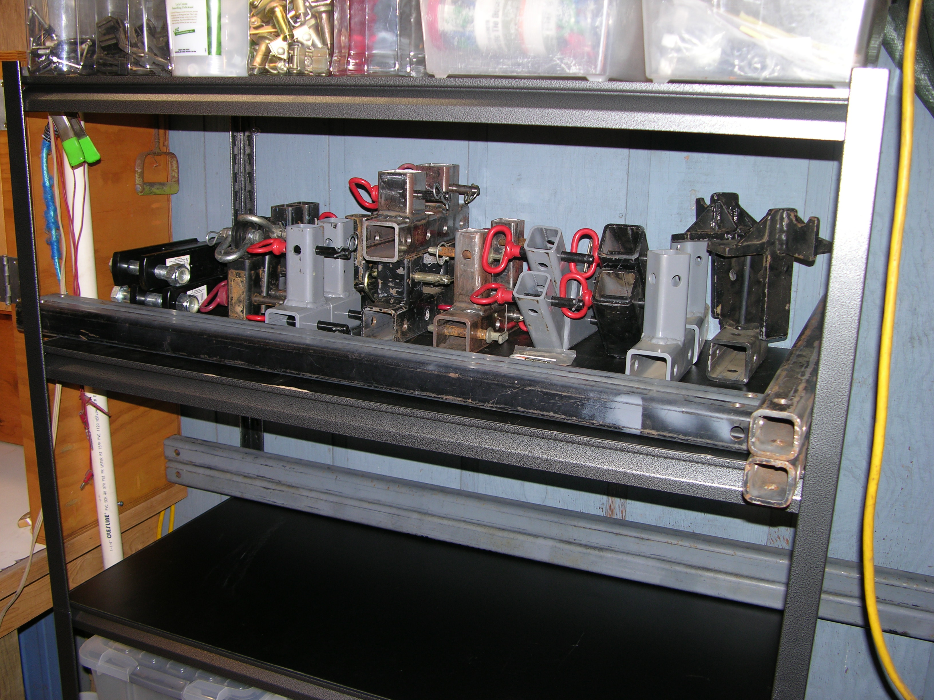

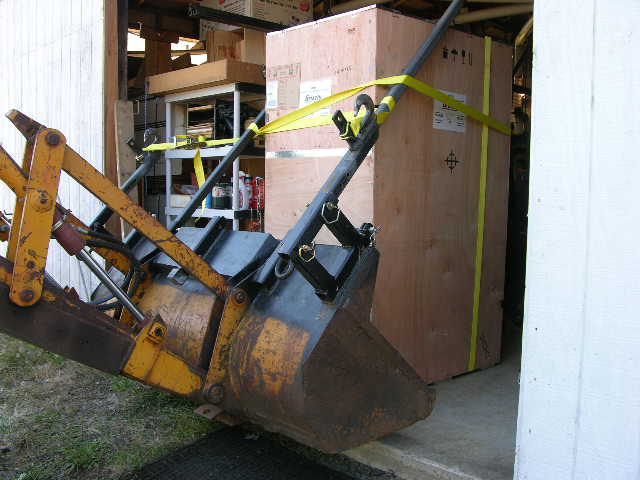

That's the boo-boo that precipitated my "tinker toy" system, so when my Grizzly mill showed up I was ready
And yeah, there really ARE SEVEN receivers welded on the bucket of my trusty 580B :rolleyes: - might seem a bit much, but at one time or other I've USED 'EM ALL, in conjunction with these
In all fairness, my approach probably isn't for the majority here with compact tractors; my Case isn't very "compact" :D but it WILL lift one end of an empty 40' container that weighs just under 10,000 lbs, BTDT. (No, it won't lift 10,000 lbs - divide by 2 :rolleyes: ) It's also moved entire fallen trees, small cars, 800+ pound loads of 20' long steel, etc -
