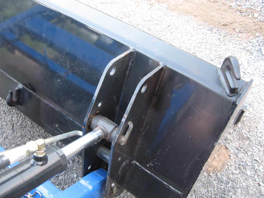

Some time back I posted about adding hooks to the bucket of my B7610 loader. I did and thought I would show a picture of one of the hooks. The paint on the hook is scratched up a bit due to use.
I reinforced the lip of the bucket at the location of the hooks and then used a section of angle iron to mount the hook with some plate added to the bucket itself to spread the load over a larger area.
So far, so good.
Dave

/ Bucket Hooks #15
So far, so good.
Dave
Happy :) to see that you aren't one of those touch-up paint guys.:rolleyes:
/ Bucket Hooks #17
Thanks for the kind comments.
So far, the installation is proving quite strong. Hooks on a loader bucket are very useful, as most already know. ;)
