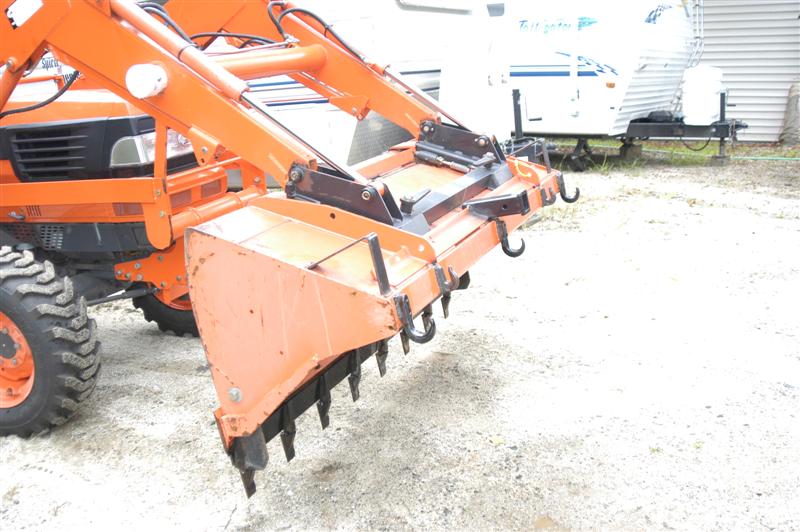

Here's a few pics of my bucket hooks with angle reinforcment. They work well. I used a Lincoln Mig.

Grind the paint off, you will have a much better weld. This is a couple pics of my install on two tractors.

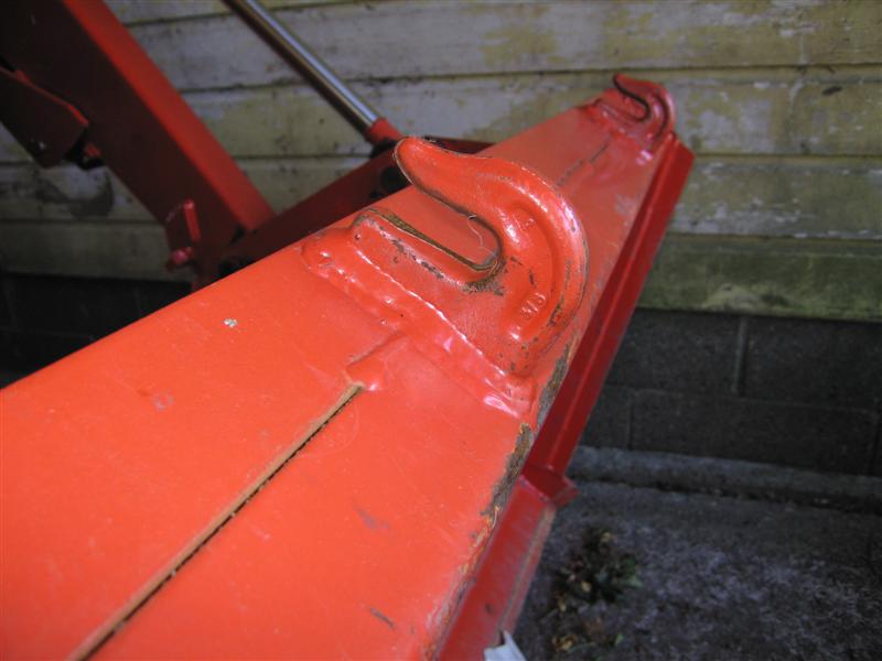

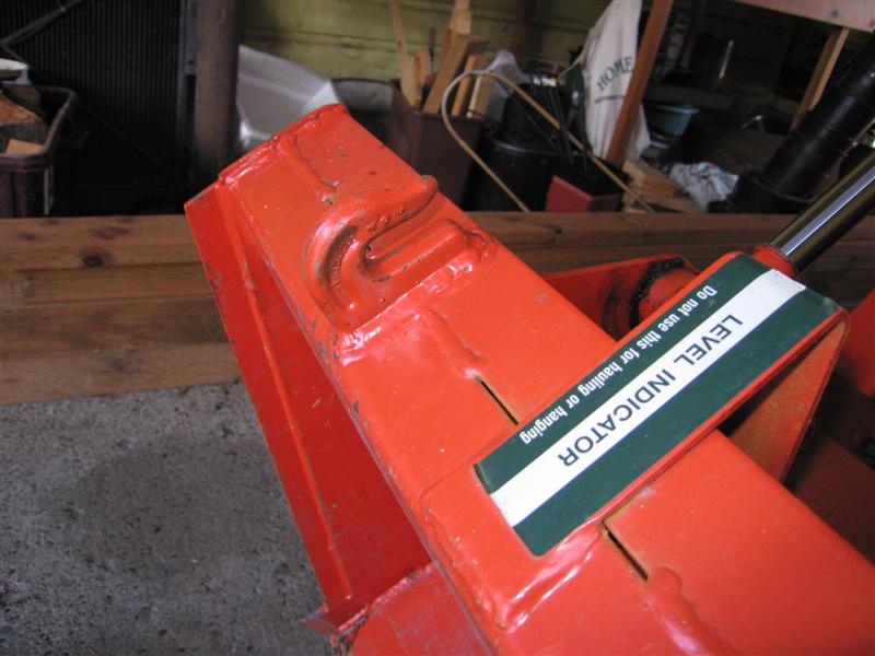

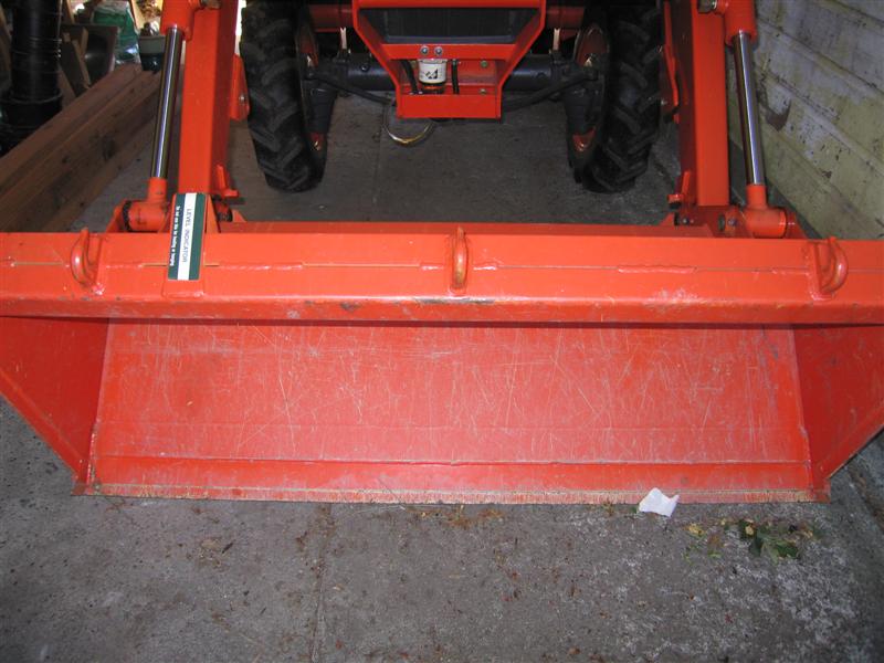

/ Bucket Hooks Revisited (Again!) #9
These are mine. Dealer installed them before I bought the tractor. They did a nice job and they are very handy.

Nice looking set-up, Shimon.
And I don't think you have to worry about it not being stout enough either!!

Kinda' surprising to hear of dealers installing hook on FEL buckets since the pamphlet owner's manual specifically says 'do not install hooks on there.
I'm just sayin'......

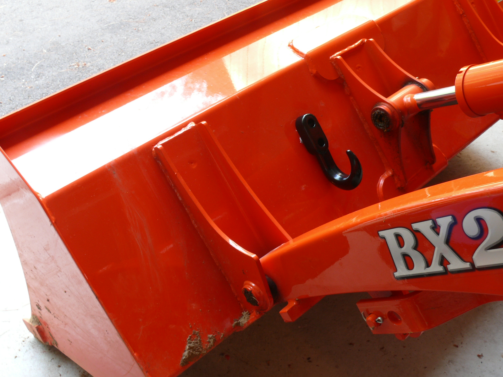

I got a hook for my BX 24, but the lip along the top edge is too tall for the hook to clear. I'd need to block it up with about 3/4" before it would clear the top edge. Note picture.
Would there be any problem using the back surface of the bucket to mount the hook? I'm going to be using the hook to lift small logs off the soil so I can chainsaw them to fireplace size. Note picture.

Jabroni,
I would recommend welding some type of reinforcement onto the bucket. I wouldn't over do it, but I would beef the bucket up some in the area of increased stress from the hook. i did.
I know that lifting "small logs" just off the ground to saw into fireplace size most likely would not over stress the bucket even without any reinforcement. In actuality, I can almost assure that you will use those hooks for more than that at some point (cause they are so convenient and useful!!) and that is precisely when you will run into problems without some reasonable reinforcement. If your willpower is greater than mine ;) then maybe you will be OK just welding it to the bucket as in your picture. I know I wouldn't trust myself to limit just lifting "small logs" :).
Again, I wouldn't overdue any reinforcement since you have to account that there is a limit to the max stress the BX could induce on the hooks/buckets. I would use some reinforcement though. Your call.
