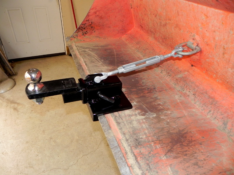

I started with a single grab hook welded in the center of the bucket on top. This worked great and as time went by I kept testing it. Well, I started clearing a lot with some good size oaks and in using the tractor as a skidder I bent the top of my bucket down about 3/8"; I had found it's limit. So I straightened the top (no easy chore) and then welded a d-ring inside the bucket to use for pulling. I have maxed that baby out a number of times. So I am a proponent of having both and having them welded. The d-ring is welded where the bucket has a support piece on the back.
Later, I wanted an easy on and off trailer hitch and found that d-ring to be very useful in that regard. The hitch is on or off in less than 30 seconds and does not move sideways at all.

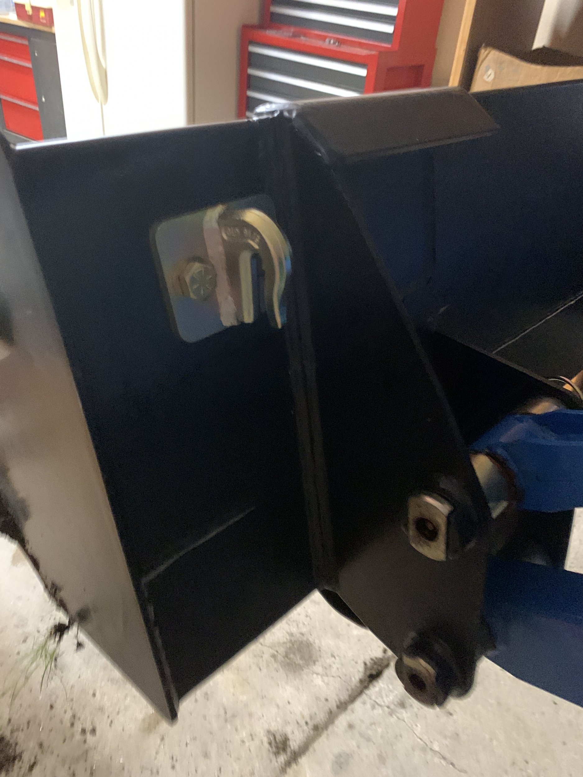

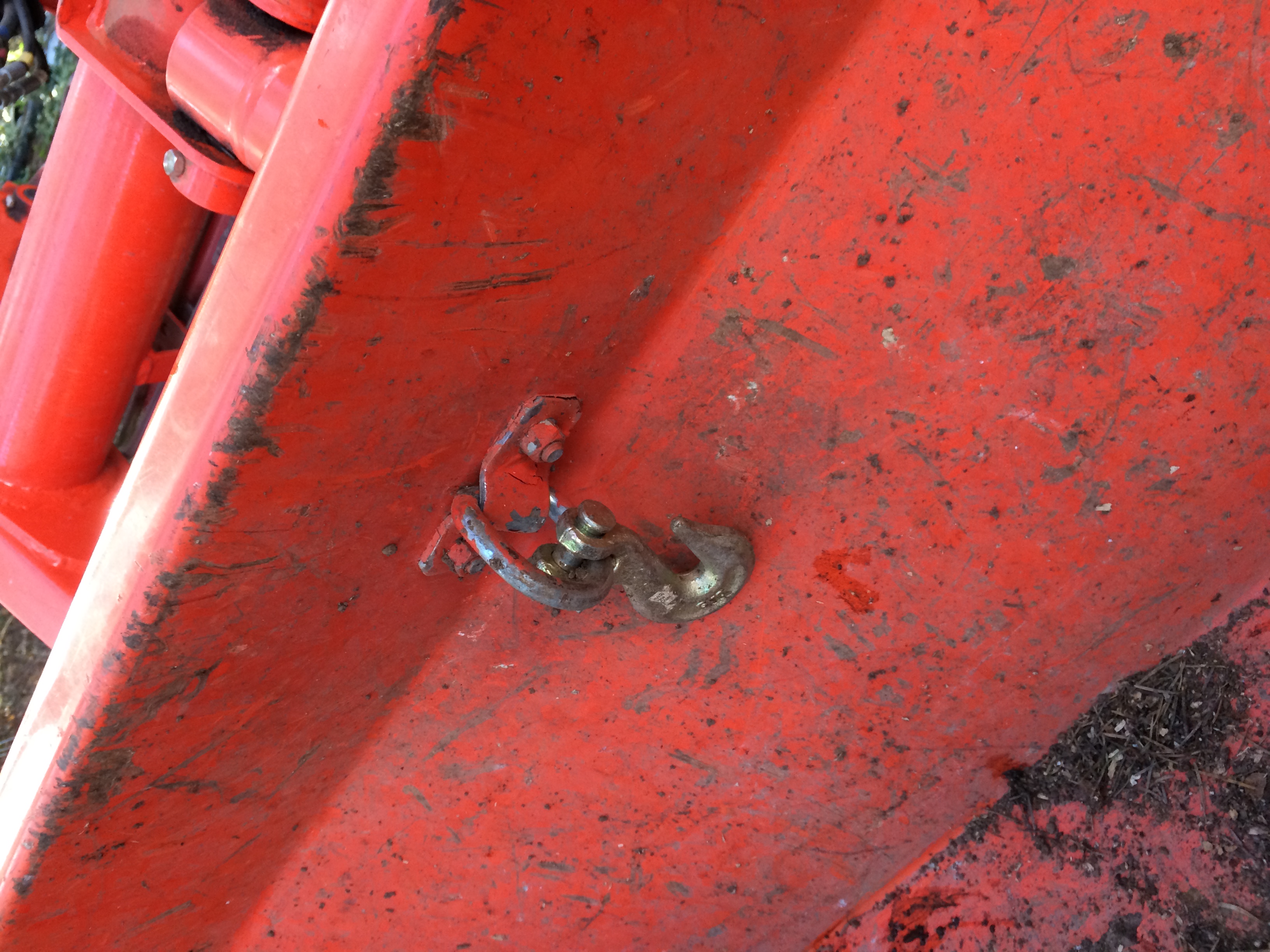

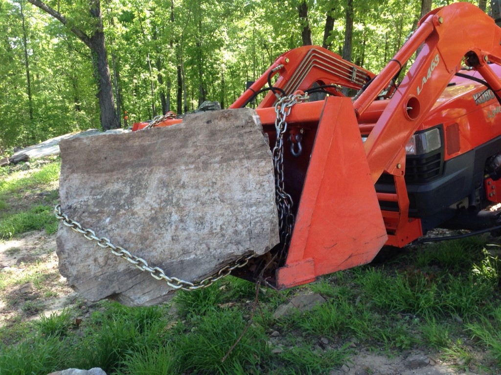

Bolted through the cylinder mount reinforcement. And I have a large turnbuckle I use with a receiver on the edge, too. It is used mostly with a short boom pole, so it attaches to a chain near the tip of the pole.

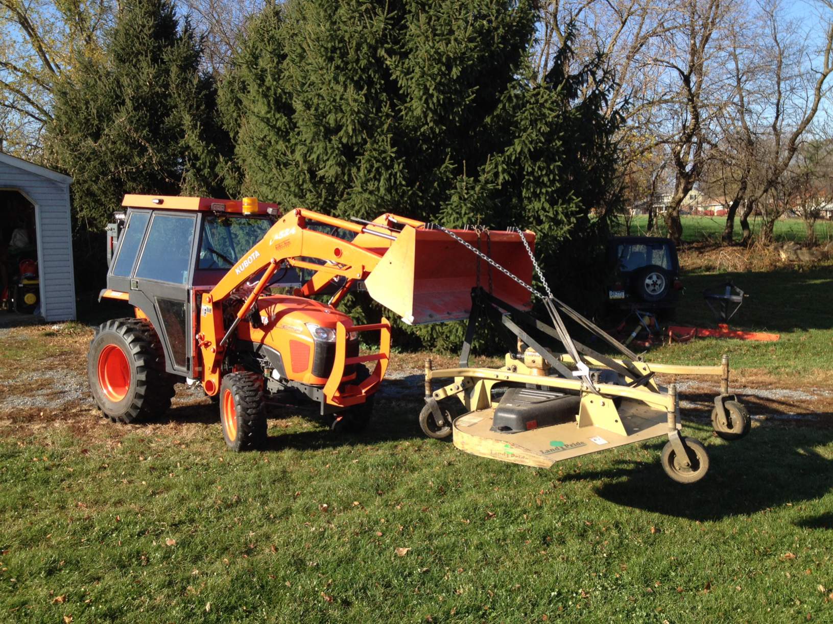

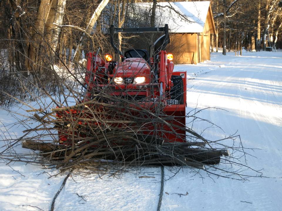

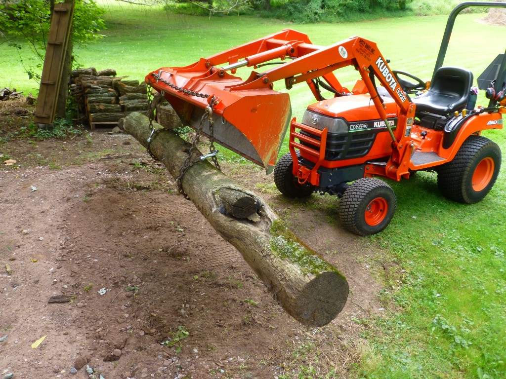

I've seen a good number of threads regarding bucket hooks but I rarely have seen any pic's of them in use. Are they only for lifting or can you lay a log in front of the bucket and wrap short chains in some rapid convenient fashion? I've just been going around the whole bucket.
I've dragged logs with mine several times. With some of the hills on my place I'd rather back up than try to drive up forward and drag a log behind. It's nice to be able to use the FEL to lift the end of the log too. Just lift the log, put a choker chain around it then hook the choker in the hook and drag away. Also chained big awkward stumps to keep them in the bucket while hauling.

I tighten that turnbuckle (2200# work load) with my hands; no tool is needed.

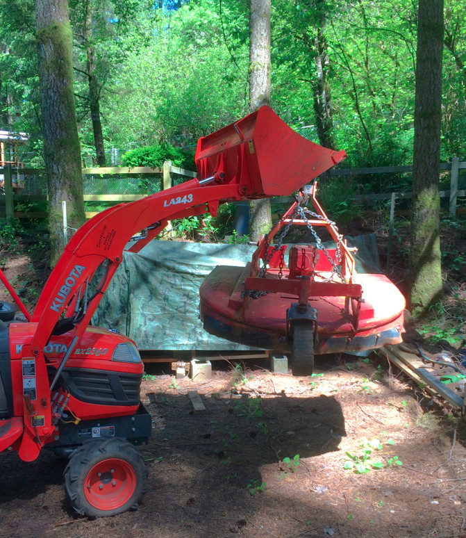

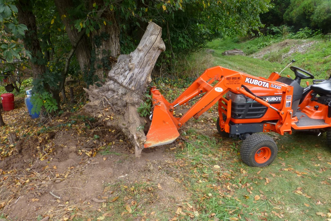

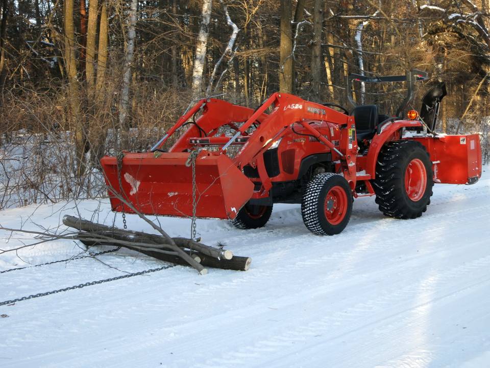

You can also use it to an extent to pull small trees out of the ground by running the chain around the small tree several turns leaving each end with enough slack to reach both of your bucket hooks. Curl and lift your bucket as the chains tighten up on the trunk. If your tractor is able, the tree will pop out of the ground.
Exactly. You can do the same thing if you need to remove a fence. Drape the chain over the T-post, curl and lift. You can do a whole bunch without getting out of your seat.

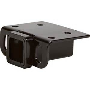

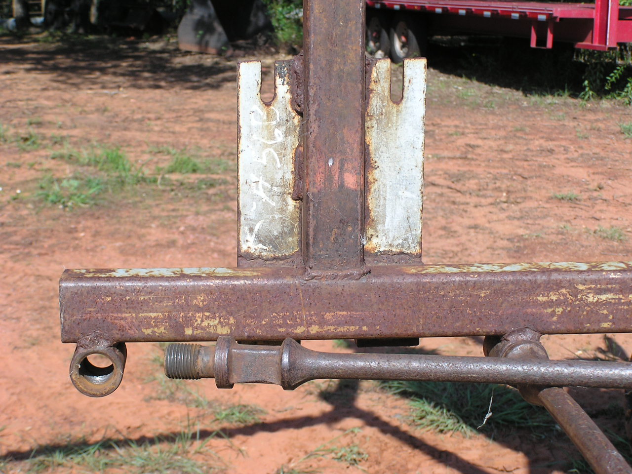

IMG_0737.JPGIMG_0738.JPG I have two hooks welded on inline with cylinders and added trailer receiver hitch in center of bucket. It is the red part in the center usually I have my gooseneck ball and 10,000 lb hook for lifting in the hitch but I have several different things that will fit. Tri-ball d-ring ect.

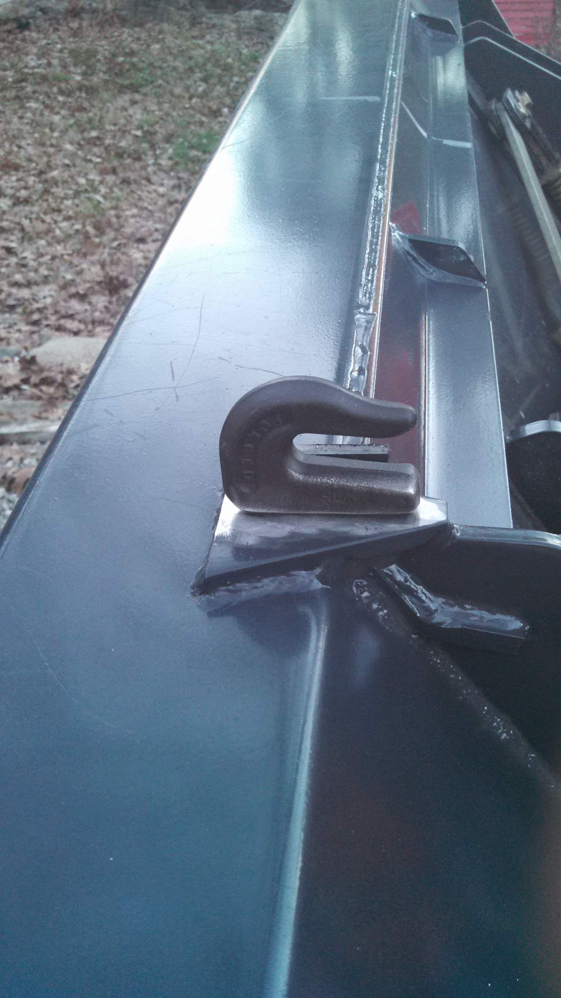

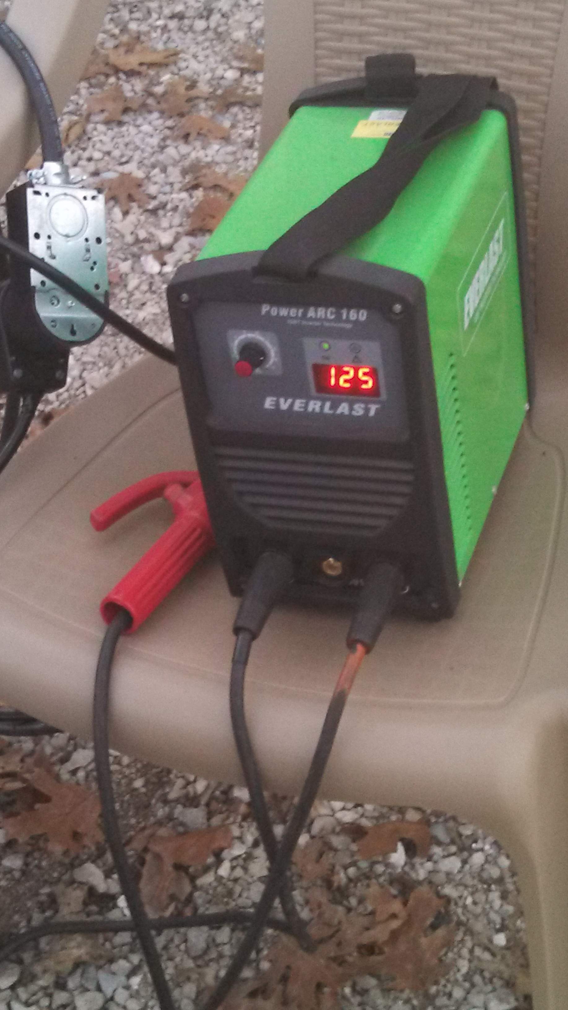

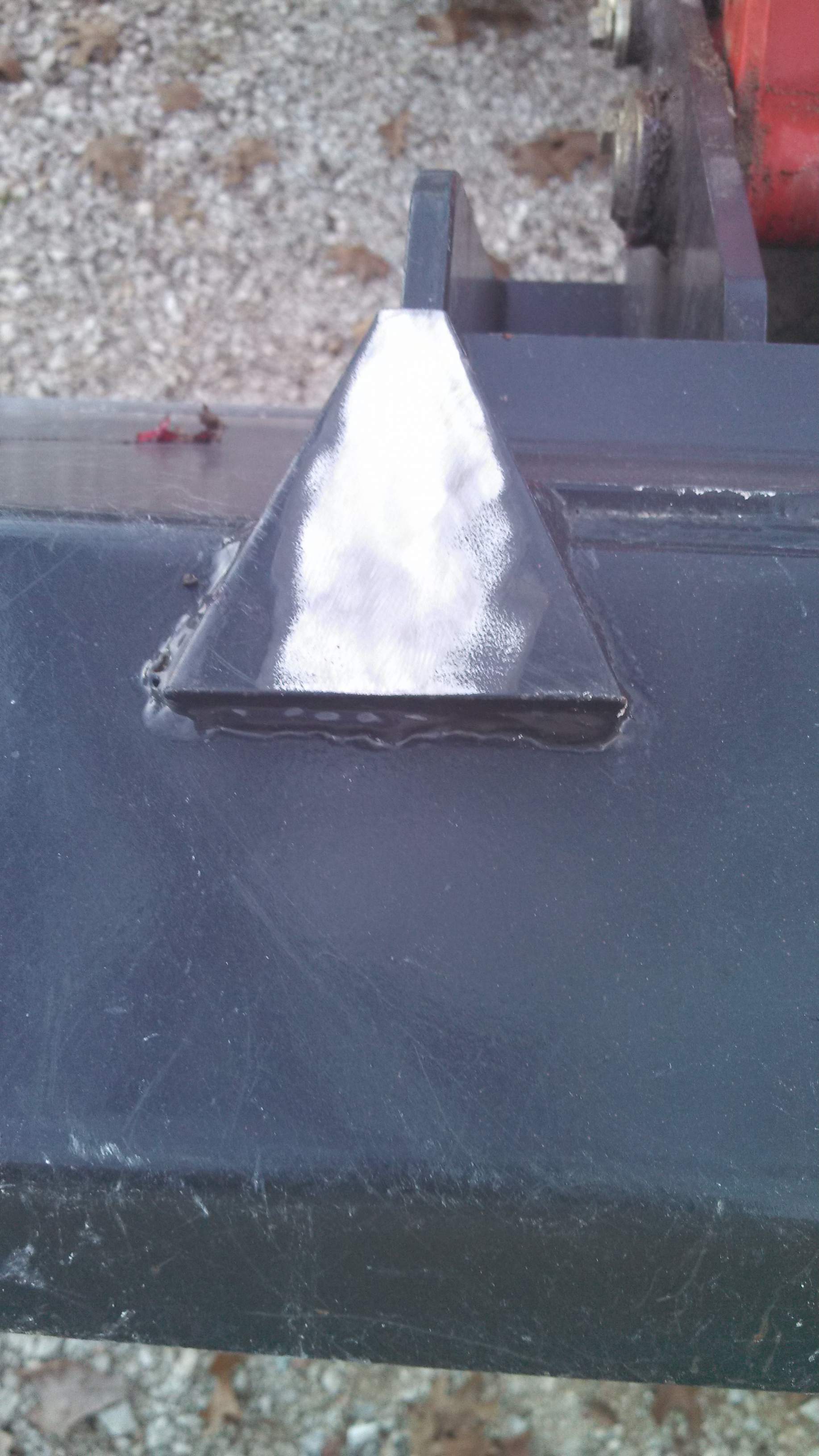

Thank you.. I am relatively proud of that 7018 weld at 125 amps with my little Everlast PA160. It must have caught the eye of others as well, because a "professional" welder in Florida stole the photo and put it on his website as an example of his work. That "pissed" me off considerably and I sent his some electronic hatemail to which he basically told me where I could go. It was brought to my attention by another member no longer active, and he gave him a piece of his mind too, but the "pro" did not really care. If you look carefully you can see the little brick retaining wall by my house where a lot of my photos are taken, as that is where I work on my tractor. In my opinion my weld with the stick is a better weld than the Korean fella did with the MIG on the plate on top of the bucket. Here is a photo of the welder that made it.

James, although I'll concede that there are differences in the various brands of welders and Everlast is well known for excellent quality,,,, the quality of your hook welds is much more due to the person holding the welder stick than the machine sitting nearby. :cool:
I will agree with that. There is a guy here that has cr@p equipment and can turn out stack-'o-dime welds so good they bring a tear to your eye. (y)
On the other hand, I have great equipment but my welds bring a chuckle to the crowd. ;)

Wow, is that a beautiful looking and functional weld.
Well, a good 7018 rod and a DC welder set at about 125 amps is hard to beat.

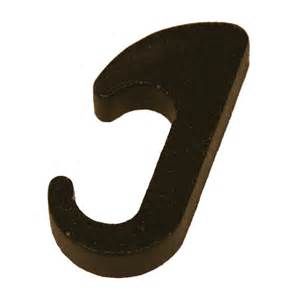

If you're gonna do bolt-on, like Kenny's, might as well get the clevis mounts to be the backing plate. Gives you more options at minimal cost, so why not?

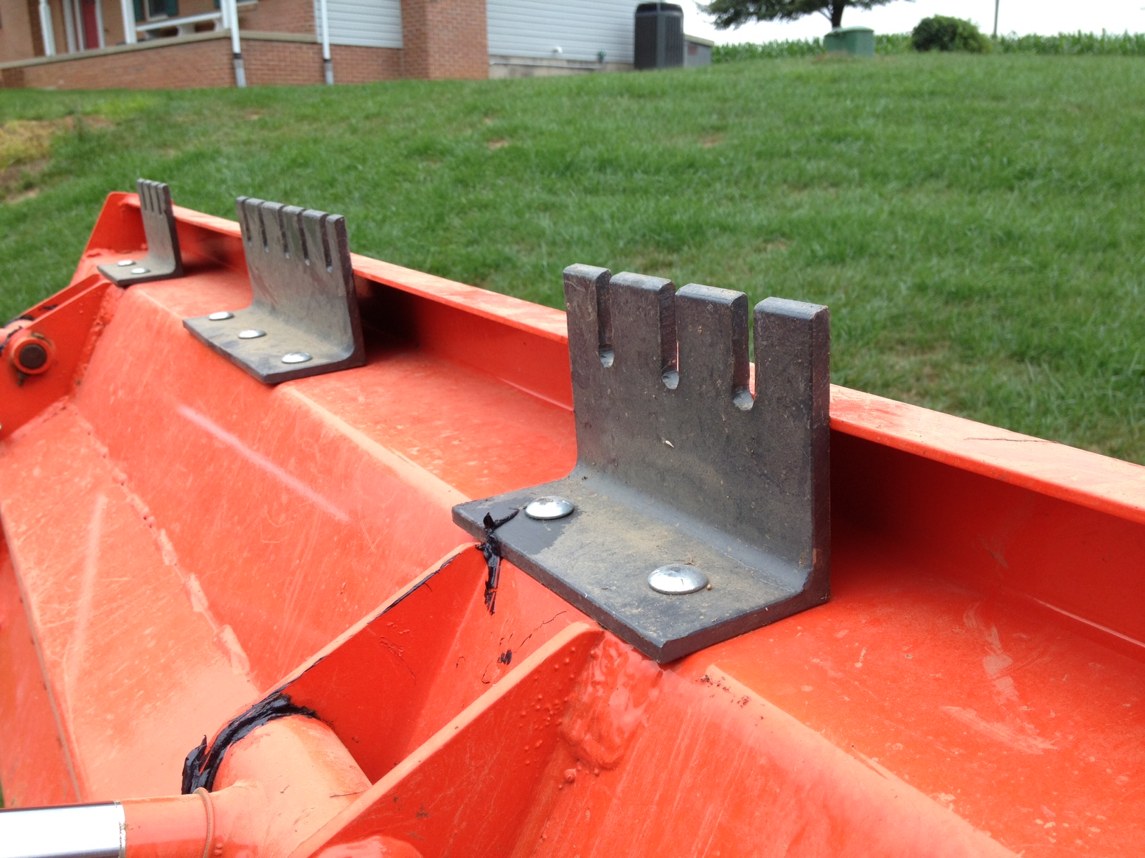

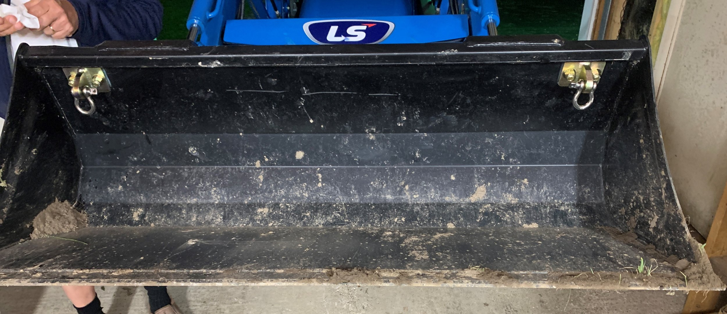

I measured the top of the RK37 bucket and I think it is only 2 inches wide and 1/8 inch thick. There is a 2 inch wide, 1/4 inch thick bar as backing but it is a couple inches below the top. The bucket top bends to a 2.5 inch flat section and then curls again inside for a short distance, basically an open tube.
I see that most of the bolt on 5/16" hook bases are 3.25 inches wide.
Any suggestions for mounting bold on hooks besides on the sides of the bucket?
/ Bucket Hooks? Or clevis mounts instead? #58

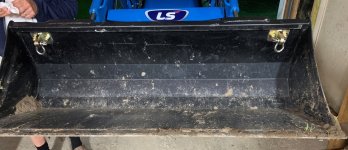

Our hooks are only 2-5/8" deep, all the "copies" are deeper. Some guys mount them on the back wall like this:
