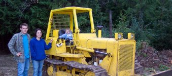

Hey now you and I have a lot in common. I actually have a hard time paying extra for the cans of MGD since the bottles are cheaper but the bottles are more of a pain if they break or bounce off the fender. I have strategically placed empty cans on branches and inside cutout tree trunks on my rural property. Like an easter egg hunt.
Another strange coincidence that we have in common is the dozer thing. I too owned a small old dozer before moving to a new Kioti. Weird.
Tractorlegend modified the Kioti brushguard and did a dang good job of it along with extra effort for a nice paint job. I ended up buying a Kioti guard after it was proven necessary doing loader work around trees and stumps. It really should be part of the loader package. It isn't that expensive to buy and gives a great base to start adding extras. The hood swings forward and up so any fabbed brushguard will need to stick forward a long ways.

Thanks for that info, I'll find TractorLegend's pics of his brushguard and lookit the Kioti's for sale too, like ya' say it's needed in the brush just like for the dozers. The tracks did our heavy work, now the wheels will keep it clear and clean. The woods is always trying to take it back :~)
That's a fine future tractor driver sitting in your dozer :)
Return pic, three generations of us, the youngun eventually got to pushing some dirt around.
