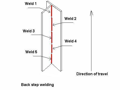

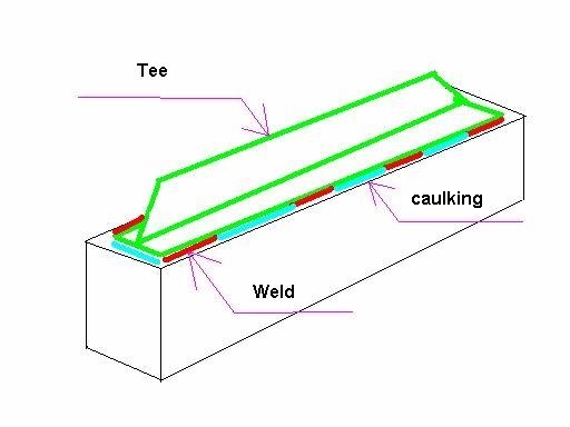

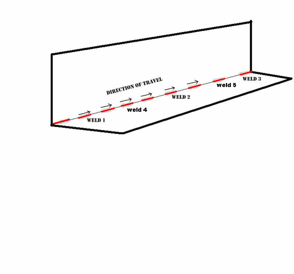

Skip welds really help control distortion. Especially if you back step the welds too. Back stepping, and skipping around a lot breaks up the heat line, so a lot less chance of distortion. A lot of things I skip weld, I will use caulking between the welds before painting.
Good stuff Shield Arc. I sometimes get in a hurry and forget to jump around and end up with distortion. Especially when using a MIG. I've learned a lot listening to you over the years. I just gotta work on the "application" part. :)

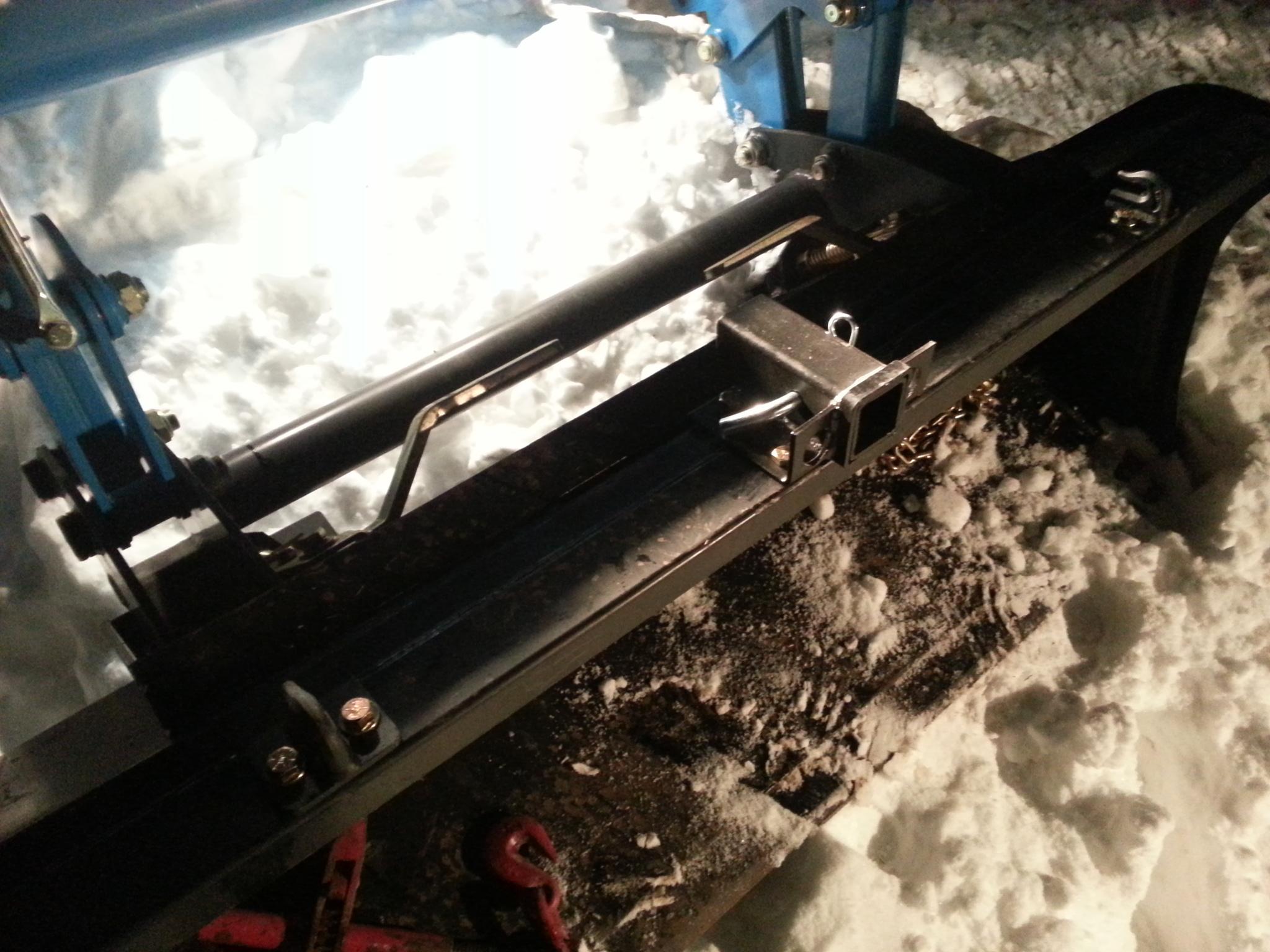

I did *almost* like you, with a 2" receiver hitch in the middle. The receiver will hold a hook:
Receiver Tow Hook
or a drop down 2" receiver extension that I made to get a tow ball down lower and ahead of the bucket. That, and a video cam looking down at the ball, makes picking up and moving trailers around convenient.
I also mounted two 5/16 weld on chain hooks on each side in line with the lift arms. Two isn't necessary, I guess, but there are times when it's nice to have an extra hook to loop slack into etc.
