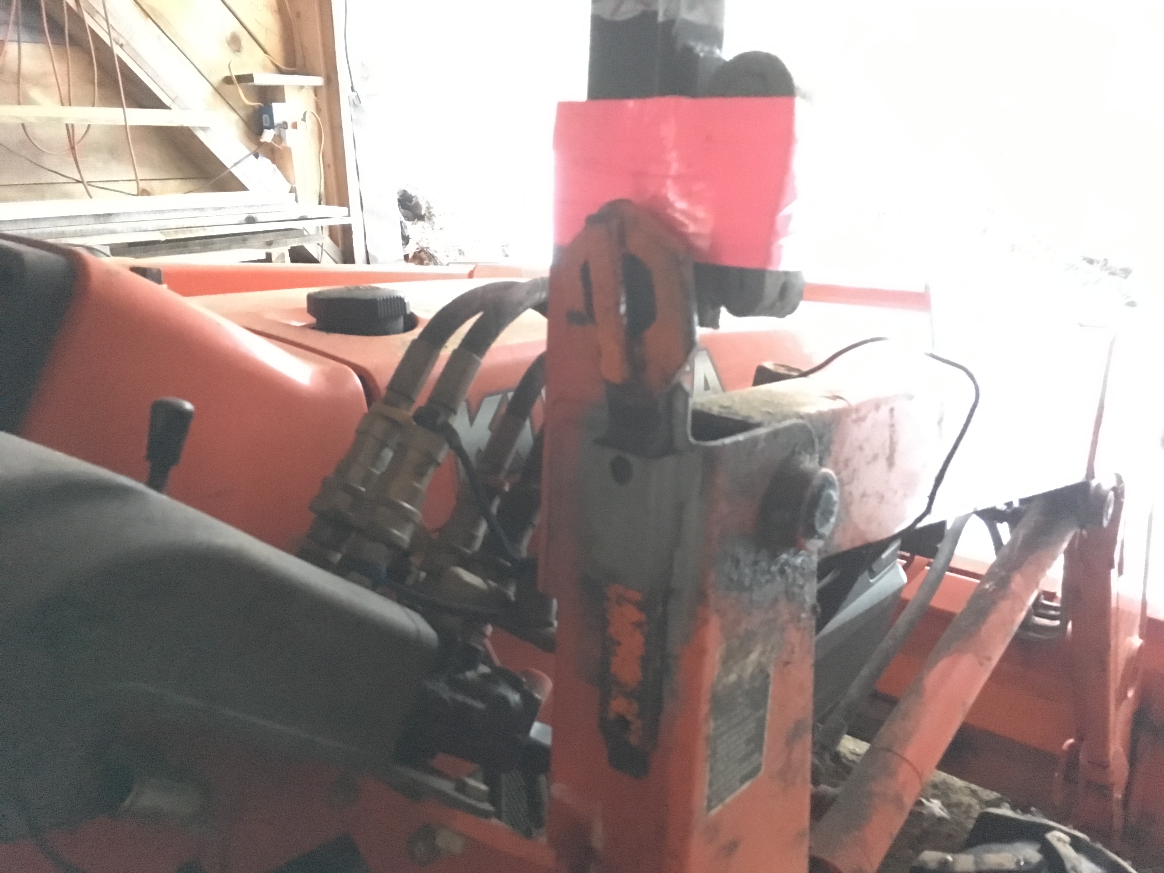

I wonder if the end of the bolt/washer is not square with the bolt thread, such that the washer's low side hits first and walks sideways as the bolt is further tightened? Easiest remedy would be remove washer for good, grind a shallow cone on the bolt end, leaving a blunt point CENTERED on the bolt's end face, similar to a set screw.
If you had access to a lathe, you could turn that point, or drill and press-fit a protruding, hardened ball bearing on the bolt's centerline that would contact first.

Forget swivel pads, sharpen the ends to a dull point and you'll have better results.
You get much more pressure on a small surface than a large (pad) one.
FYI, I doubt that a dull sharpened head will cause any problems to your FEL bucket.
LOL, the bucket will outlive the clamp on bolts.

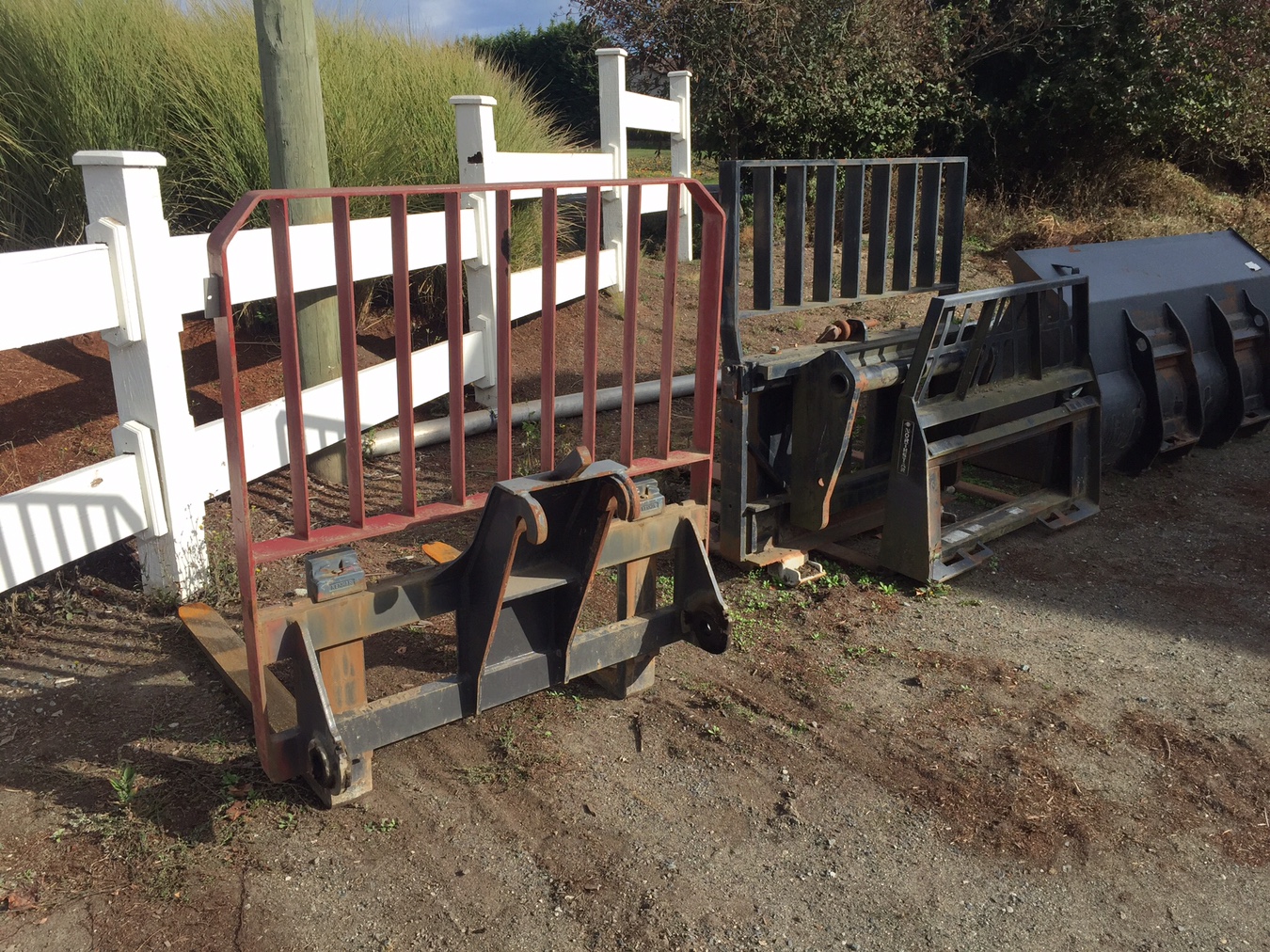

I just found a pic of my shop built two pallet setup with Q/A. I bought a single set, an extra pair of forks, extended each side of the frame and built a backrest.
I realize clamp on forks are handy and have their place but personally I view the as being akin to a strap-on d**k.
Never been much of a fan of “make do” devices.....
