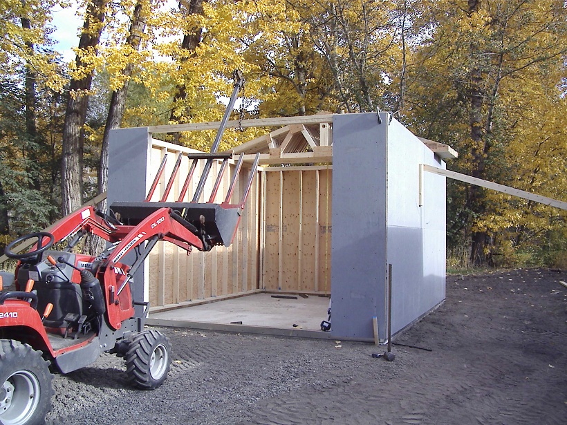

it looks like the problem there is that you focus the load on the bucket, rather than distributing it for maximum effect. obviously, you would have much more strength with those two forks at the outside edge of the bucket. if you want to lift heavy loads from the center area, you need a way of distributing the load.
the good news is that it can certainly be done.

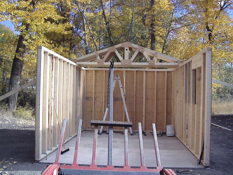

rjmack,thanks for posting that picture. I am building a 16x20x10 shed and was planning on using my FEL with a boom pole to set my trusses. Looking at your picture I am now thinking of, partially, building the corners of the 4th wall and leaving the center open for truss installation. I am working alone on this shed so I have to think a lot on solo working.

I am starting to think this is the way to go. Since I already have the bottom part of the forks built, could I weld some more 4" channel at a 90 deg. angle for the uprights? Then I would just have to build the quick attach frame. Just trying to make use of what I've already done.
it does sound like making use of oem style quick connects makes the most sense.:thumbsup:

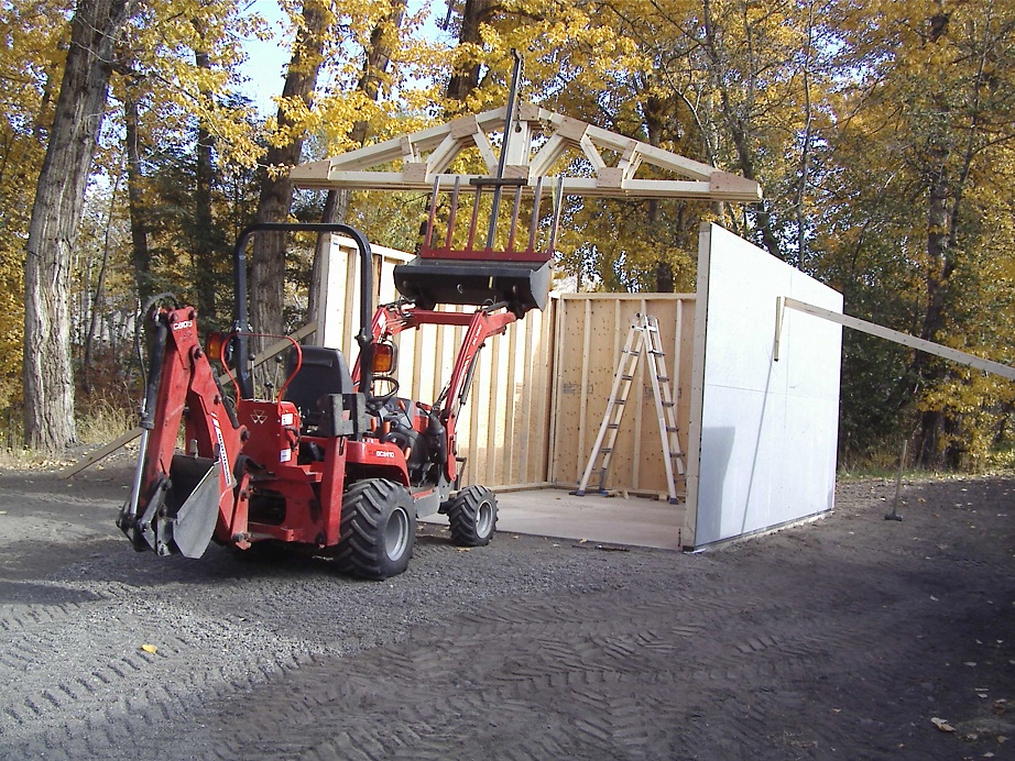

happy to help.
i put the 3 walls up and bolted them together, lightly braced the sidewalls as there was no wind, set the trusses at the back, set the 4th wall as one piece, and then walked the trussed out by hand.
i also threw in a pic of the gable solution. managed to build this, just me and my tractor.
Great idea, building the ladder for your overhang first, and then enclosing the end while everything is on the ground.
Much easier to access and no climbing around a dozen times like you would if you had set the gable end in place and then had to build your eave.

Thanks for the rest of the pictures and added info. I was thinking of doing something similar on the end trusses.
