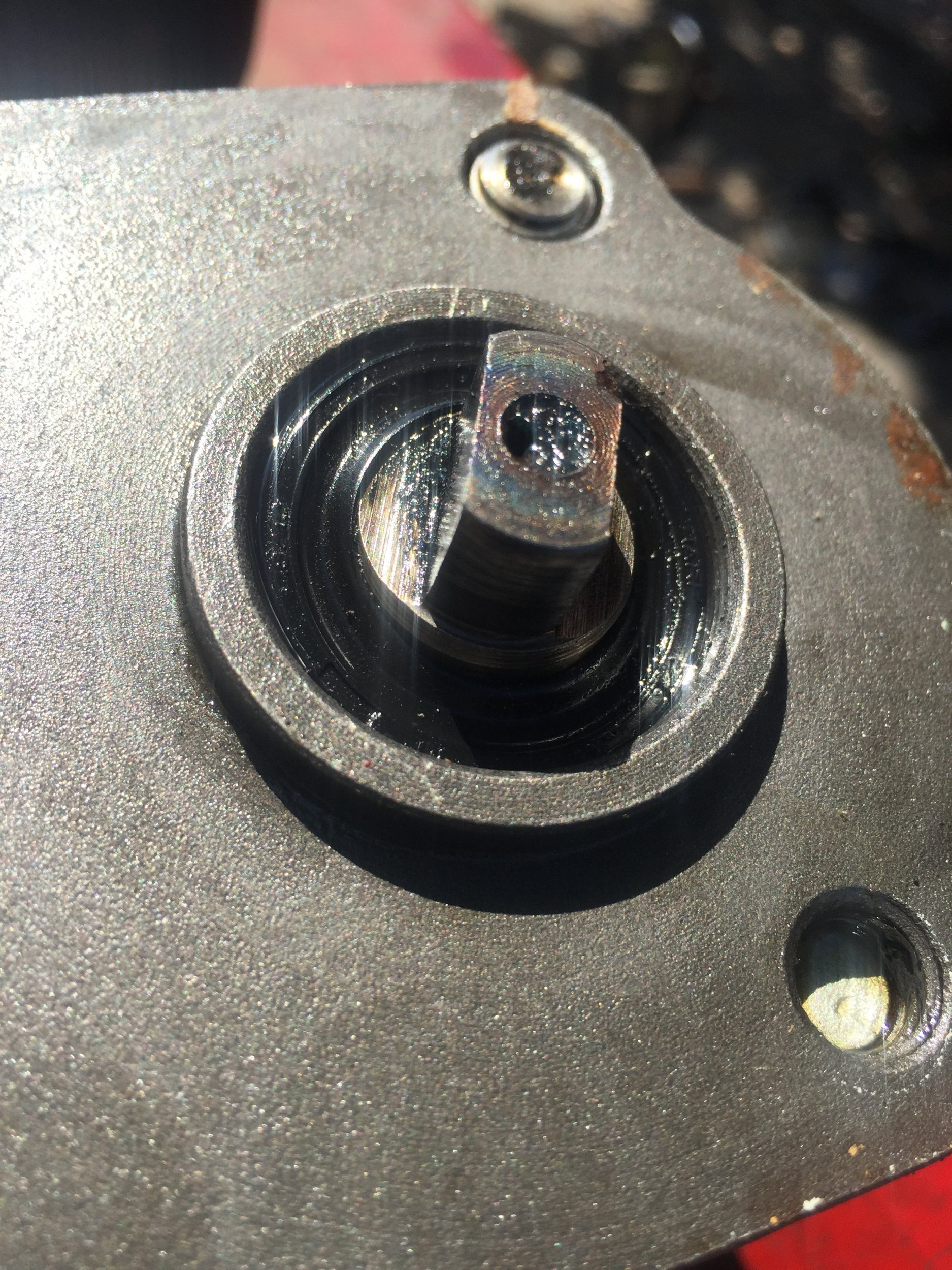

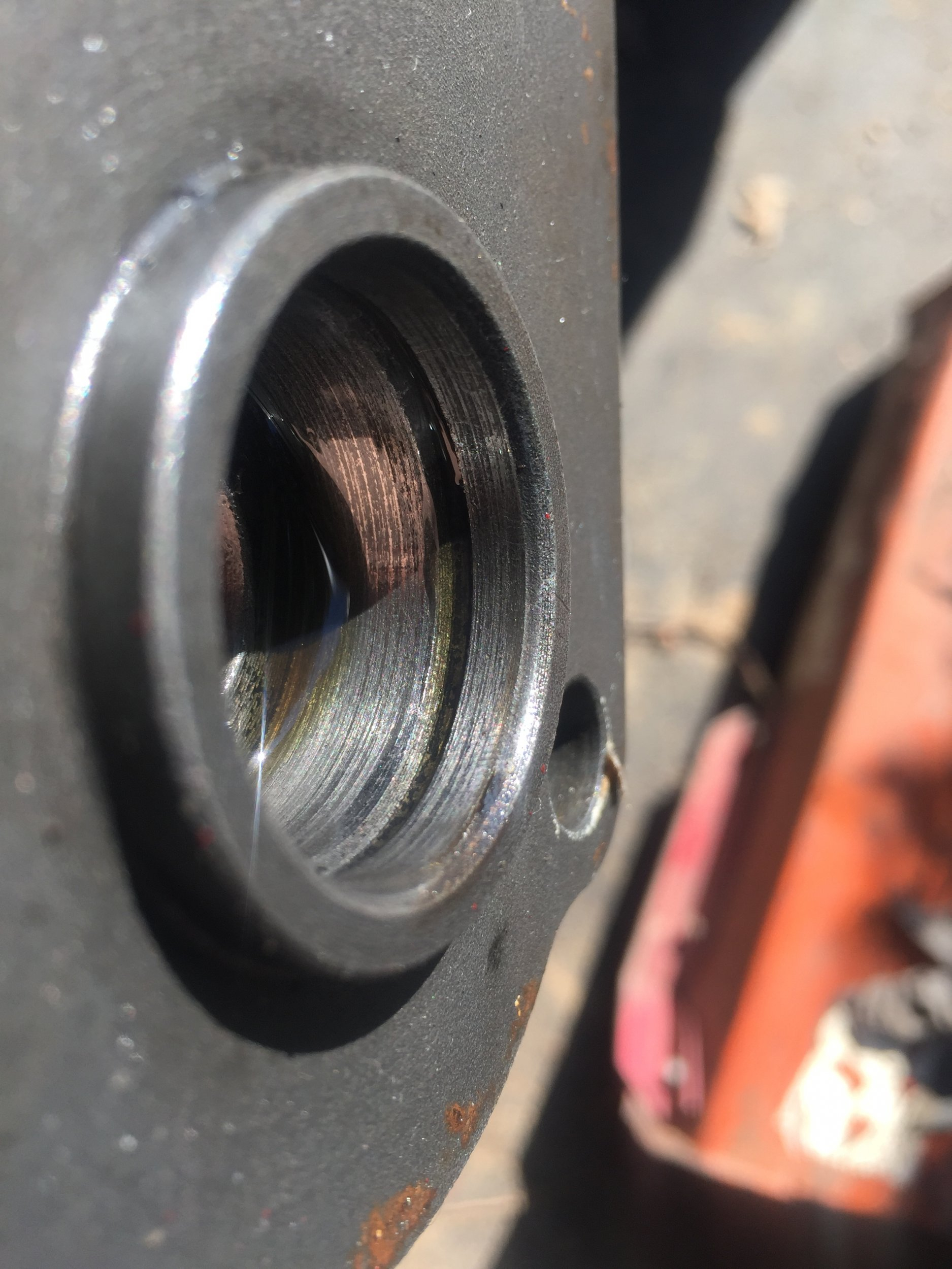

FOUND IT!!
Well.... what in the hell goes in front of the seal to keep it in place if it’s possible to push out?
Why did it push out?
Why is it sucking air instead of pushing fluid out into the crank case?
Sucking air but blowing the seal out!
Hmmmm
There is a groove but it doesn’t look like a C clip groove
   / Bubbles in hydraulic reservoir. #9
Looks like it's missing the circlip to keep the seal in place.
On a gear pump, the inlet side of the pump provides lubrication oil for the bushings and shafts of the pump through some grooves machined on a couple different places. Therefore, being that the pump is creating suction to pull fluid from that side and with the seal out of place like that, it will pull air from the outside.
I would say the seal is good and it's just crooked on the bore, however, since you're at it, might as well just change the seal, put a circlip on and be done with it. It's cheap insurance.

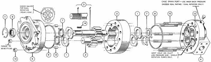

While this doesn't depict your pump, it does show that some pumps do use a circlip. I wouldn't hesitate to install one. Your pump may be unique because of the end cap ports, but all the ones I've had experience with (including myself) have always blown on the pressure side and filled the crankcase with hydraulic oil, usually from deadheading.
