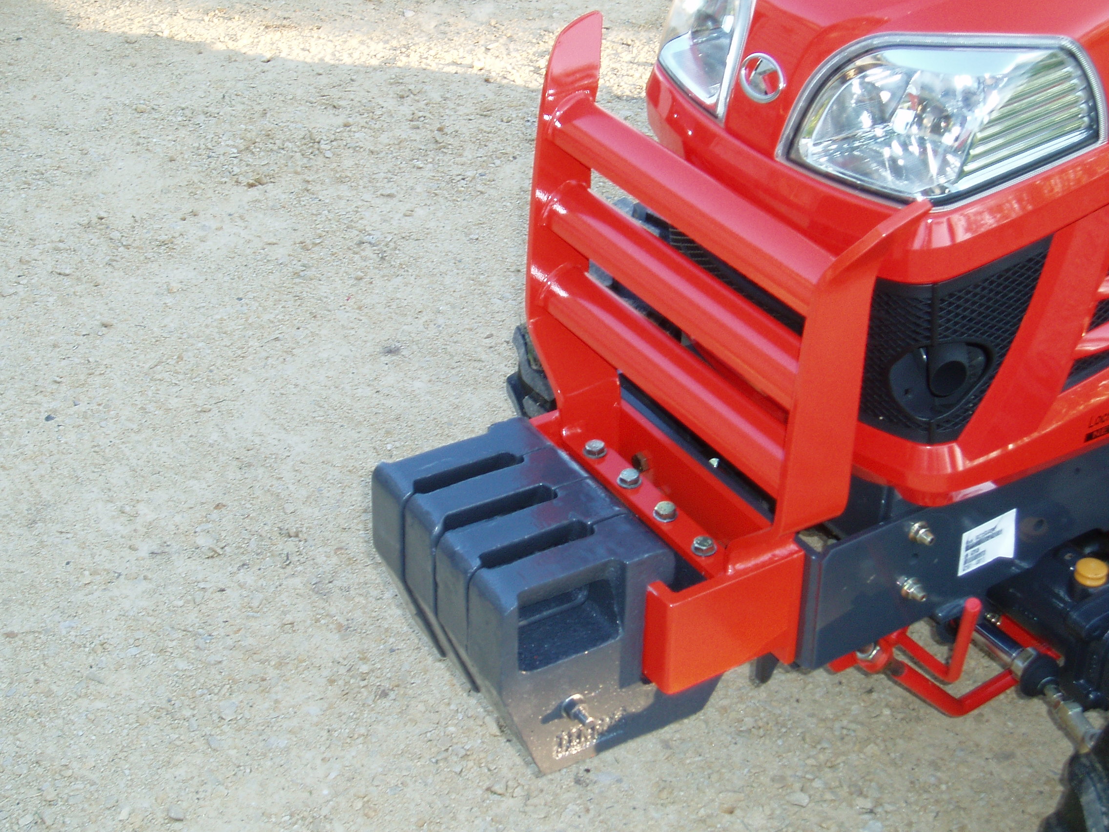

I have Befco Tornado (Model RSD-148) standard CAT1 for the BX2350. No complaints, price was reasonable, and fit and finish was good. Front ballast is a must.
