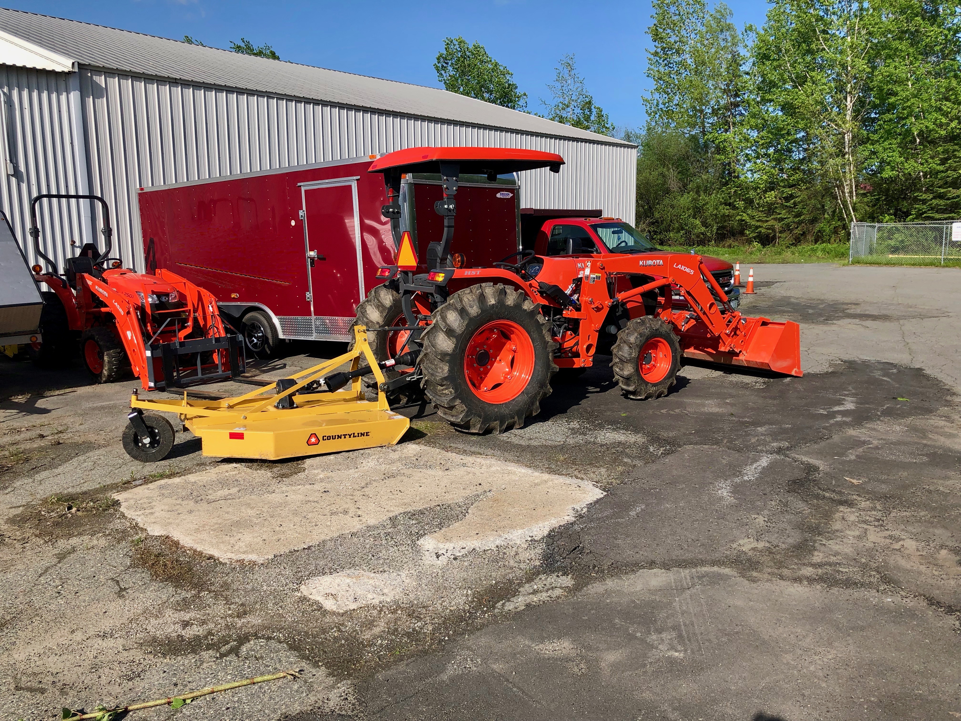

Here's a photo of mine, assembled and attached to a mine. I made a couple of passes through some 4-foot tall brush which it effortlessly cut. That's a good point about the square, non-reinforced rear end. If you back into something, you could bend the housing enough to cause the blades to make contact. I think some easy welding could solve this problem though. This thing is pretty smooth to start up and it is so smooth operating that at first I thought engaging the PTO broke the shear bolt...but it actually is just really smooth.
