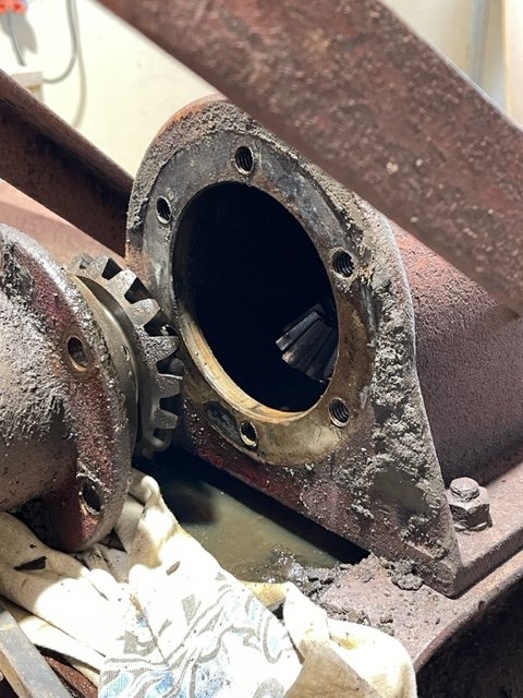

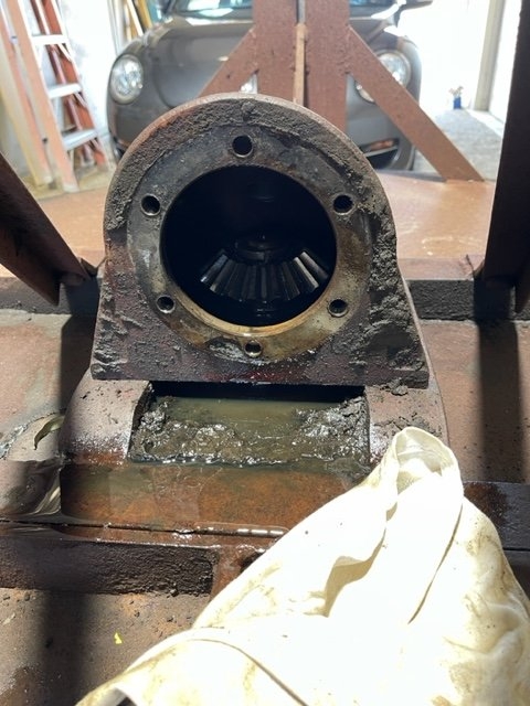

Yesterday I P-washed the gear box and located the oil leak...
Today I brought it back into the shop and put it on the horses to fix.
/ Brush Hog mods
#118

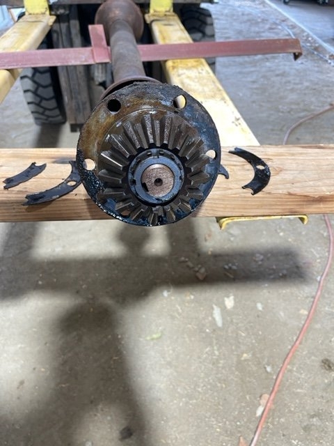

Got a couple of pictures. Bad gasket where the shaft bolts to the housing... the good news is the gears show little wear after all these years (y)
I cleaned everything up... ran down to O Riley's and got some RTV gasket material. She should be good to go in the AM.
Shame about the oil spill screwing up the metal for painting... any way - I am looking for a spot to mow.

Ugh! New problem now is RTV gasket is just too thin. Gear lash or clearance is too small - she is binding. I'm going to have to get some gasket material and try again. :unsure: the simplest things get complicated sometimes.
Need to maintain the OEM thickness.
/ Brush Hog mods #120
The gears look the same size on the pictures, is that true? Do you know the ratio of the gearbox?
