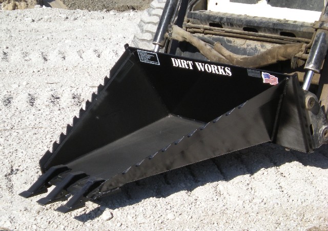

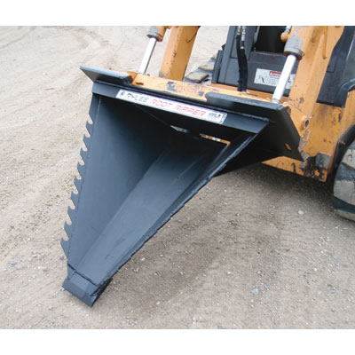

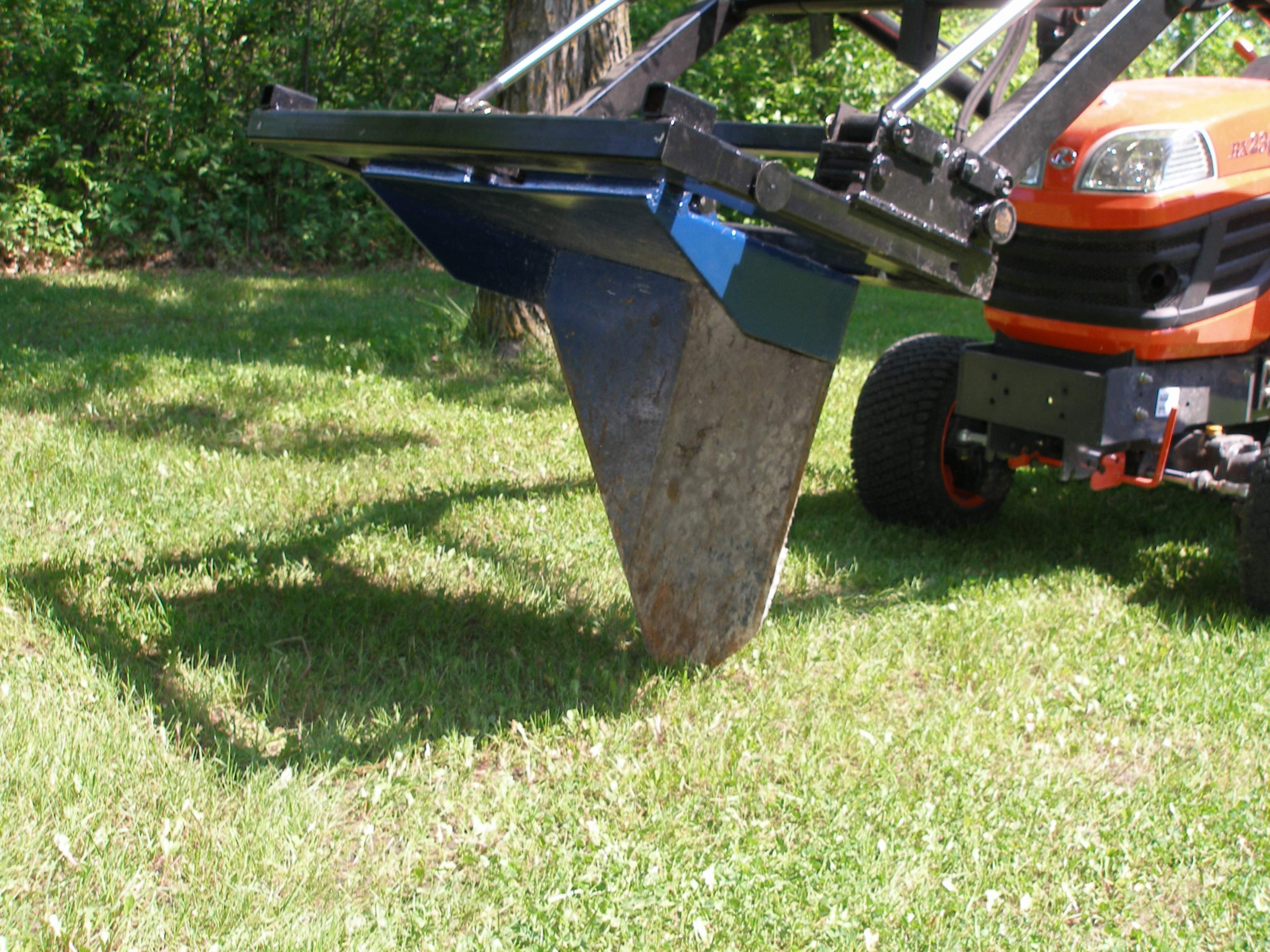

Just make one of these in a smaller scale.
Thanks, I had my eye on these for a while. Just need some time to talk to a local fab shop about what it would cost. Ideally, I would put a sharp edge with serrations to cut thru roots. That scoop plus more weight on the PT425 may give me the ability to remove 2-three inch saplings without leaving stubs behind. Filling the holes is easy.
