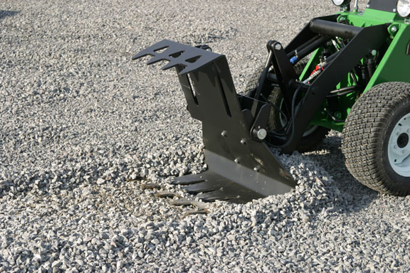

Have you seen this product? Watch the video
http://www.ratchetrake.com/
You can mount the Ratchet Rake on just about any bucket, except the 4 in 1 bucket.

Thanks JJ. That is an interesting device. I have a small bucket with teeth and the utility grapple that I was hopping to use to pop out small saplings and brush. My brush mower attachment will handle this but will leave 2-4 inch stumps that will injure short legged dogs and probably me. The grapple shown below should work. I guess I need to add weight to the rear of the PT-425. The rear of the tub is vented, so probably the only way to proceed is to replace the standard hitch with a 2" receiver and have something built to carry weights.
