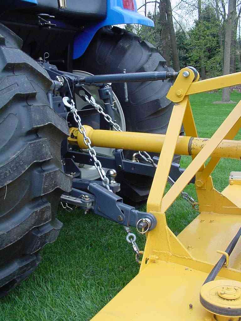

I have similar chains on my mower. See attachment. I believe that every brush hog and any mower without front wheels should have them. They work that great!

If you are saying your rotary cutter is rigid and does not move up and down with the contours of the ground then you must not have a flexible, (swivel), connection for the toplink. Some guys use a chain instead of a toplink. The checkchains will not give this flexibility, they only keep the front of the cutter at a pre-determined height and keep the strain off the 3ph.

The chains appear to work just the opposite of gage wheels. Wheels prevent the deck from going closer to the ground when you roll over a hump or dip and you get a constant cutting height. Chains don't do this.
Do you use the chains as a height adjustment instead of the 3 PH lever? I can see where it would be useful to just put the lever all the way down and let the chain length determine the cutting height.
/ Brush hog converted to finish mower #10
The chains do work a lot like gage wheels, except the wheels are those of the tractor - the rear tractor wheels.
Yes, I drop the 3-pt level all the way down, but the chains keep the arms from going all the way. I may be hard to imagine how well this can work, but once you've tried it, you'll never go without. As long as your top link can flex, the system works incredibly. Some mowers come this way. Some brush hogs do also. My mower did and I retrofitted my Woods hog. Many folks, if their equipment didn't, opt for a chain-type three point top link instead of the large turnbuckle one that comes with the tractor, and then put on the check chains.
