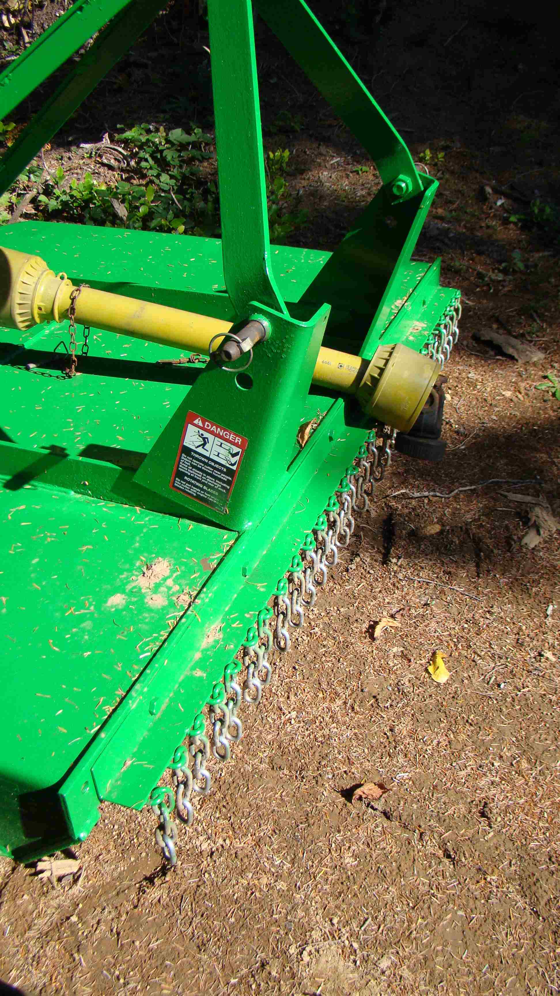

I welded chain to 5 feet of angle then bolted it on. I do hit rocks along driveways... It seems to work fine.
The angle extends the chain far enough away to clear the blade.
Have some type of guard, it couldn't hurt.
