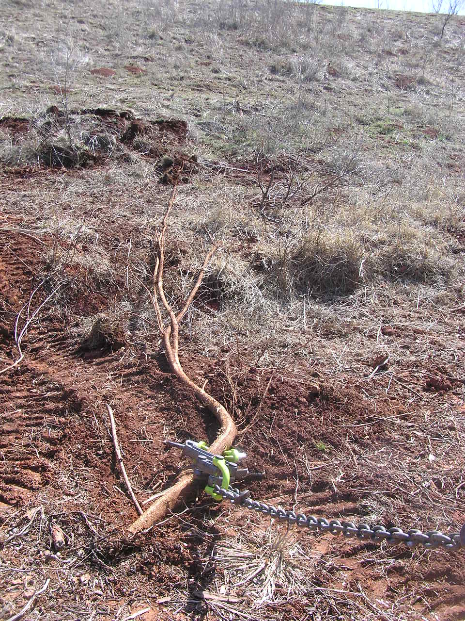

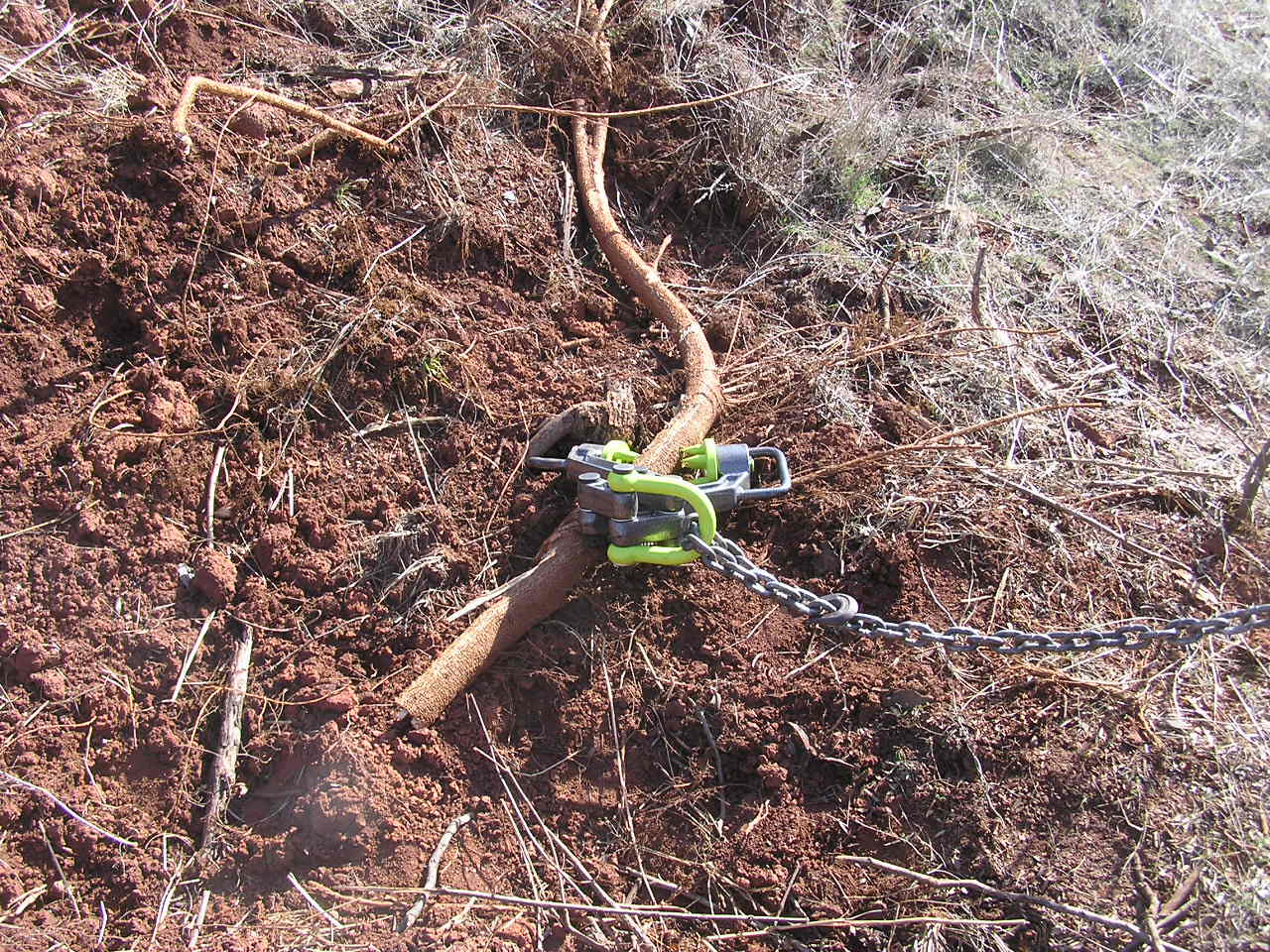

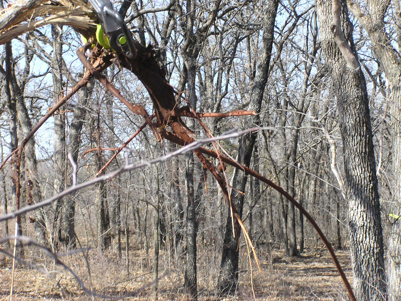

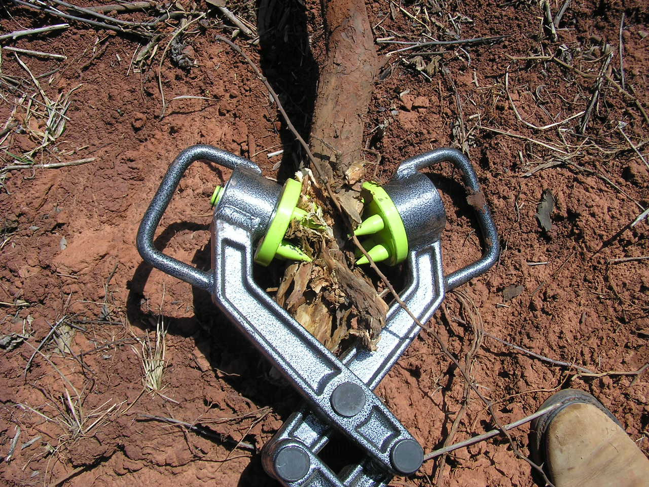

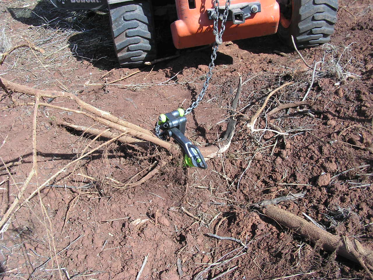

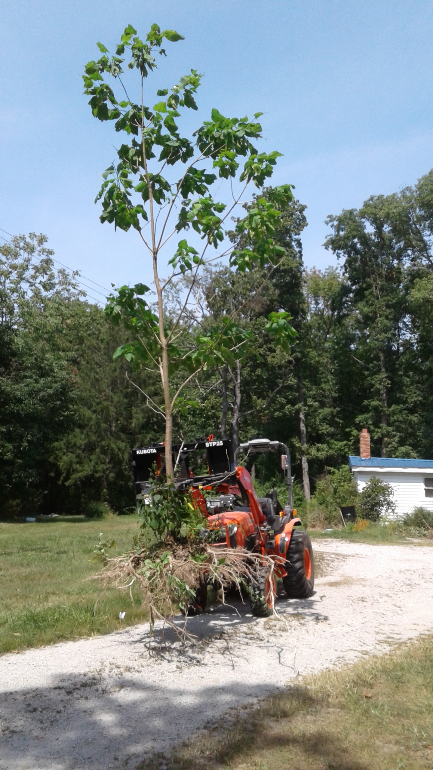

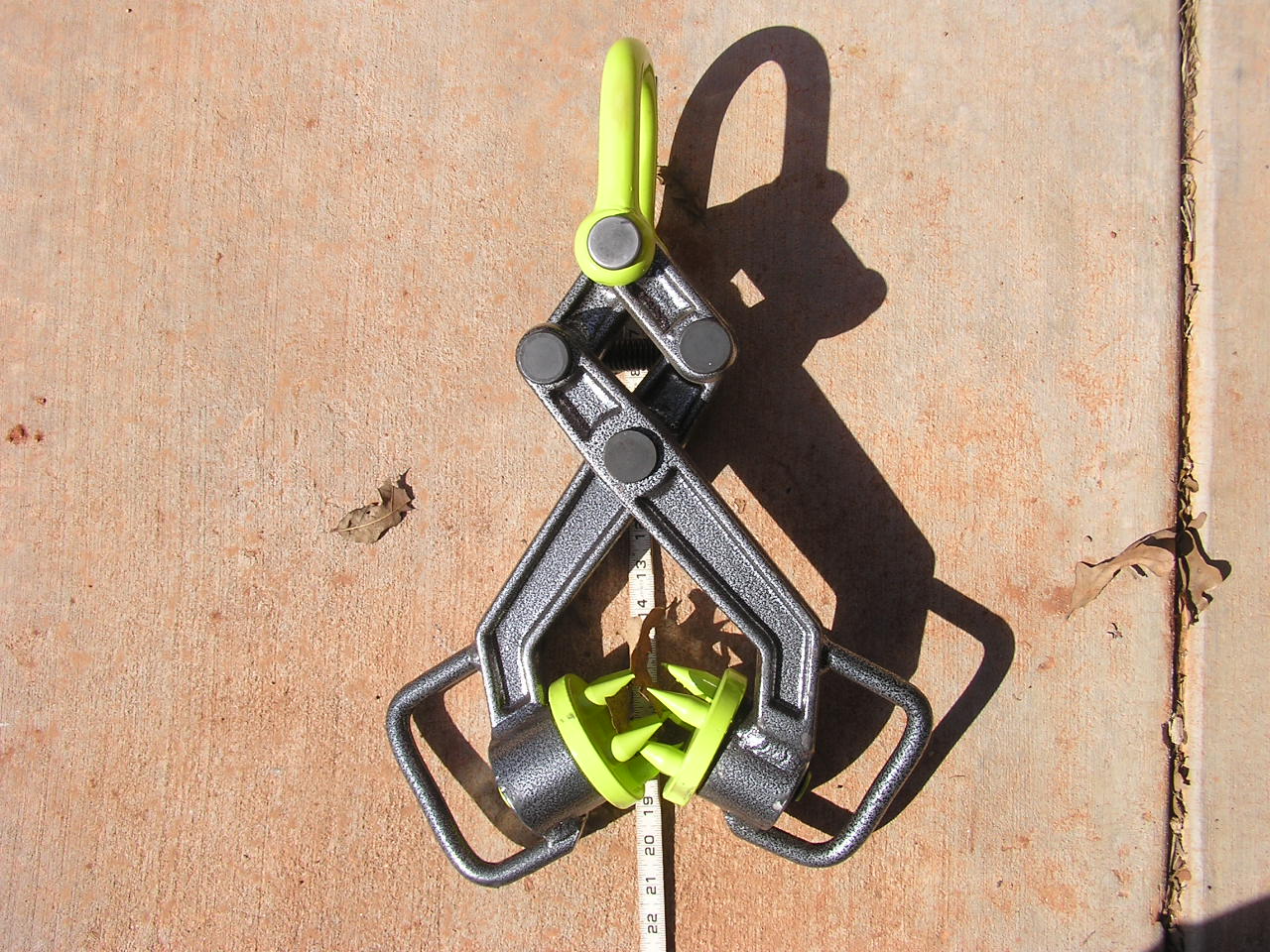

Several years I bought the BG-20 Brush Grubber. It was the biggest one made then, weighed 35 pounds. Worked great, especially if you had a helper.

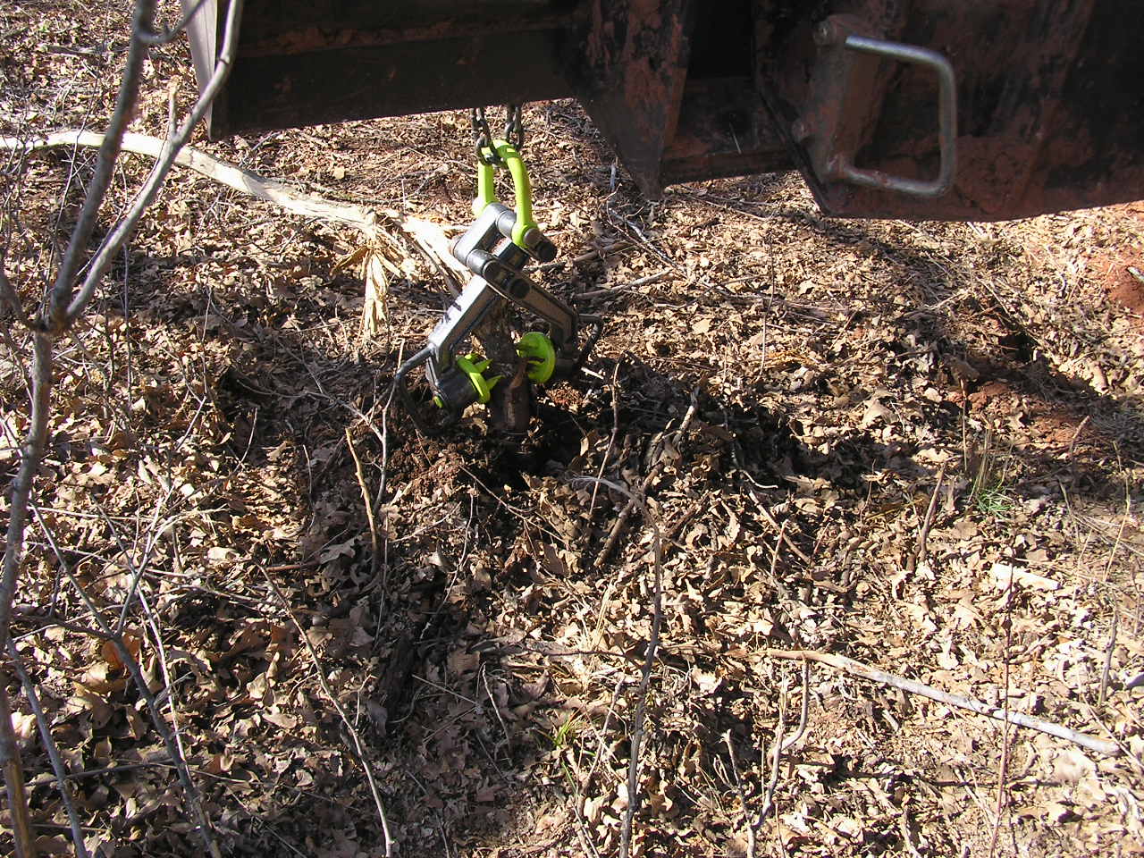

On the bucket:

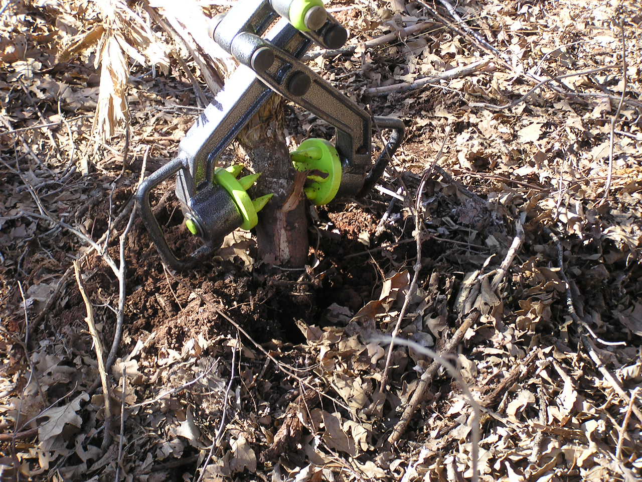

Also good for pulling roots broken off when the tree was pushed over:

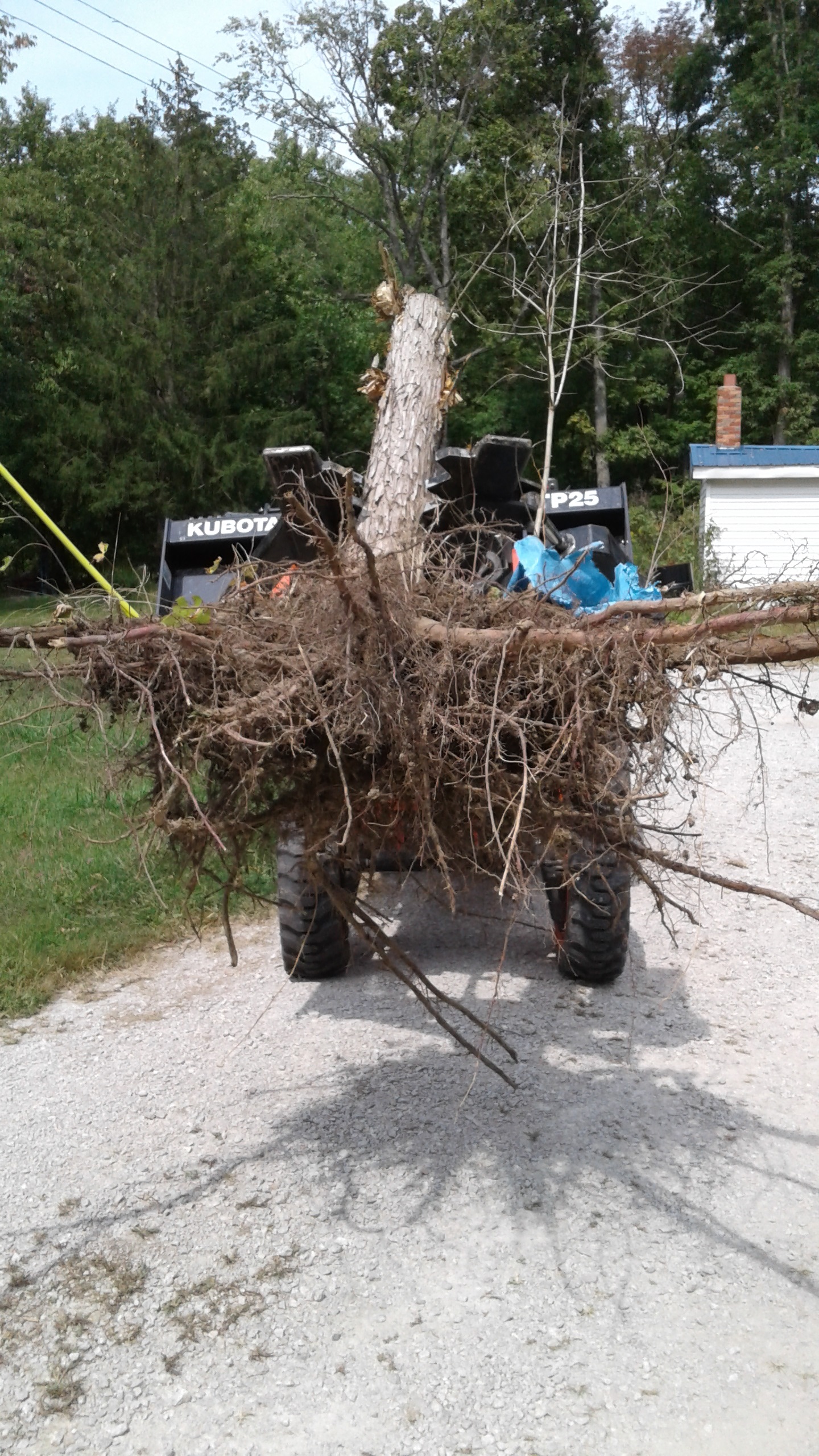

I have both as pictured in post #1. Chain is best for anything under 1" BG-08 for 1 to 4" range, don't clamp trunk, place it around trunk and let it wedge/dig in.
I also have this for small hillside stuff BrushGrubber | Metal Handled Brush Grubber
But I prefer using this tool when possible
