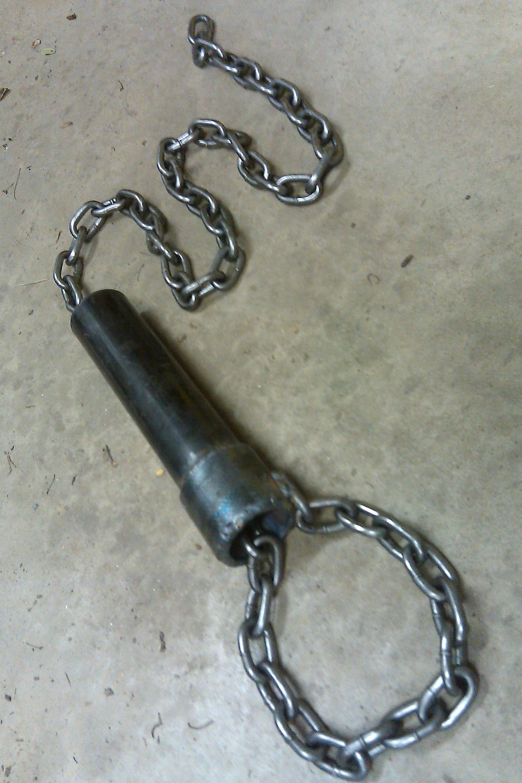

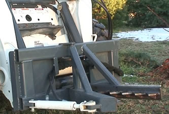

How about something like this.

   / Brush Grubber?
Something along the lines of the first pic might work adapted to the FEL. I know chain and the others wont work.
The brush is like 20-40 pencil diameter shutes coming out of a root pack, if that makes sense?

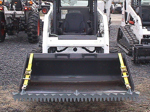

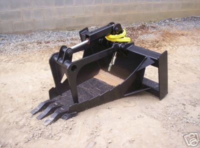

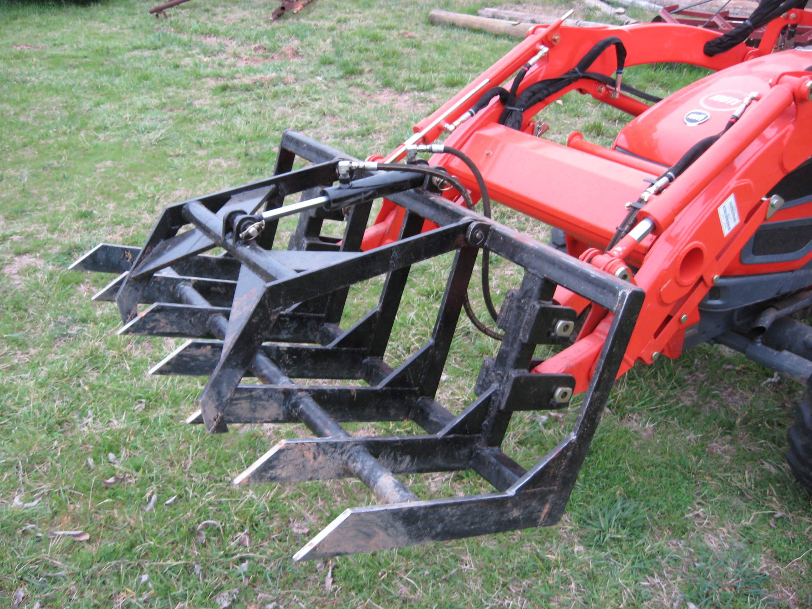

   / Brush Grubber? #4
   / Brush Grubber?
Thank you Sir! I do believe thats the answer, I can see that working out for me. Ya know I made something similar for smoothing out the caliche pad at work with fork lifts when pot holes form by trucks/ equipment useage.. An attachement, angle iron cut in "V" like that to "loosen" the caliche, then flip it over for the smooth side to blade the caliche smooth/ fill in low spots.
   / Brush Grubber?
Just thinking out loud here, that same style attachment could be used on the top side of the bucket for breaking off tree limbs up high.
   / Brush Grubber? #7
What type loader mount? this would be fairly simple. get the mount, build a rigid frame, attach rect tube vert. 3x2x1/4 at 6-10" centers, drill 3/4" holes for pins, and use ripper shanks for a box blade.
let me know if you need help invisioning this discription.
