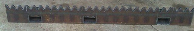

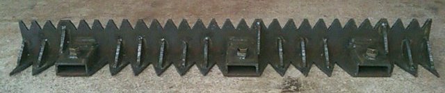

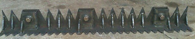

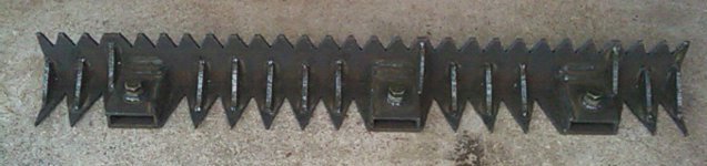

I’m in the process of clearing an old creekbed at my weekend property where I intend to make a small pond. I’m going to widen the creekbed into about .5 acres of water. I’ve been pulling down the larger trees with a chain (I have horse panel attached to the back of the ROP in case of a chain failure). Now I’ve gotten to the point that I need to remove lots of choke vine and Yaupon bushes around the perimeter of what will be the pond. Eventually, I will be clearing Yaupon from other areas of the property also. Since using the chain would require LOTS of getting on and off the tractor to hook & unhook, I decided to make a grubber/rake attachment. I considered the Ratchet Rake which looks like a well designed and heavy duty piece of equipment. However, I didn’t like the fact it is made to go on the front of the FEL bucket because I have the Kubota Quick Change and I made a carrier for some pallet forks ( http://www.tractorbynet.com/forums/build-yourself/198801-what-can-320-about-10-a.html ) that I use to move the trees and brush to a burn pile away from where I’m building the pond. At first I thought about making the rake fit the carrier similar to the way the forks attach but decided against that because it would involve changing back and forth between the forks to move brush and the rake to take it down. So, I came up with the idea to make the rake slide onto the forks, that way I’ll have both at once. I was going to make the rake fit at the end of the forks for more flexibility of angle and reach but decided to make it slide all the way back on the forks giving me more lifting power to pull out the brush. I also welded some 7/8 inch nuts to each tube with a bolt through that will cinch down on the forks to prevent the rake from coming off when I dump a load of brush. I guess if I find a need to, I could slide the rake to the end of the forks and use the bolts to hold it in place. I made it so the small teeth will be up and out of the way for larger bushes but I can turn the rake over and slide it on the forks with the small teeth pointing down for dragging vines and such. OBTW, sorry I didn’t find the need to grind and make it real pretty because I figure it will be digging and sliding on the ground right away anyway. :laughing:
BTW, I'm open to suggestions on how I could have or still could make this work better.

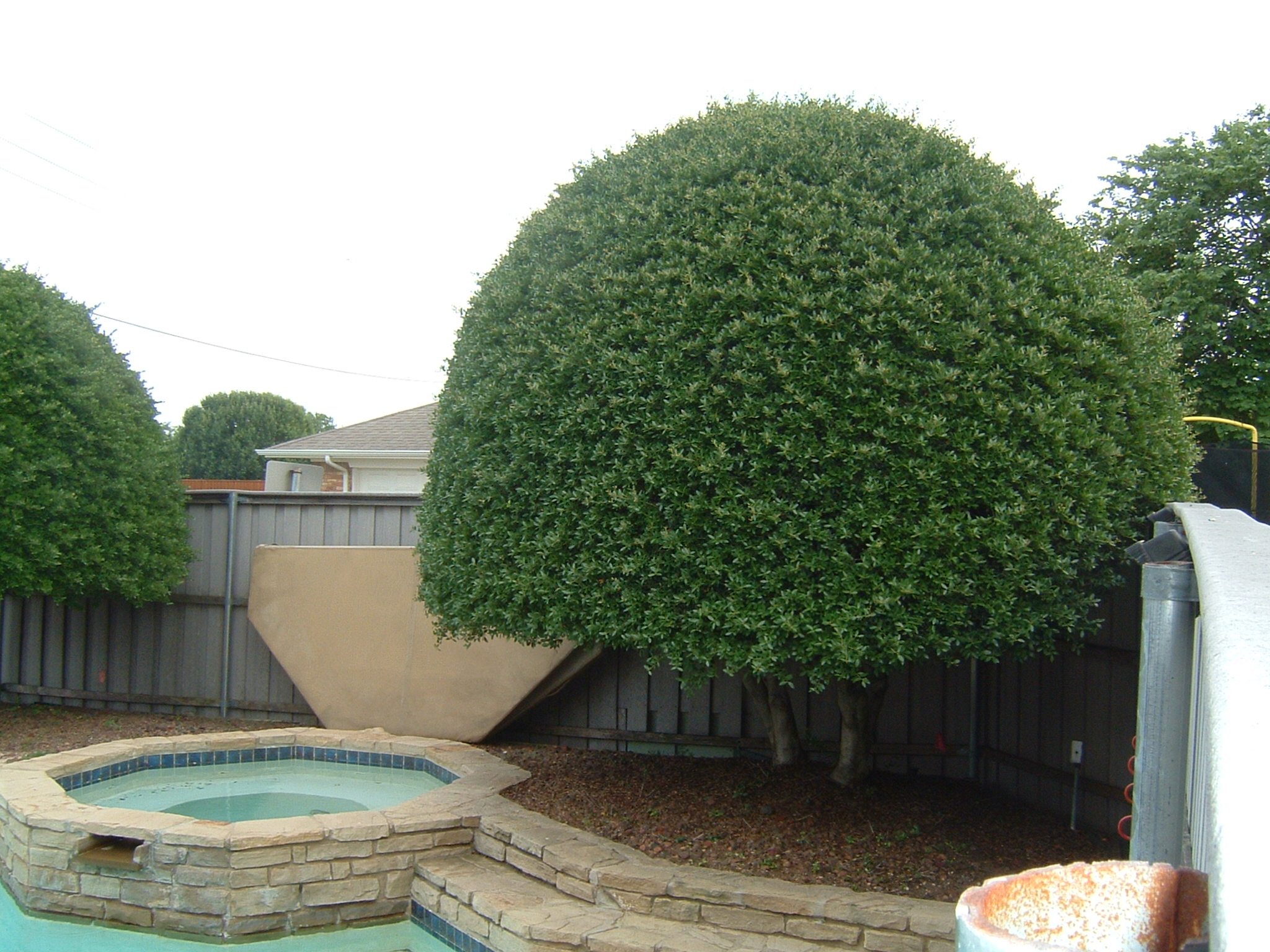

Yaupon can grow up to 12' tall or more and will basically become a tree if it is out in the open. Mine is between the oaks so it is about 8 feet tall with trunks no bigger than about 3" diameter.
Yaupon: eNature: FieldGuides: Species Detail
As you can see in one of the pics, lots of people cultivate it in their yard. If kept trimmed it can be quite a nice bush and can be trimmed into topiary. It is kinda funny that some go to nurseries to by it and I'm trying to remove it. It can run rampant in the wild, spreading everywhere. One of the problems is that it takes nutrients and water away from the trees.

Thanks texasjohn, now I just have to get to my place and see if it works as well as I hope. I'm thinking about going out there Thursday since we just got a "cool front" through and the humidity will be a little lower. It's already been running around 90 degrees with high humidity for the last few weeks. This will probably be the last "cool" day we get in the SE Texas area. :laughing:
davygp38, I thought about getting a piece of 4"X8"X.5" angle the steel warehouse had, but I thought that would be overkill for the smaller brush I plan on removing. Plus, the 4" side wouldn't have been big enough for the side with the small teeth I wanted to have. I chose a piece of 6"X6"X3/8". The large teeth are 3" wide at the opening and are 4" long and the small teeth are 1.75" wide at the opening and 2" long. For brush with trunks larger than 3" I will use the chain. Or, I'm thinking about making a large single opening grubber to fit the 3pt; with an opening for trunks up to 5". That way I could have both on the tractor at the same time. The 3pt will have greater lifting force anyway.

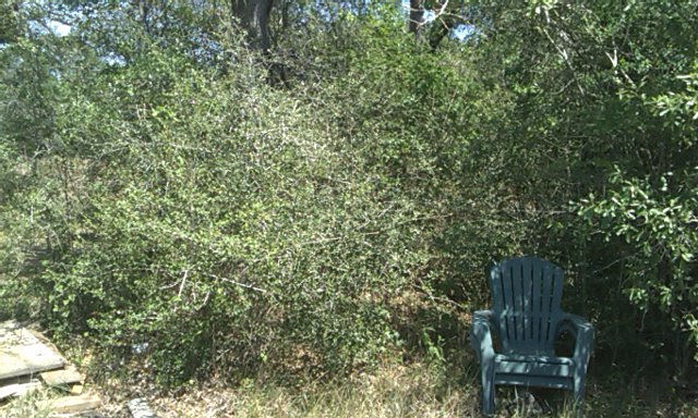

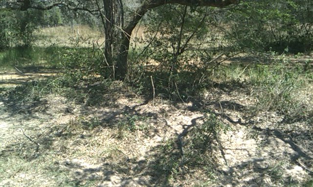

You asked for a report, here it is. IT WORKS!!
The teeth of the rake bite into the trunk of the brush/small trees and remove it with the roots. I can take out several bushes at a time by driving into them with the rake skimming the ground, then when I have a few bushes moving along with me I use some lift along with curl. The curl keeps the bushes locked into the teeth so I can back out and put the pulled bushes on a pile nearby. I can then go back and pull out some more and repeat. When I have a pile I think is a load, I use the forks to pick it up and move it to the burn pile. It's all working as I hoped. This is in sandy soil, I'm not sure if it would take out bushes as easily in harder ground. They might just break off instead of coming out with the roots still attached.
I'm definitely glad I decided to make it with both the rake and forks on the fork carrier at the same time. Doing it that way really streamlined the operation.
The first pic below shows the type of brush I'm removing; the trunks of some of the yaupon are about 3" in diameter. The second pic shows what 3 passes with the rake will do.
