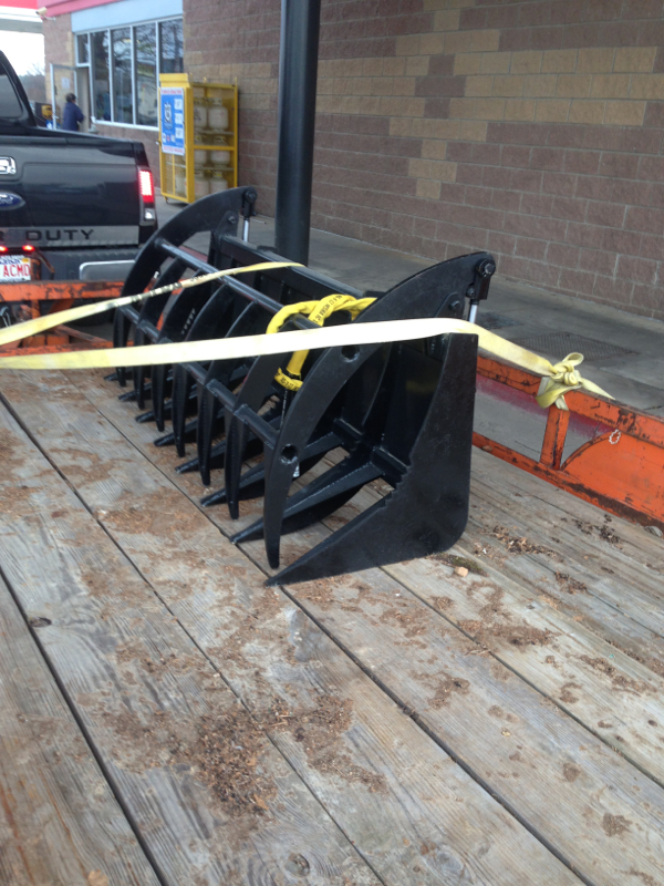

I am beyond pleased with my Armstrong Ag root rake style grapple (BGR-726). Not sure how widely distributed these are - it's made in Brenham, Texas but they only sell through their dealer network. I'll even plug my dealer, Paige Tractors near Giddings, they're great to deal with. For the price it's very well made and seems to have the geometry and hydraulics well balanced. It opens to 60". Recently I used it to place some salvaged 30" concrete culvert and was gobsmacked at how easily it handled and precisely placed each tile. I keep finding new uses for it and it's become a go-to piece of equipment for a lot of odd jobs - one of those things you wonder how it was possible to ever get along without. I run it on my Yanmar LX4500 and I had no idea a smaller tractor like this could do the things I do with this grapple. If you can find one, it's for sure worth taking a look.

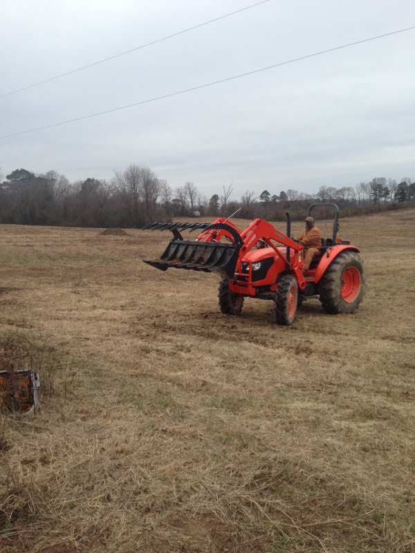

My use would be clearing logs and brush piles on my property.
I can tell you that last year I purchased the 54" ETA WRG for the same purpose. I had lots of brush piles around the farm and many trees to clear up. As you can see by the photo, I didn't run into any problems and was truly amazed at how quickly the brush piles disappeared. I didn't notice any limits to having a 30" opening. Once I got used to filling the grapple with brush the job went even quicker. Plus, Travis @ ETA was awesome to work with. I had the wrong hydraulic connections and he worked to make it right. The Deere dealer ended up finding the right parts after a 45-minute search and since then it has been smooth sailing.
