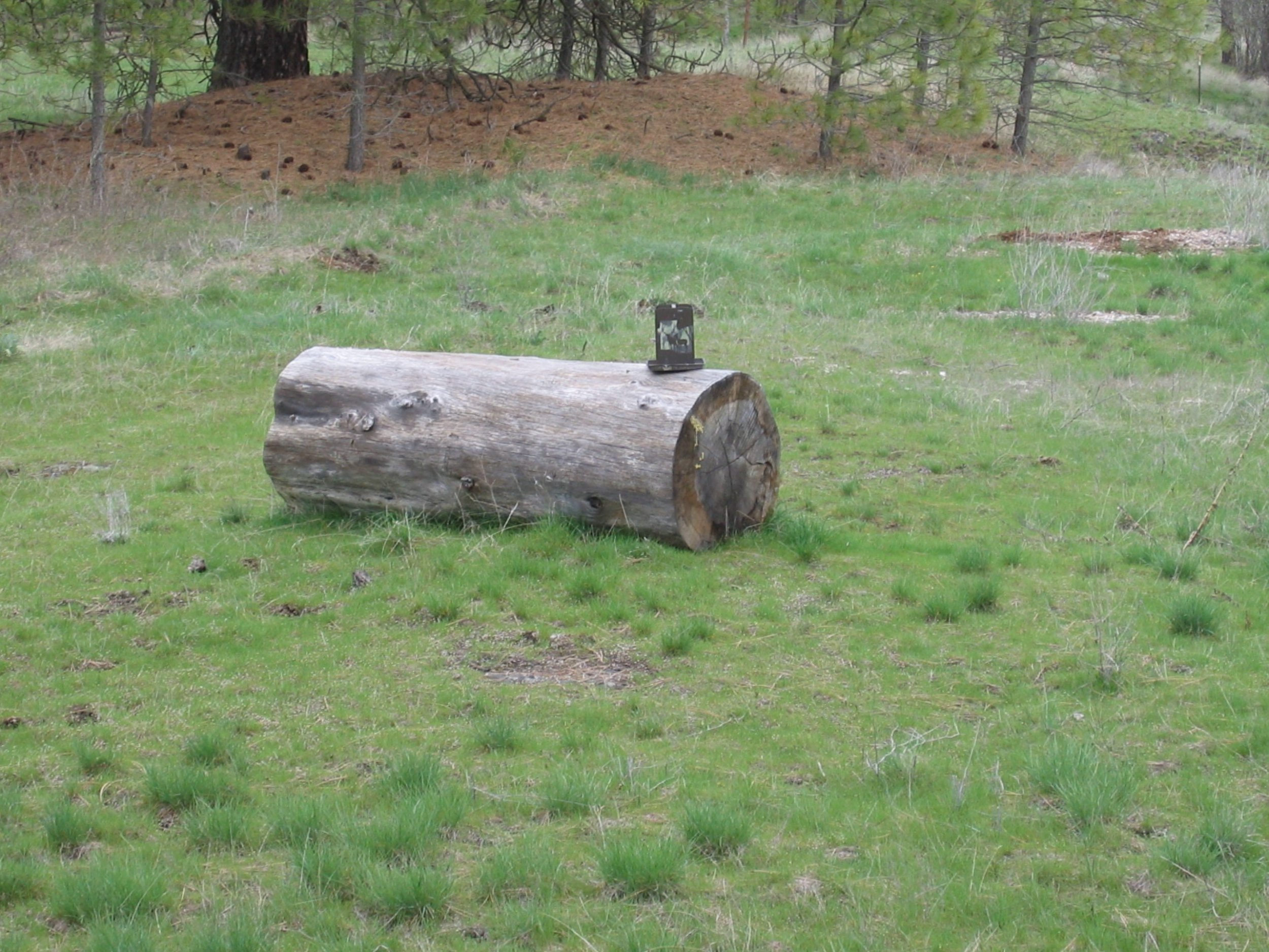

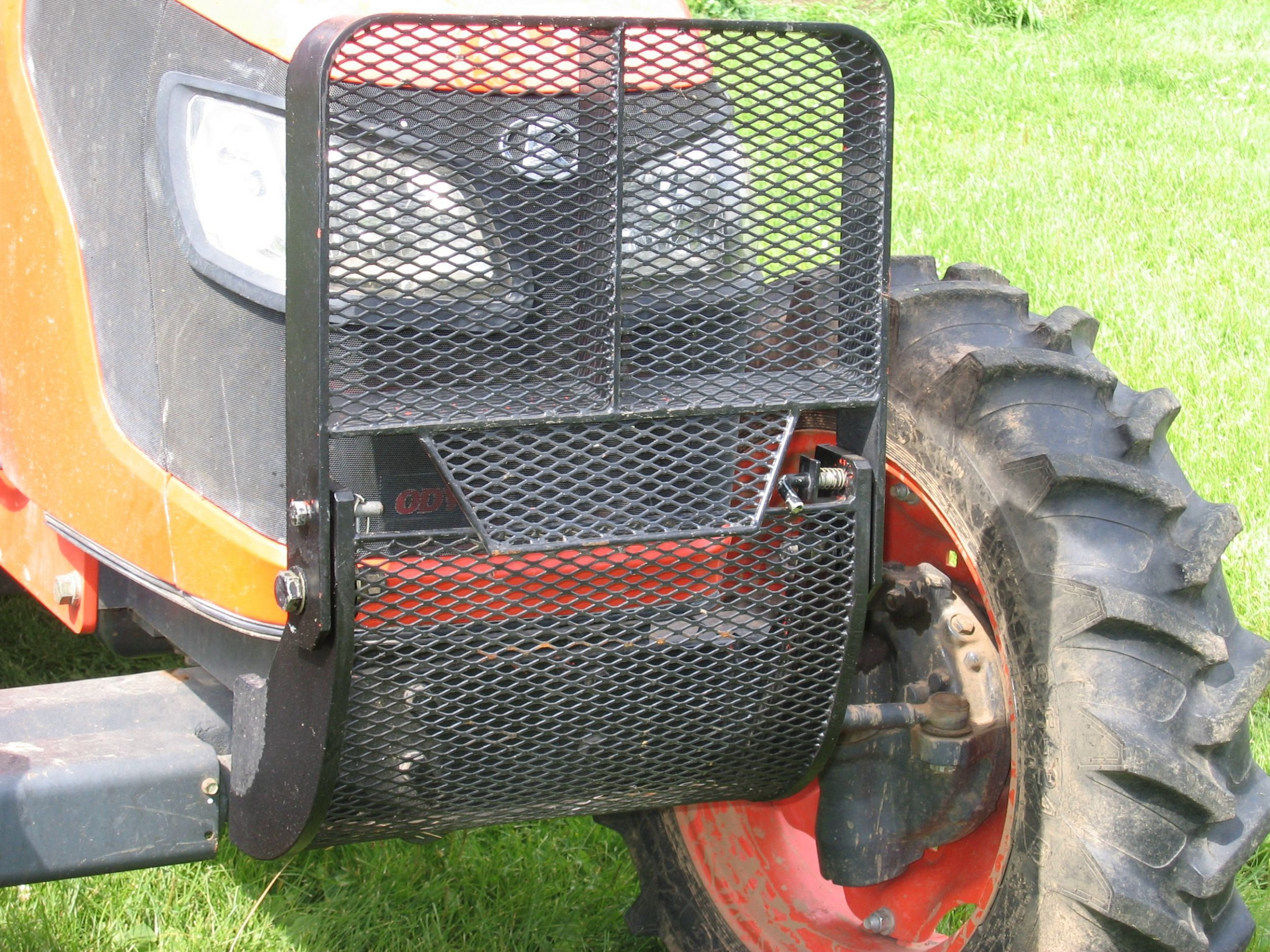

My Land Pride SGC1560 grapple is - 60" wide and weighs 820 pounds. Of course, it's on my M6040 which is a tad larger than your L3710. I use it to lift really large rocks and chunks( 5' or 10') of pine tree trunk. If on solid footing I can lift 3000 pounds with no problems. These really heavy loads are NEVER lifted high. My technique is referred to as "knuckle dragging".
My grapple and a 8 foot chunk of pine tree trunk. This chunk is 38" in diameter. Also - consider doing something like I did to your front brush guard. Sticks, stobs and limbs have a nasty way of damaging your radiator, grill and battery.

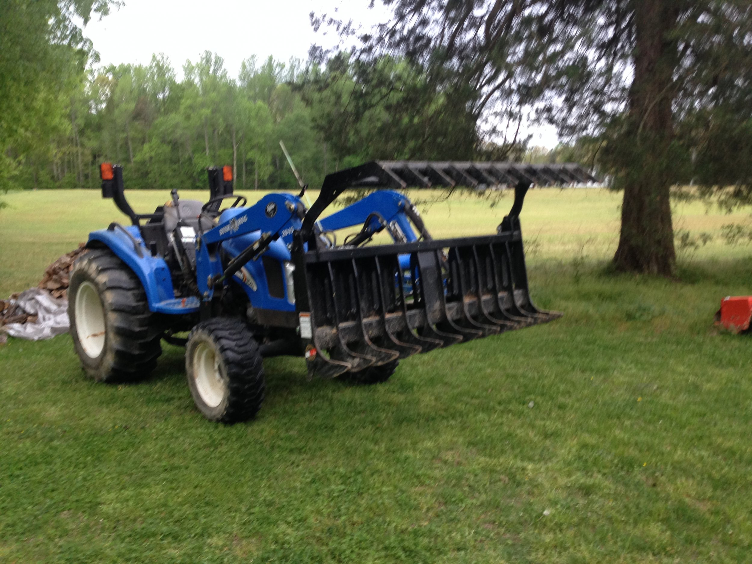

Have a 54” dual lid wicked on the B26. Absolutely love it. About the same lift capacity. Don’t want a wide grapple on a small tractor. Over 5 years of use and abuse no damage.
There are other places to save money. EA makes some good stuff and worth the wait. While waiting consider adding rear wheel extensions, ballast in tires and front grill protection. The B26 needed all those for our hillside farm. Do you have 3rd function?
Brush guard is on.
Calcium in tires.
Woods9000 slung on back.

Good. You are ahead of the curve. Be mindful of the weight. It’s not just the thickness but type of steel that gives it strength. The wicked, dual lid, 54” is 397#. You might get your guy to weld some horizontal bars in the middle between the ssqa mounts like the wicked to help prevent branch pokes. Doesn’t have to be heavy bars.
Grapple tines bypass or touch? Have one of both and advantageous of each. Wicked touches and can pick up a twig or fist size rock. Hope you are in grapple heaven before too long.
