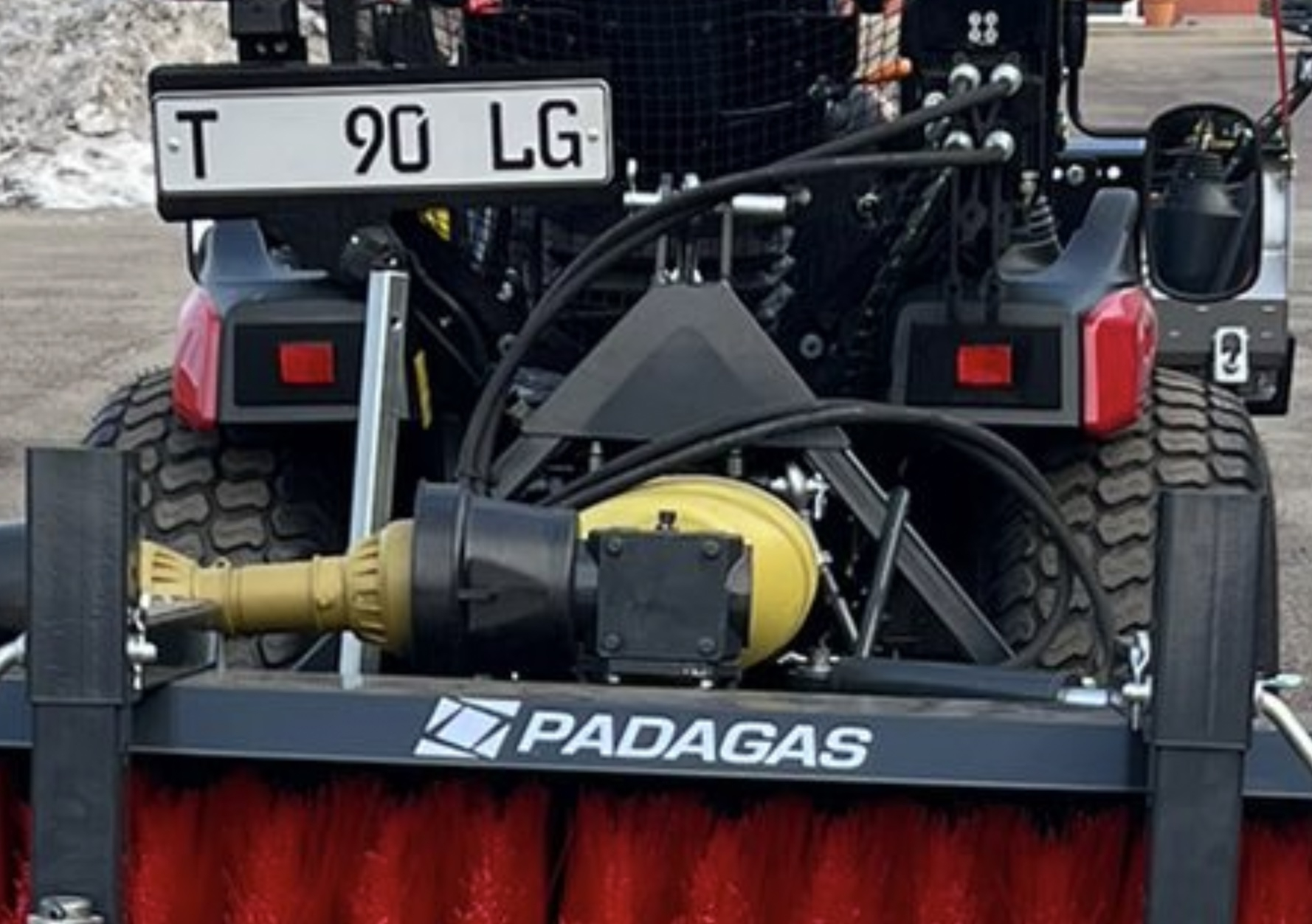

I agree. It needs to be throwing the snow in front of its direction of travel, other wise it'll just be putting the snow back over its tracks.
With that said, I've never seen a broom on the back of a machine. It's always been on the front. They make a tremendous cloud of snow and slush, depending on temperatures. I sure wouldn't want it turning towards the machine at any time.
Absolutely:
"It needs to be throwing the snow in front of its direction of travel, other wise it'll just be putting the snow back over its tracks."
All airport runway sweepers work that way as do small walk behind sweepers.
On those big sweepers they are operated at about a 45 deg angle so as to fling the snow or debris off to the side otherwise they'd accumulate a massive amount of material or snow.

Was able to make quick test yesterday
At first - guys were right about castor wheels. They are swinging only 180 deg, so no more questions about driving direction. Only forward, thus means rotating only towards tractor. Thus tractor becomes dirty. :confused:
But I will figure out a kind of deflector to keep tractor clean. I mean best position will be not near brush but where 3p arms are.
Snow has fallen during rather cold night, but at 1100 was already warm and sunny, under direct sunlight snow has started to melt. So I had different types of snow
1. very wet, almost melted. Goes away nice and smooth. Almost feels like brush instantly melts that snow. Surface remains clean and almost dry. Really nice.
2. Wet but strong. You can make nice snowball out of it.
a. if it is less than 2 cm - brush works very nice, really great result
b. if snow is thicker I got a feeling like I got big bed-sheet is wrapped on broom. Snow just goes round and round and surface remains dirty
3. Dry powder. Same effect as #2, but breaking point is a little bigger. Still, if snow is more than 5 cm, brush is hopeless. It's just messing around
