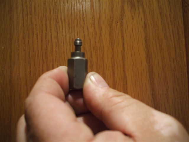

A zerk snapped off level with the hole. Nothing above the edge of the hole for me to grab and back it out. What should I do?

Here is a picture of the broken zerk attached to the snap-on tool I used to remove it.
Everything went well.
The tool from Snap-on was sooo nice and allowed me to use "hand power" to gently back the zerk out.

When dealing with extractors.. 'hand power' is all I'd ever use.. unless I wanted a snappe doff hard tool steel peg in the hole that I was working on..

DocBob, that extractor you have is the best design out there in my opinion.
