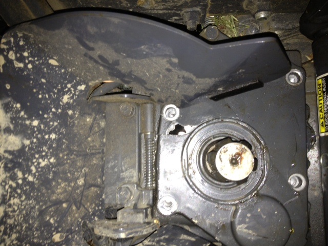

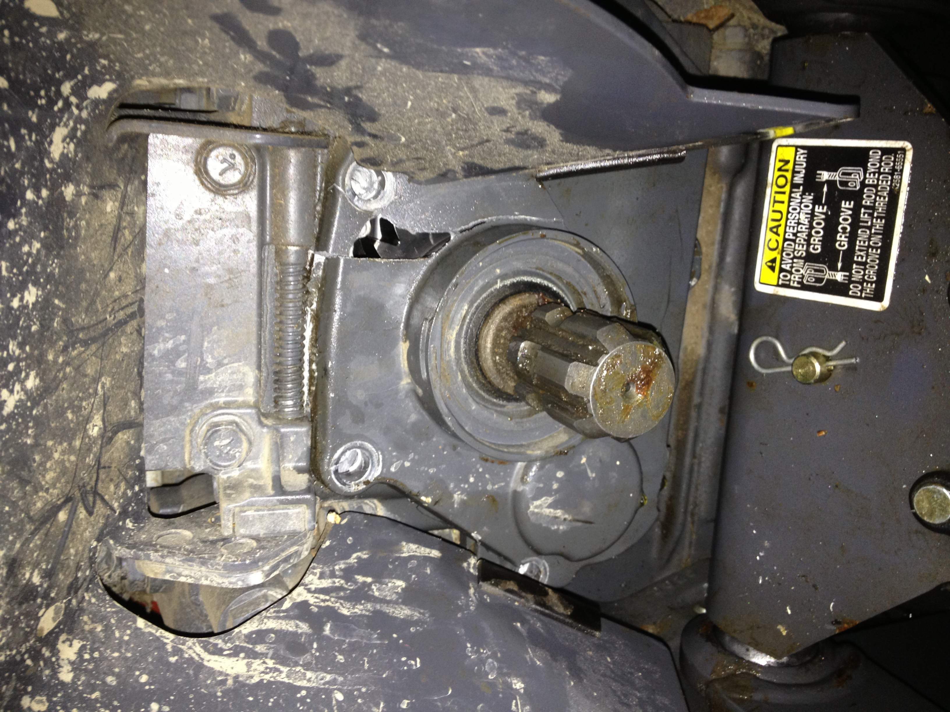

Need some help I screwed up major. I left the pto shaft on after removing the cutter and backed up. The housing around the pto shattered and I think I may have bent or moved the pto itself. Should I remove the cover to see what I damaged or leave this to the pros? I'm sick, I heard the fluid spilling out and shut it off immediately but I'm afraid the damage is done. Has anyone removed this ? its cracked from the dipstick all the way across to the other side of the pto. Anybody else ever heard of this happening? Or am I the only idiot that's ever one this?

I got lucky, only bent the snot out of the shaft and driveshaft yoke. I was actually able to straighten the yoke and only had to replace the bent piece of shaft. Mine's been running for over 2 years since then, no problems. Have you got a picture of yours? The actual stub of the PTO output shaft is pretty tough, you're more likely to break it than bend it.

The pto moves when I grab it. I don't know what it looks like under the cover though its on a hill and with no fluid I'm assuming the brake is the only thing keeping it in place. I to a little nervous working on it there so it's gonna it until I can pull it up to the garage.

So is it possible the end of the shaft dug in the ground while you were going backward, and then acted like a pry bar, wedged against the drawbar and pulling backward on the PTO stub until it fractured the case? If you knew whether the damage was from pushing or pulling on the stub it might help understand what's likely to be broken inside.

I hadn't considered it breaking from a pulling force. The shaft was in the ground and it was under the weight of the tractor so it most likely was pulling by that point . I unbolted the cover but haven't removed it yet because its out in the rain. I'll take a look tomorrow. Luckily my neighbor has one to pull me up the hill.

Well I got lucky as the damage was contained to the cover itself. The dealer wants to replace two bearings fluid and filter just in case there's any metal floating around so about 400.00 the bad news is I've gone almost two weeks and could have fixed it myself in three days. I'm thankful though and I'll never forget to release the drive shaft from the tractor again. Thanks all.
