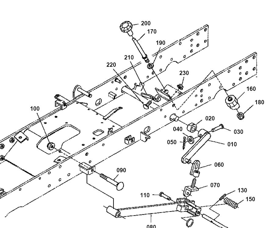

Today I removed my mower for the winter and discovered that the Left rear lift link is broken. There is a flat oval shaped piece on the end of the pin and it snapped off. Has anyone heard of this happening? (60 inch MMM on a BX2200)
It is part 010 on the attached drawing.

Bummer! :( You are talking about the shoulder on the pin at the end of piece #010, right? Don't see much way of fixing that besides replacing the whole arm. Must have got some twisting force somehow.

If I'm looking at the right part, did the part break at the weld? If so, and it didn't mangle itself, you might be able to just reweld it. Or if the unit is still under warranty, a call to the dealer might be in order.

Yes, it is part 010 and it did break at the weld. My cousin is an expert welder so I may have him take a look at it. The part that broke off is so small that it may be hard to re-weld.

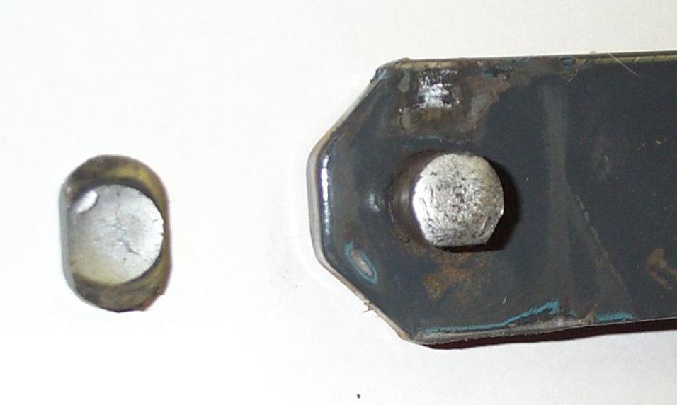

Those are good suggestions Volfandt. Tomorrow I will get a price on a new part. If the price is too high I will see what my cousin can do with it. He makes a living taking on difficult welding projects.
When I looked at the part closer, it almost looks like it was cast rather than welded.
I attached a photo of the part that broke.

Good pic! So it's broken at the tip. I don't know if that can be rewelded.
Wonder if you can just order the stub?
Also wonder if a #5 bolt welded in and the head ground down to resemble the stub would work?

I think the shaft and tip are cast as one piece and then the shaft is welded to the plate.
If the tip is welded to the shaft, the weld joint is not visible.
The #5 bolt may be the best solution if I don't buy the part.

I hit a stump with my mowing deck a couple of years ago and broke the link in the same place. I drilled and tapped a hole through the center of the pin and installed a small bolt and washer to replace the ear. Its still there without additional trouble.

That is exactly what I did. I drilled and tapped the stud and used a 3/16 bolt. I still ordered the part because I was concerned that it may break at that point in the future.

I picked-up the new part today and it looks like they beefed up the ear at the end of the shaft. The total cost was $24.34 with tax and shipping. Not too bad.:D
