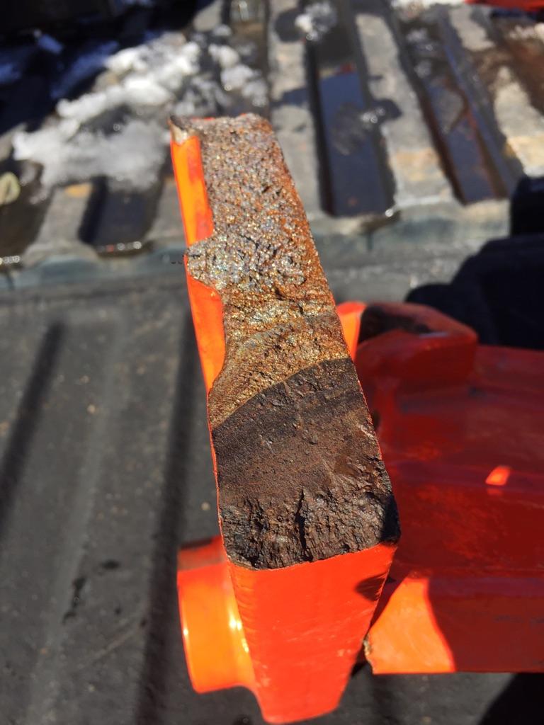

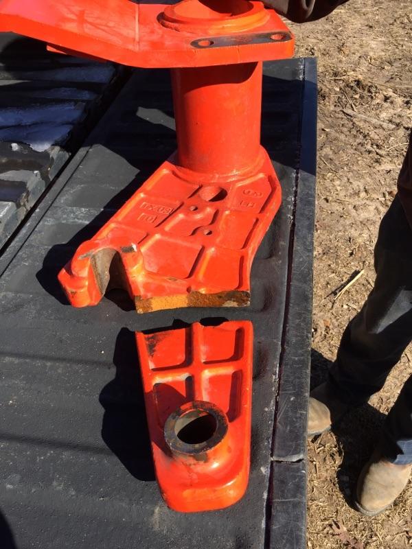

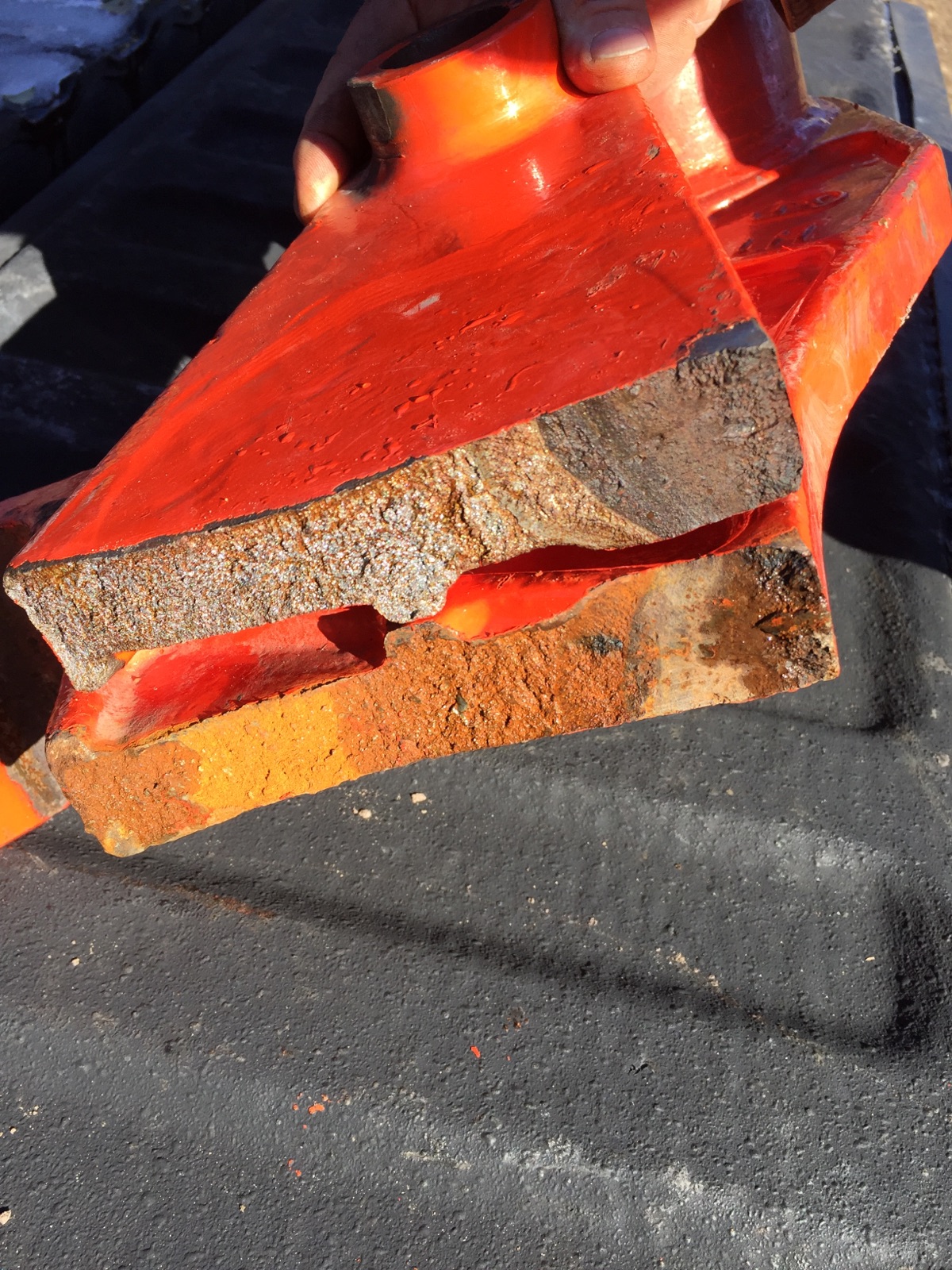

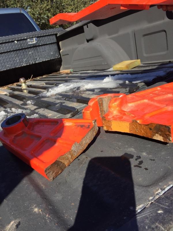

I was using the backhoe and moved the rear of the tractor over to reposition it when I heard a loud snap.I got on the tractor to use the FEL and noticed it was lopsided,looked down and saw the bracket broke clean in two.After going back to the garage I was able to get the loader off.I called the dealer and he said he would come down Saturday to take some pictures and send to Kubota. The loader has a 12 month warranty and the tractor is 15 months old so I am thinking Kubota won't do anything about it after reading other posts on here about similar situations.The tractor has 530 hours on it and most of that is FEL work.I do use it but I don't feel I did anything with the loader that I shouldn't have.When I use the backhoe I lay the FEL bucket flat on the ground so that it will slide when I reposition with the hoe.Maybe moving the tractor around with the hoe is not a good thing to be doing but I thought it was common practice when using the backhoe.After looking at the other bracket I noticed that it has a crack in it as well.You can see from the rust that the broken bracket also had a crack for a while before it broke.I will wait to see what Kubota says but I am thinking I will probably end up welding and reinforcing both brackets.I make my living as a welder so I feel confident in doing this if it is necessary.This incident has kind of left me soured on tractors but that will probably pass with time.I guess tractors are not industrial machines like a real backhoe and are only made to do light work.I never really envisioned something like this happening from the work I was doing with the tractor.Curious to see if anybody else has had a similar problem.The tractor is an L3240.
That's really interesting kcender because I was only doing what I would call light work on the loader at the time it went bang and the loader slew off at an altogether unhealthy angle. Mine broke on the other side, but at almost the exact same place, looks to me like they've under engineered the size of the casting. I haven't noticed a crack on the left hand side but I'll check it out with a bright light and a magnifying glass to see if there are any signs of weakness. I hope the welding and extra plates added to either side of the cast weld will be strong enough; if it holds OK then I'll probably beef up the other side too before it breaks.
