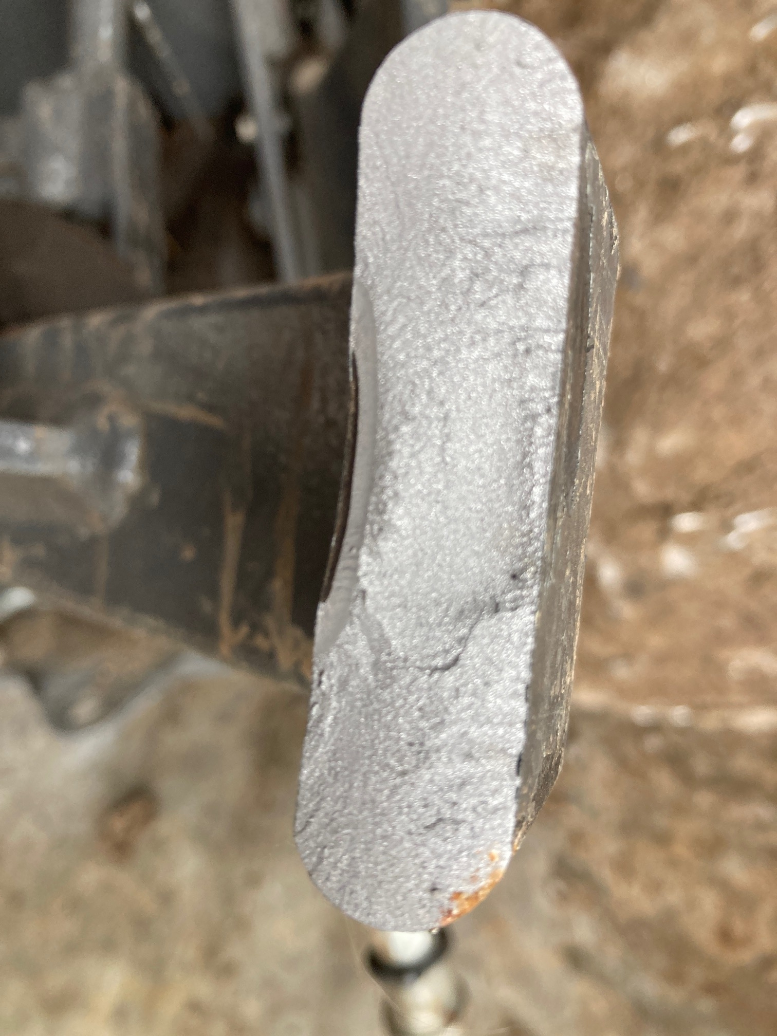

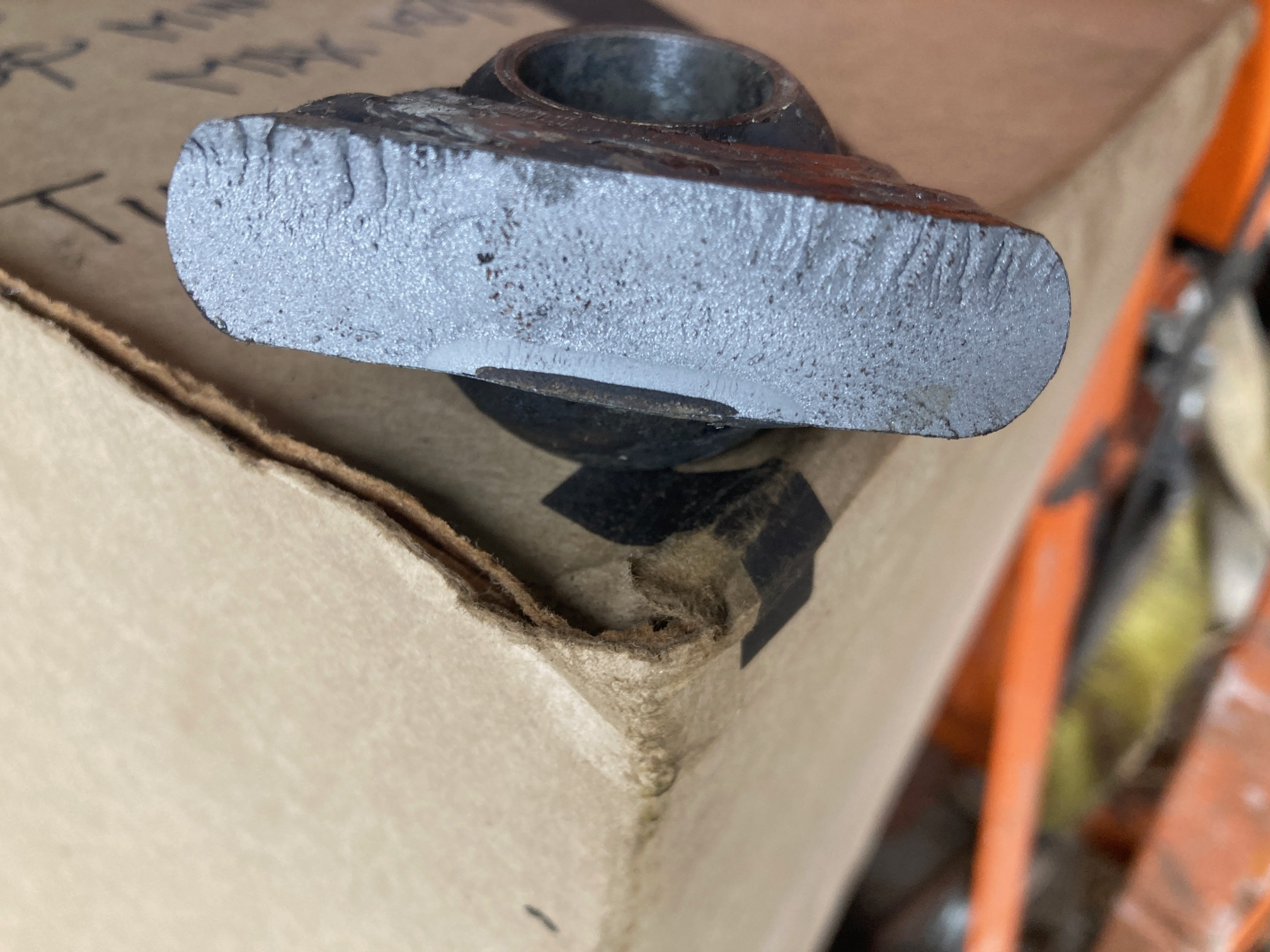

I was working on road drainage with a box scraper on my GC1720 , going slowly on a mild downgrade when Snap! The corner of the scraper caught on an immovable rock and one of the lower 3 point lift arms broke right off. It appears to be cast steel, as opposed to cast iron or fabricated from carbon steel bar stock. I welded it today with 7018 and applied my version of post weld heat treating. I haven't tried it out yet but I don't have 100% confidence in it.
I can fabricate a new arm using some bar stock and purchasing the ball eyes to be welded on. The bar stock would require bending and I can do that, just not sure if I need another distracting project and I might be better off just paying for a new arm.
I saw a YouTube video where a guy broke his lower 3 point arm on his GC1723 and he purchased a replacement arm that turned out to be an upgraded version made from steel bar stock, not cast material. Does anyone know if the same upgraded carbon steel arms are available for the GC1720? I haven't had much luck asking questions at my local dealer, that's why I'm asking here. Given the correct length, or close to it, I think these 3 point arms are about generic, one size fits all tractors of the same hitch capacity.

you said you welded it. I'm assuming you did a butt weld. Can you sleeve it with another piece of metal and weld it on? I think with a sleeve on it that will be the last place it will break again.

We're you going backwart/pushing? Very odd looking break if from tension/pulling.
/ Broken Lower 3 Point Hitch Arm
I agree it’s an unusual looking break. I was pulling. Looking closer at the part, I see bending brake marks where the angles were bent. So, it’s not a cast steel part like I originally thought. Now I believe the break was caused by improper cooling after the end ball was welded in.
My guess is that the factory, and it’s hard tell where the various parts are made on these little Masseys, wanted to get the parts to the paint shop and quenched the welded ends in water. Wallah! A brittle part.

A good weld should be strong enough....V it out and don't over heat and heat treat.

That’s what I did and I’ll soon know. We have more rain on the way and I need to do more work on the road drainage.

I have made 6 or 7 pairs and you should be just fine with the deep V weld.

I used it today with a box scraper and the weld held up fine. I didn't have any of the ripper teeth down and that was what caused the initial problem when a tooth got caught on a large immovable rock. So far so good.

Second day working with the welded arm. It seems fine and I think I will give myself at least a B+ for welding and heat treating.
