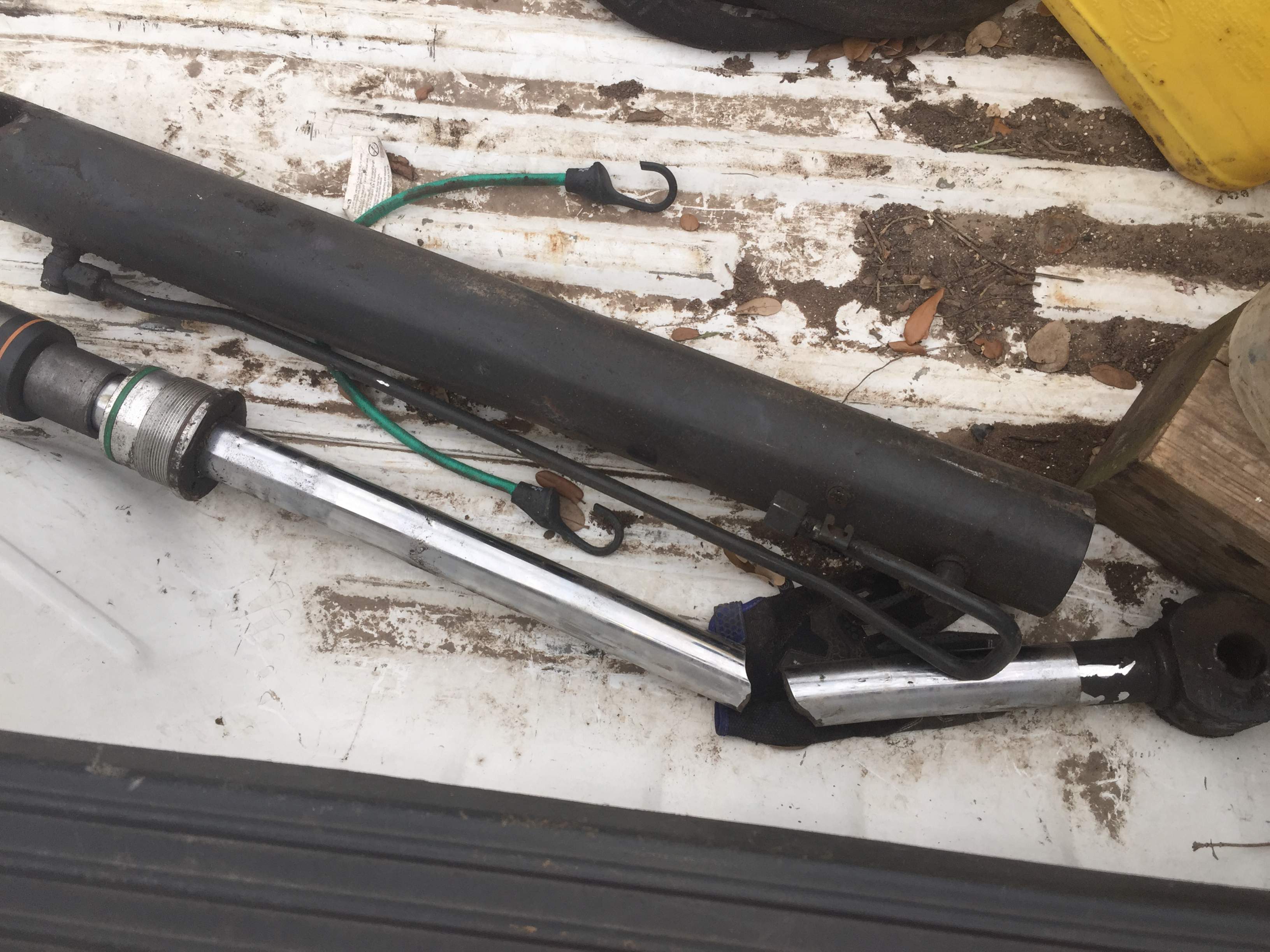

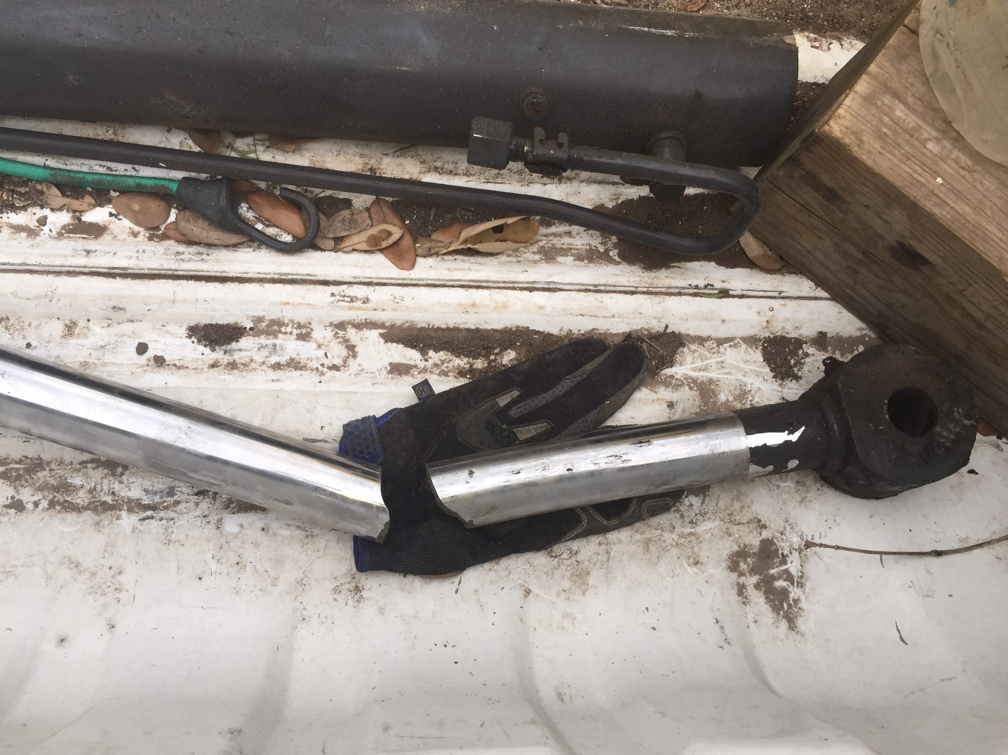

I managed to break the right hydraulic shaft of my bobcat T 650 while using the root grapple. It took about nine days to get it fixed.

Wow. that took a lot of pressure to break.
   / Broken loader arm hydraulic shaft.
Yep was using on side of grapple too much. At least, that was what was theorized.
   / Broken loader arm hydraulic shaft. #4
Boom or bucket cylinder?
I'm thinking it was a flaw in the metal. Bending is the more common result.
boom cylinder.
I use the 82 inch grapple.
   / Broken loader arm hydraulic shaft. #8
On the wider grapples, they can provide some side twist if you catch something the wrong way. I've seen it but I've not seen a broken shaft. I've seen a lot of bent shafts. I'd be thinking poor steel.

It may be bobcat would not warranty the part. They said I hit something to hard
