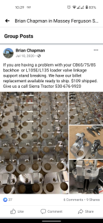

Hopefully the newly designed AGCO part does the trick, but I did finally find someone making replacements out of aluminum. If you're no longer in warranty these seem like a much better bet.
Is that price for 2 plates?

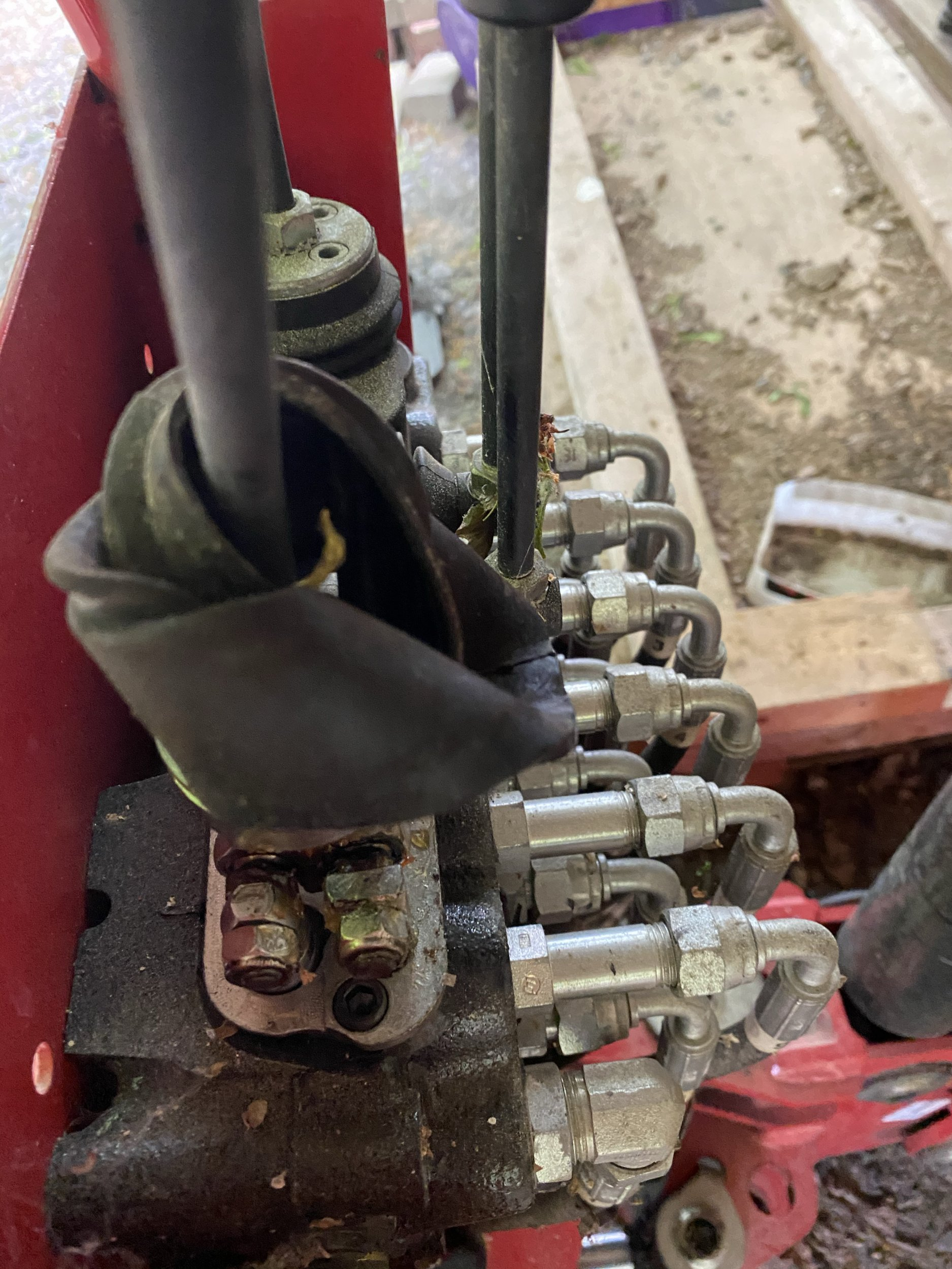

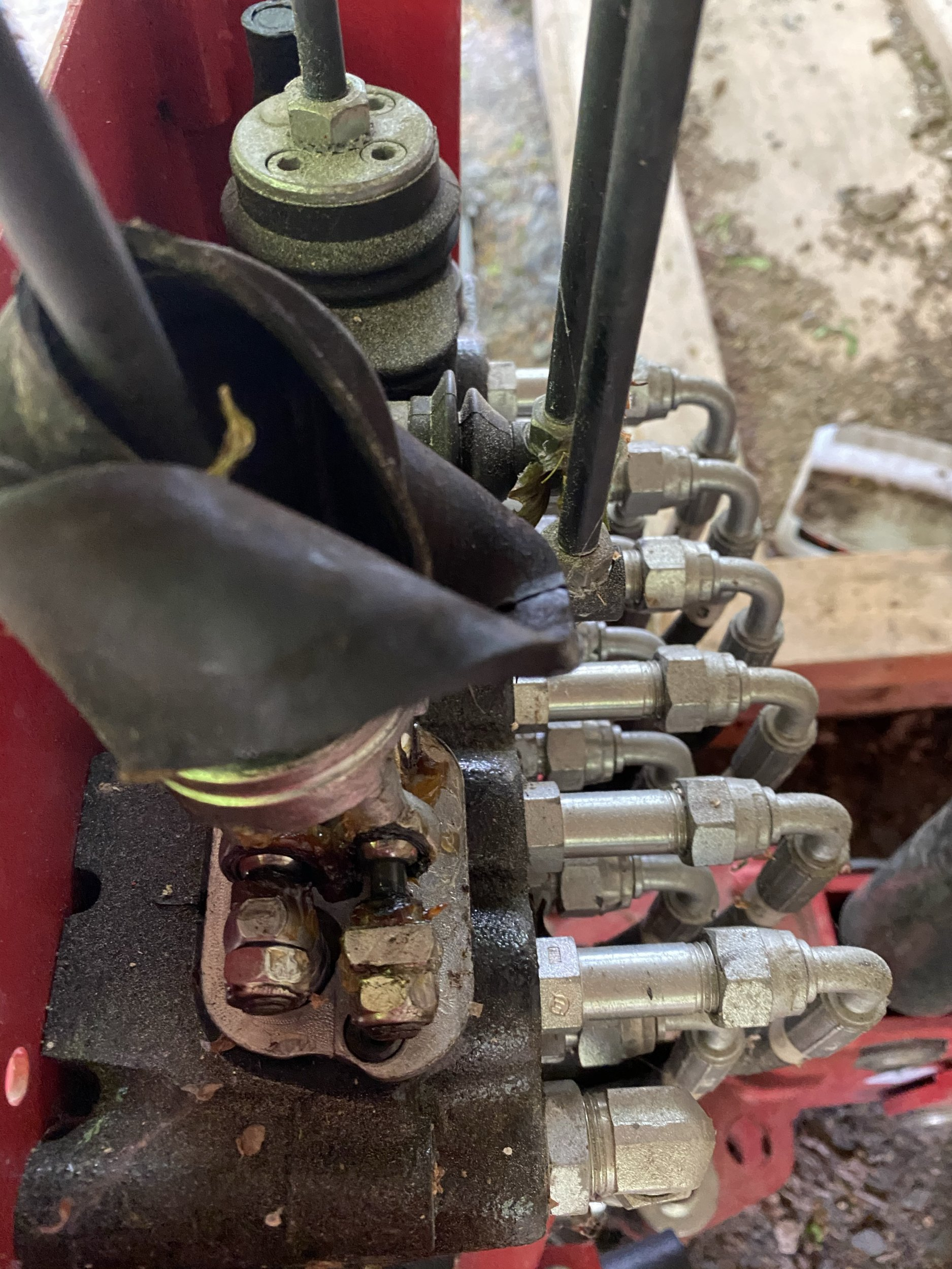

   / Broken Joystick after 10 Hours (GC1725M/CB65) #68
Thoughts, loose or broke?
   / Broken Joystick after 10 Hours (GC1725M/CB65) #69
Figured it out, just loose
