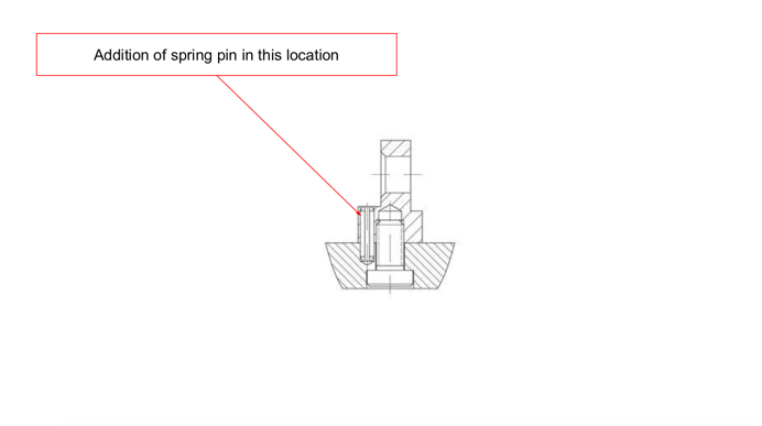

I did hear back from AGCO on the part...
Hi Steven,
This is the answer we received back on joystick from parts tech;
There is a redesign coming, but we now have no solid date for release. So in the meantime,
the best course of action we have had so far is to take one of the old screw type joystick pivots and add a spring pin as shown in the attached. This is only assuming they have an old screw pivot available from a possible past failure. The part numbers are the same between both screw type and die cast type pivots (AL4500022).
(tt/svc) see attachment

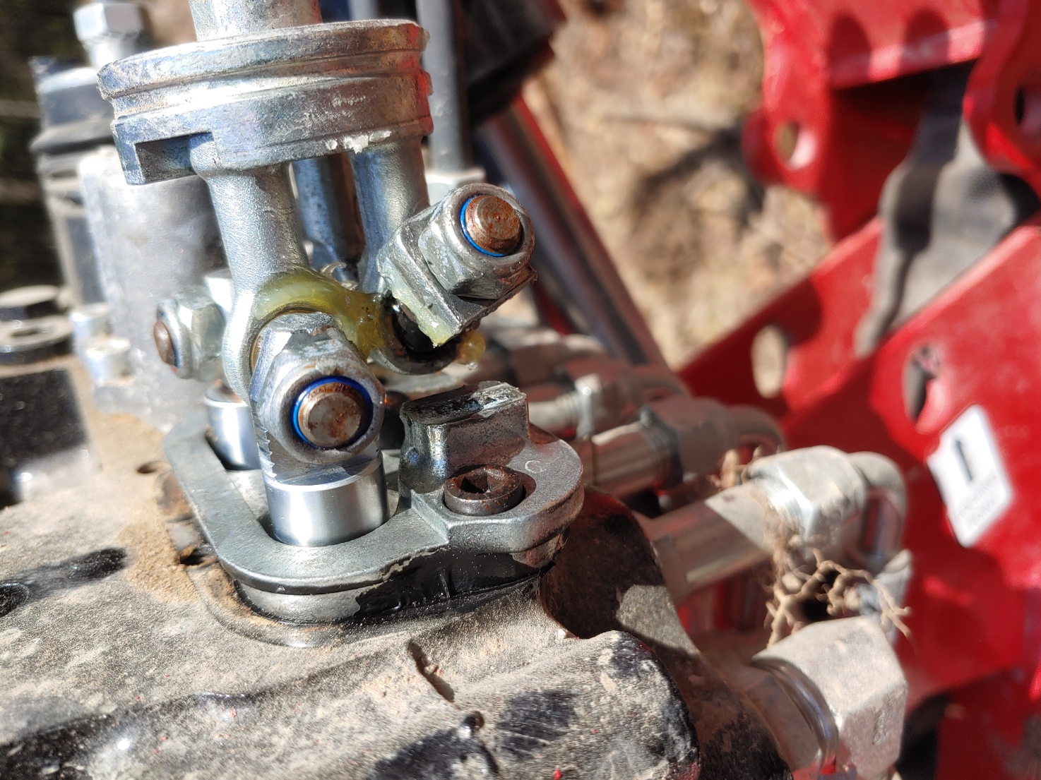

   / Broken Joystick after 10 Hours (GC1725M/CB65) #28
I had the same issue happen to me yesterday. I do not think I was being very hard on it. The dealership ordered a replacement part for me, and hopefully they won't try to charge me. I'm at 50 hours with a a lot of backhoe use so far. Judging by the dark spots, it seems like there is casting issue.

First new tractor purchase that I've ever made and this just happened to me tonight. I have 10.7 hours on the clock. I contacted my dealer and am waiting for a response. Seems to be an inferior part design. Currently worried if they will void the warranty knowing that I determined what the problem was myself.
   / Broken Joystick after 10 Hours (GC1725M/CB65) #30
To follow up with this. My dealer came right out and fixed it. They also replaced the other one as well even though it wasn't broken. They said this is happening to a lot of people. However, they replaced the part with the same one that came out. Not sure if this will resurface in the near future though.
