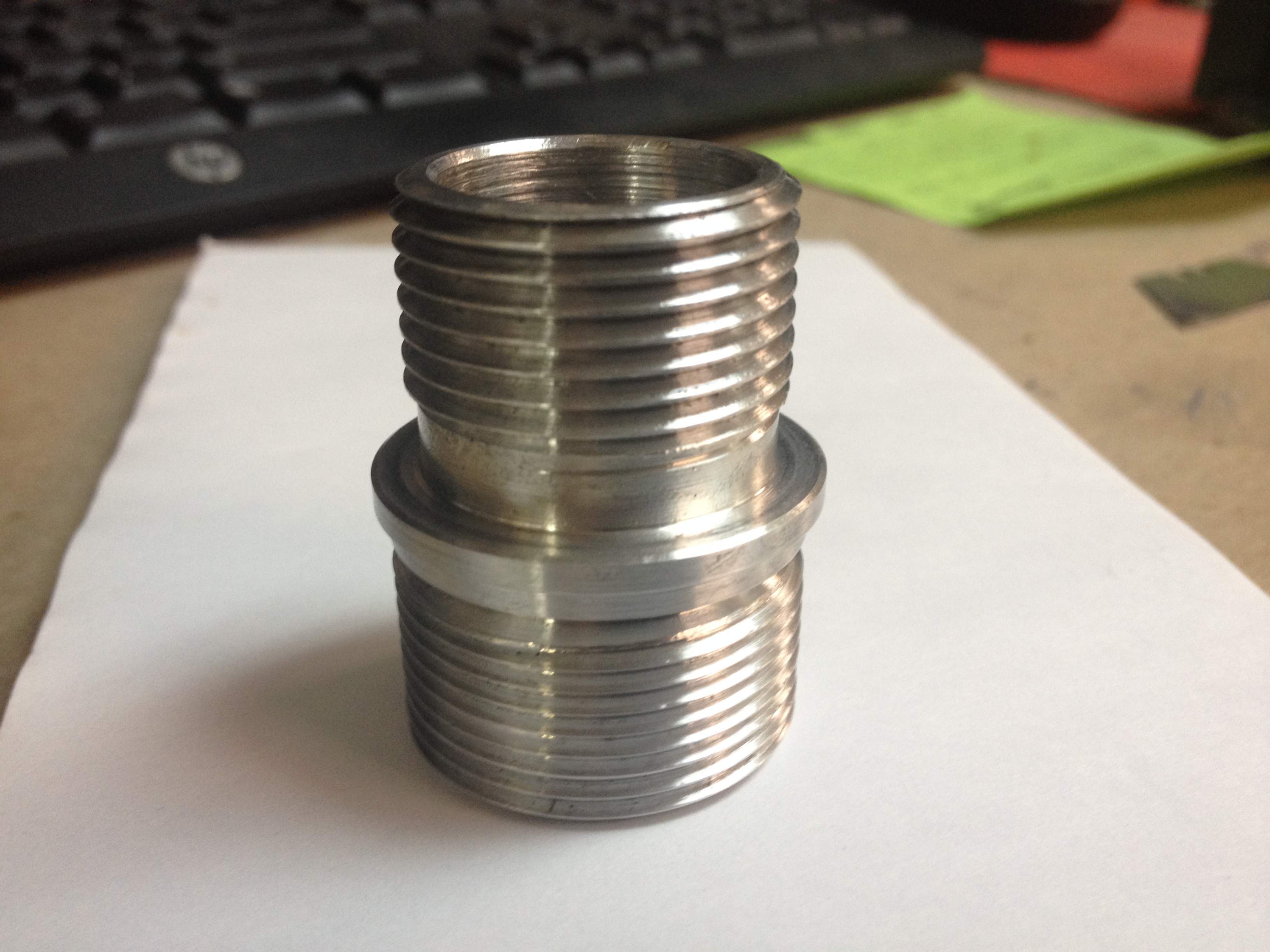

I removed the hoe from my CK25HST today and caught the bottom hydraulic filter. The filter came off with about 1 inch of thread from the fitting. Is this a nipple that can be replace or does the whole fitting have to be replaced. What is the best way to do it?

I think the whole thing has to be replaced. Many here have ripped them off while grubbing which there is so much interest in a belly pan.
   / broken hydraulic filter fitting
You are right MotorSeven. I got it off, 2 screws hold the housing to a bracket. 1 flow bolt, and 2 pressed ends with O-rings. A machine shop could put a new nipple in but the complete housing is $65.00 and shop time would probably eat it up. The biggest expense will be replacing the Hydra-Tranny fluid. Cheers!

I made an adapter to join the filter to the housing. It has a weak spot so it will break off instead of harming the housing. I made an extra adapter so of course it will never break again.
