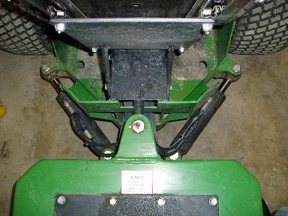

There is no false bottom in the old setup. Here is a pic i took at Power trac of the new 422 set up.

Here is a side view pic of the new 422 stearing cylinder set up.

I see two articulation joints.
I also see what looks like a properly vented hydraulic reservoir cap. Whish our PT-425 had one of those.

looking at the pic of the cylinder where it goes inside some sort of boxedin enclosure , i wonder if this will be a problem when traversing uneven ground ,ie like a pinch point that could also be a problem and i also wonder why they went to the extra trouble to do that .

IMHO (well maybe not honest...) It appears that it was a cost cutting move (certainly not a change for a more robust piece of equipment) and that in order to use the one cylinder the position of the front bracket had to be moved to a stronger location. If you look closely at the fake floor on the new 422 and then at the standard 425 you can see why the fake floor was installed. I always thought that the floor was a bit high and this explains why.
However - I can't imagine that by the time they modified the frame and added the additional parts that they could have save much money /forums/images/graemlins/confused.gif

When I was in Tazewell I know I saw the two sterring cylinders on the larger PTs but never made note that the 1 cylinder models were mounted differently... After seeing these pictures I am amazed how different the two setups are! Not only is 1 cylinder doing the work of two but bringing the "push point" in so much closer to the center must mean a lot less leverage as well. /forums/images/graemlins/confused.gif
