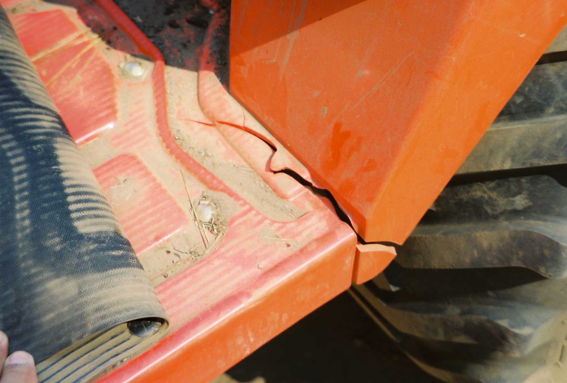

Here is a picture of the break. This will be covered under warranty and Kubota is looking for a lasting solution. In the mean time, make sure you climb on your tractor by placing your foot toward the front of the tractor.

Mine is broke up by the grab handle bolt. It appears that the only support is up at the bolt for the handle. The fender pulls down where yours broke up to the handle where mine broke.
/ Broken Fender / Floorboard #4
JT, my break looks identical to yours. Also a BX24.
/ Broken Fender / Floorboard #5
Do I see things right here, on your picture the fender/floorboard seems to be in plastic? :eek:
/ Broken Fender / Floorboard #6
I'll second that question... a plastic operator's platform? If true it's very dissappointing.

I'm almost positive that the floorboard itself on my BX2350 is metal, not plastic. The fenders are plastic, and seem to be very solid. Certainly more so than the metal fenders on my brothers 1 year old B7510....

The Floor Board is metal, the Fenders are plastic.

I've never seen metal where the color went all the way through. Also I've never seen a metal floorboard that thick. It sure looks like plastic to me.:eek:
Cheers JT
Ok, I see it now. Had to look a little closer at the pic. Now I see the seam where the metal joins the plastic is in about an inch or so from the bottom of the fender. Makes sense that is where it'd break....they're gonna have to stiffen the floorboard up to keep that from happening. Let us know if you hear of a real fix...

I don't know but the crack on the left side still looks like orange all the way through to me to. I can see where the fender comes down on the right. Still looks like plastic but maybe it's a picture thing. Still seems metal might split on a straighter line.

The metal start out where the bolts are. The break is on the plactic.
/ Broken Fender / Floorboard #16
I think we need another picture :confused: . Just to be sure. Am I the only one thinking that bolting metal on plastic isn't right? Metal on metal: OK; plastic on metal: it could; metal on plastic: I don't understand!

The design problem seems to be with the support of the floorboard where the metal flooboard is joined to the plastic fender assembly. If the support problem is corrected, only time will tell if there are other disadvantages and possible advantages in using plastic for the fenders. I'm personally hoping for long term benefits.
