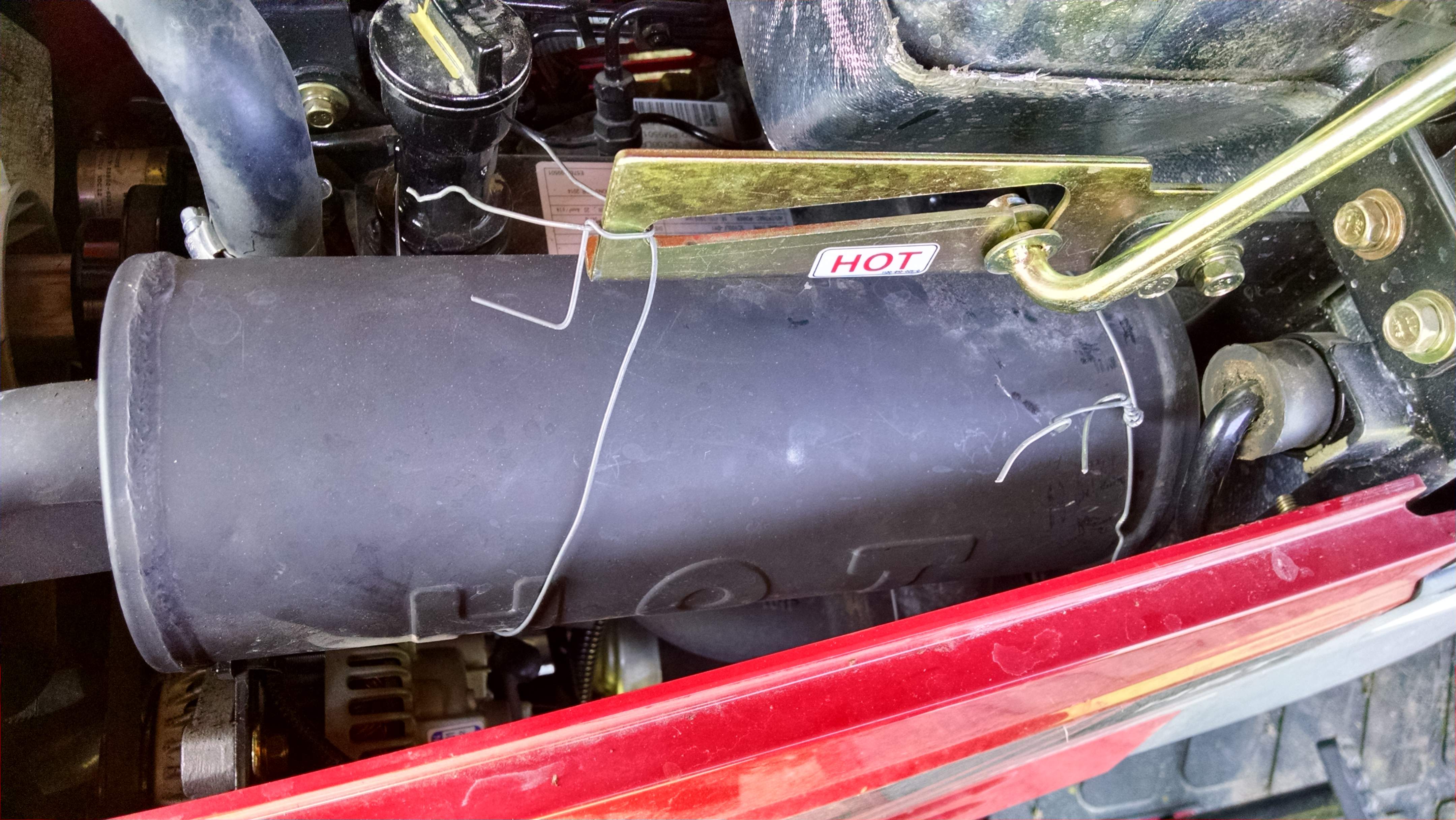

Dealer says musa is aware of the muffler problem and I will have to wait for their engineering solution...and no muffler in stock...anyway dealer is 45 min away and 5 acres of grass keeps growing an inch a day. I wired the muffler down securely in two places - 17 ga electric fence wire - and it stays tight at high rpms. Not happy but otherwise I think the emax was engineered well...hit a sweet spot in the subcompact class. I have not patented this broken muffler fix.
I would request they order another muffler, new design or not. Either that or make sure they're going to repair any damages from the excess heat escaping the break.
I did not order the new muffler ASAP and decided to wait for the re-engineered muffler while operating with a wired down temporary fix. Don't do this! - when it came loose enough for heat to escape, and when I saw fumes coming out like dense steam from the fuel cap (somewhat heat-insulated fuel tank is right next to the manifold/muffler break), I decided that death by fire was an untenable risk and welded it back on myself with extra support for the somewhat violent side-to-side vibration that occurs with this engine below, say, 1500 rpm. I get Mahindra corporate as far as quality assurance - engineer a fix that will solve the problem as opposed to quality control with chasing down defects continuously. I will accept the factory fix muffler as a backup replacement - the downward exhaust low outlet is nice in some ways, but I suspect a brush pile will do it in eventually.

I hate to admit it, but we had a couple of these fail in the last week or so on customers tractors. A muffler ought to last thousands of hours. On all the new eMax tractors we are retailing, we as a dealer are welding in a brace that we think will keep this from happening. Meanwhile we will wait for Mahindra to engineer a solution. It can't be that complicated. What is interesting is that the eMax is the only rubber mounted engine in the line-up. So the engine shakes and vibrates at certain rpms like a typical small diesel, that shakes the muffler. In the other models, the engines are mounted solidly. The benefit to the rubber mounts is that even though the engine still shakes and vibrates like a typical small diesel, the operator is in theory isolated from some of that vibration. But the muffler isn't. I think a lot of the SCUTS are made this way. I think larger tractors have enough mass to dampen the vibrations so rubber mounts aren't needed.
Word I got from my dealer is that Mahindra has engineered the fix but they have to wait for the EPA to test it, since any change to a tier 4 engine requires retesting. Might be a while. Sounds like most dealers are putting on braces to keep their customers going, but the whole system will be replaced when the fix is available.
