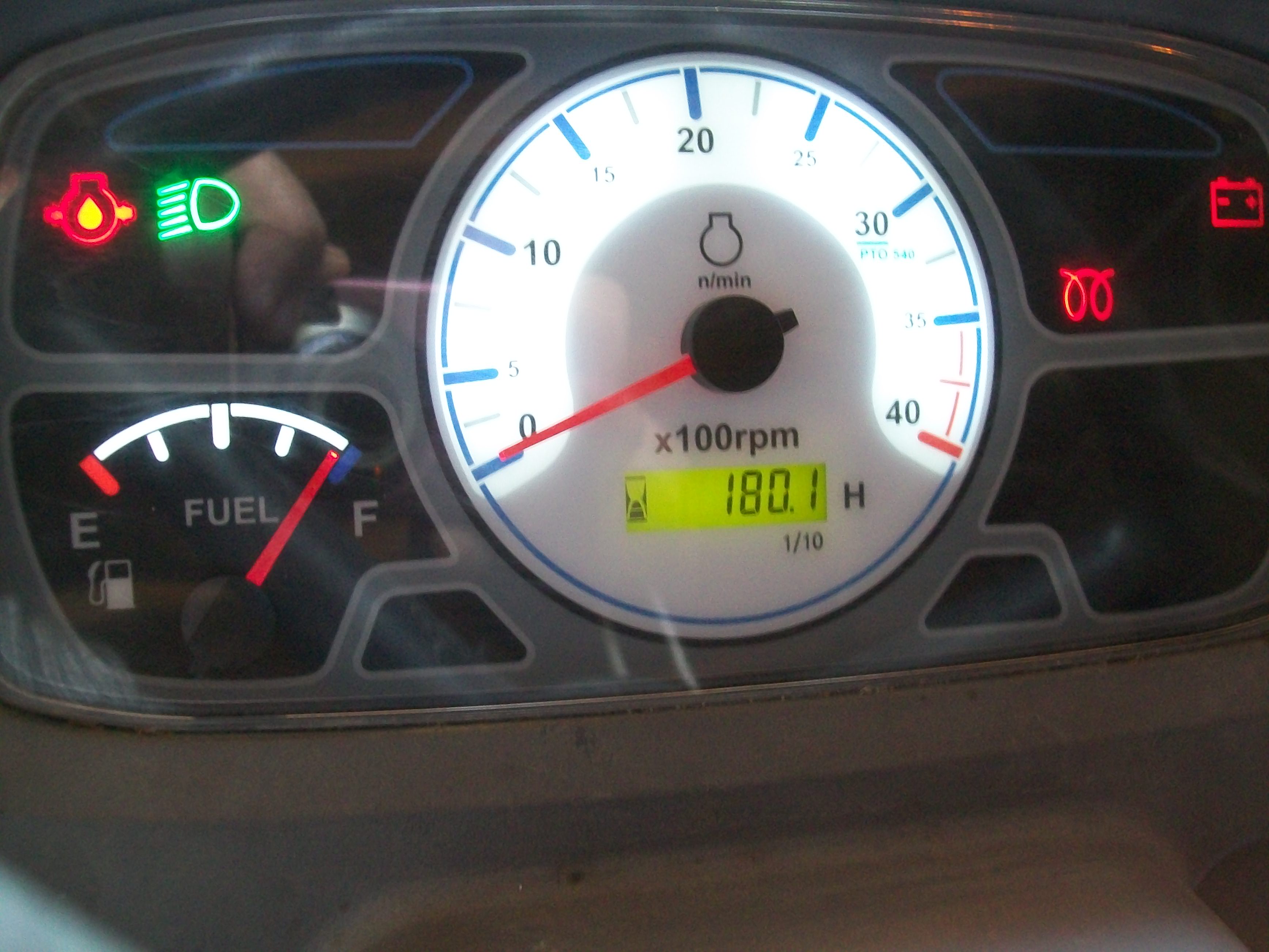

Broken muffler #2 today, of course after hours. I am going to call them first thing tomorrow. Just clicked over 51 hours. Hopefully they will be as responsive and accommodating as they were when this happened the first time. Fingers crossed.

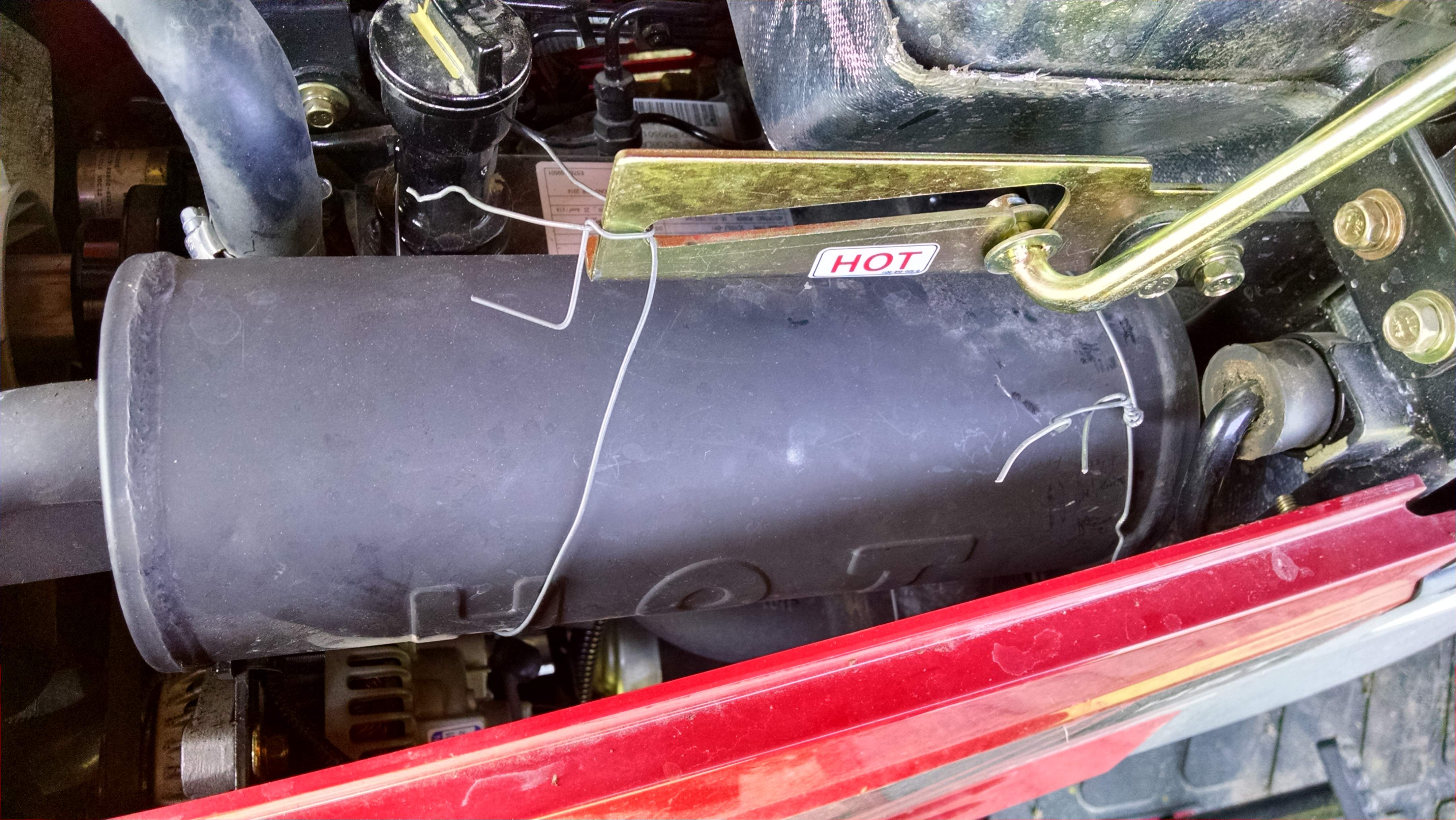

Dealer says musa is aware of the muffler problem and I will have to wait for their engineering solution...and no muffler in stock...anyway dealer is 45 min away and 5 acres of grass keeps growing an inch a day. I wired the muffler down securely in two places - 17 ga electric fence wire - and it stays tight at high rpms. Not happy but otherwise I think the emax was engineered well...hit a sweet spot in the subcompact class. I have not patented this broken muffler fix.

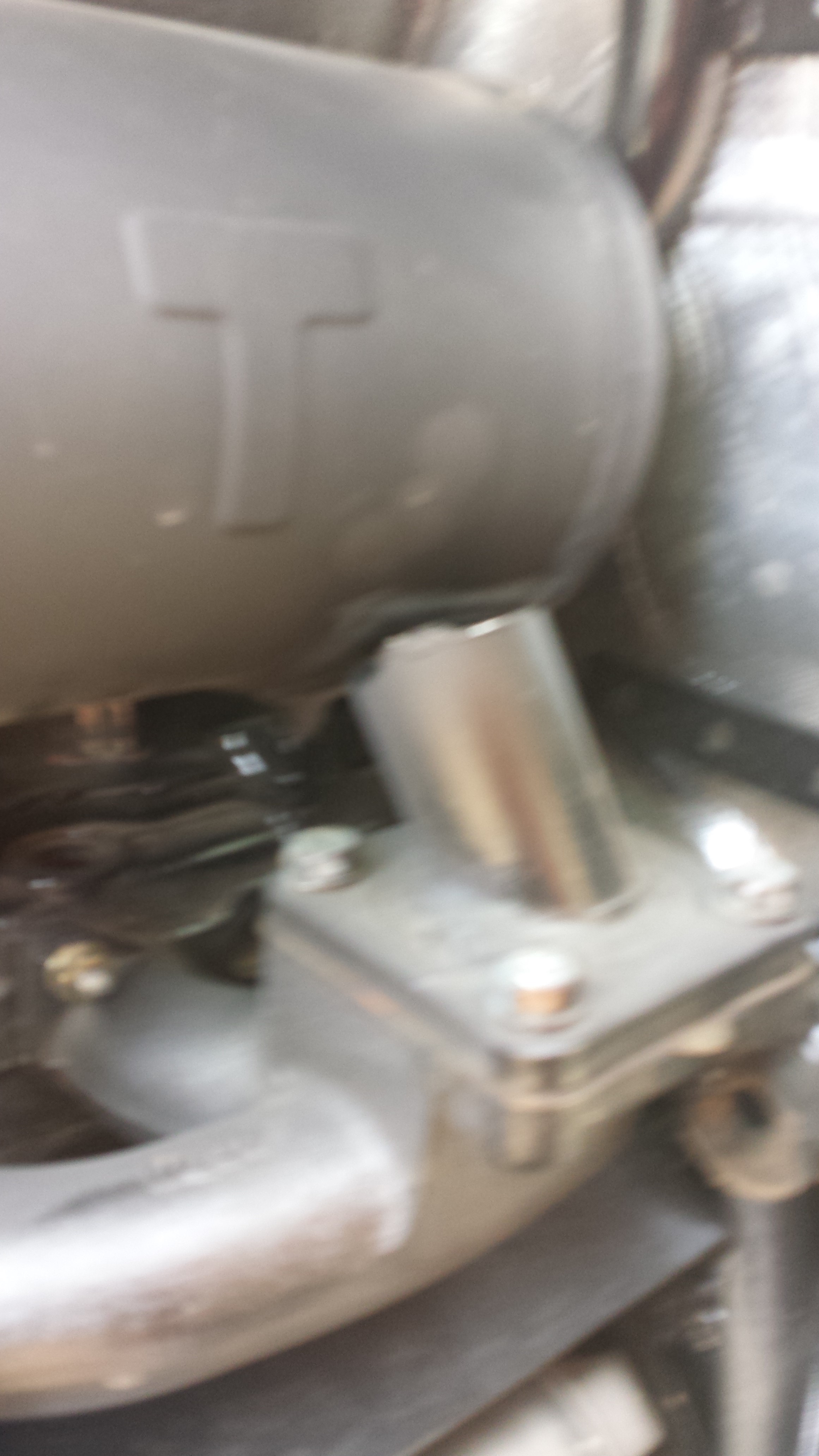

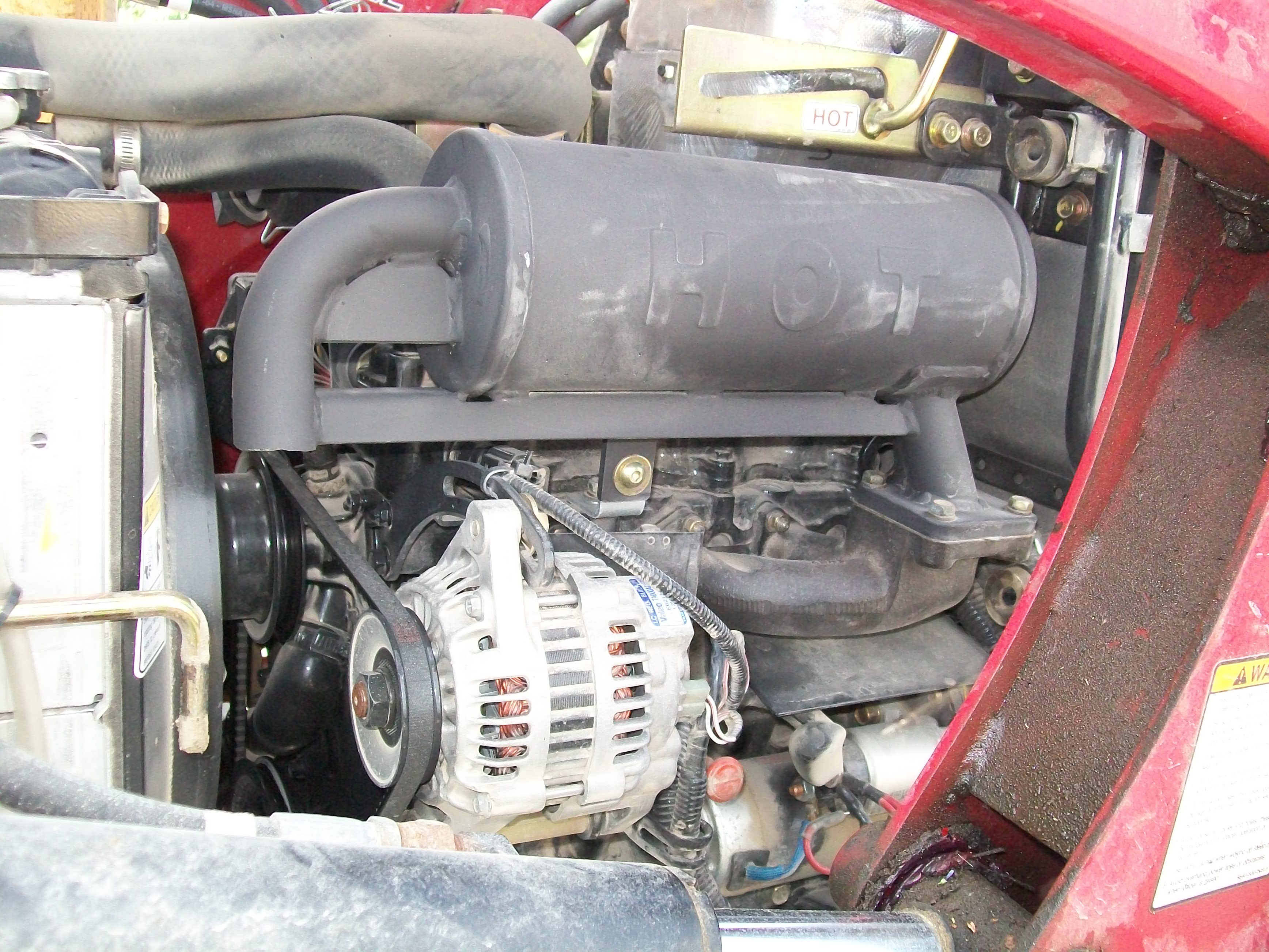

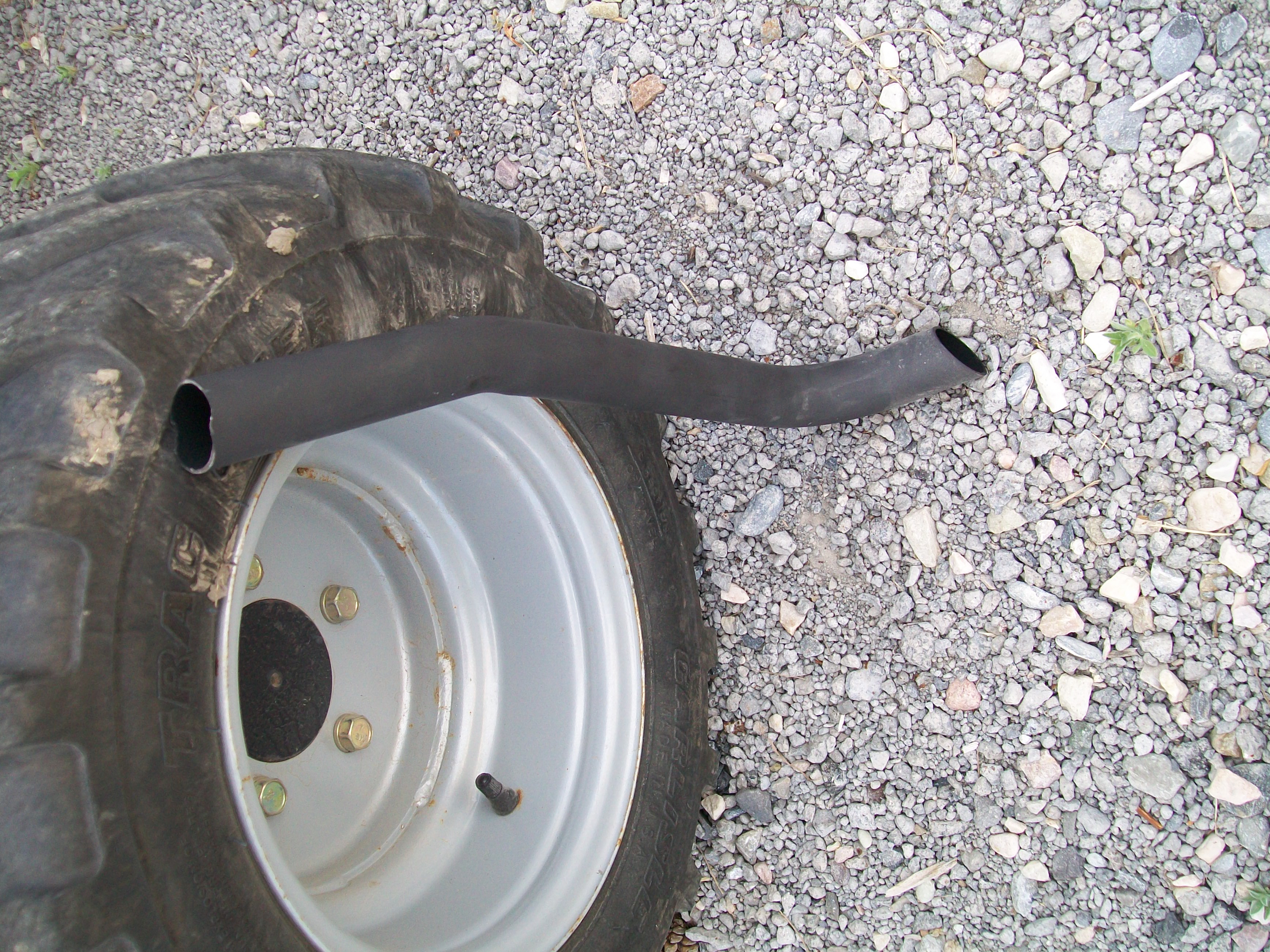

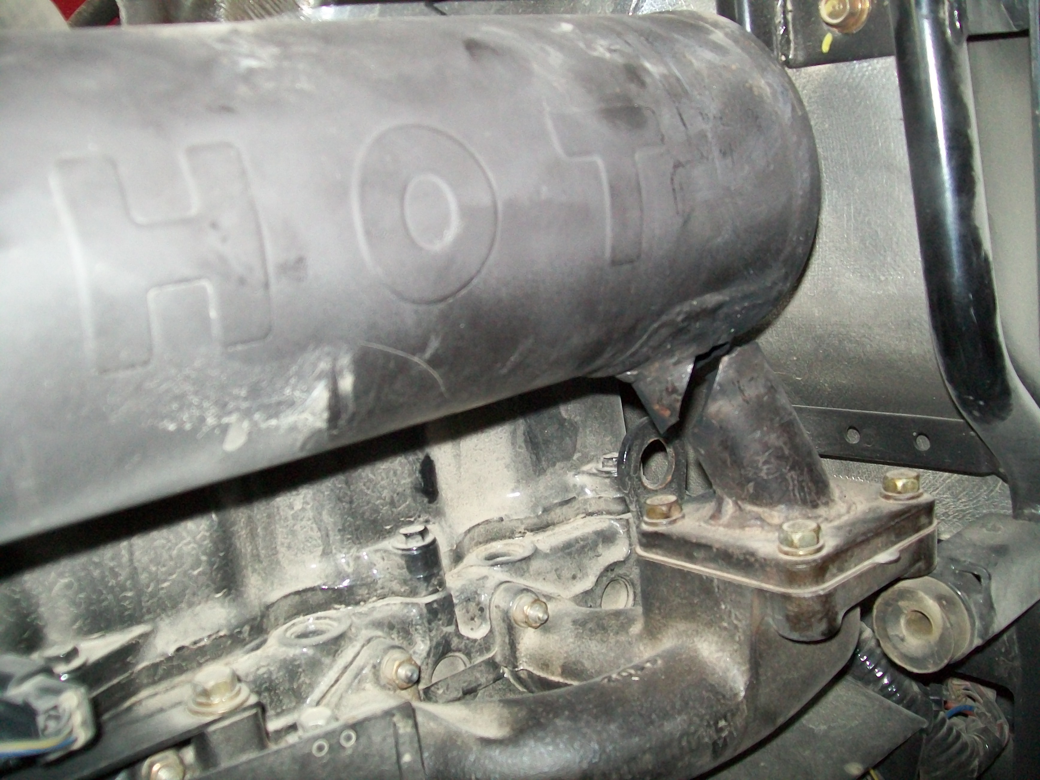

broke_muffler1.JPGbroke_muffler_1.JPGbroke_muffler_2.JPGbroke_muffler_3.JPG.
I have an EMAX22GEAR I bought new in February of 2016. The first year, the loader bucket cracked and they replaced it. Last June, the original muffler failed where it attaches to the engine (first pic). Mahindra replaced it with their new "redesigned" muffler (2nd pic). After another 30 hours and 11 months, the pipe coming from the muffler just fell off (pic) These little engines just shake things apart. I'm concerned that I'll have trouble with this thing for years.

There is really no excuse for the muffler failures. But there is a way to keep it from happening, or at least drastically minimize it. Raise you minimum idle a bit and the engine smooths out. When you idle down, keep the revs up a couple hundred RPM. Rubber engine mounts are pretty common on ladder frame tractors. I suppose it is to isolate the vibration from the operator...but it sure doesn't isolate the vibration from the muffler. I'd ask Mahindra to supply you with another muffler and then keep the idle up.
