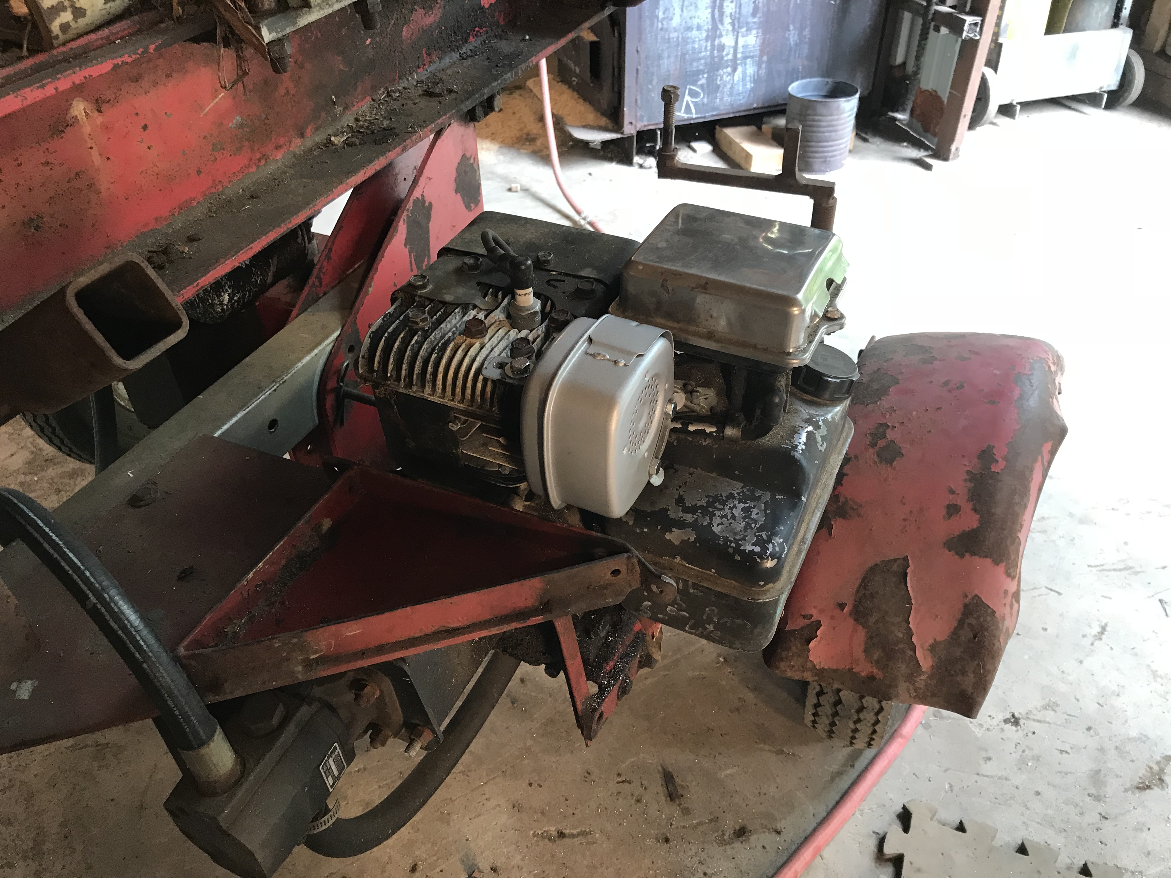

I got it, only took me 5hrs to do this muffler job, your right that was fast. I tried the bolt on washer trick on this last one, wanted to try the wax trick to to prove that wouldn't work, but the wife went shopping before I got going and I didn't feel like turning the house upside down looking for it. So I welded the washer on, then a 3/8 nut on that, waited for the red glow to go down then I tried to turn it. It was a no go, peeled out a 16th below surface.
So back to the backwards drilling, 1/8 then 3/16 then the forward 13/64 bit, then tapey time, side notes>>>(be careful tightening drill chuck with drill key when air hose is plugged in, ouch) and when/while drilling hole, watch from 3 different angles so end result is a straight hole @90ー from motor block)<<That last hole is half a air off from perfect but the muffler bolted on, with a little might not Never Seize, I put it back together, so Yippee ki-yay and drinks all around, I'll send myself the bill next year for this muffler job.
