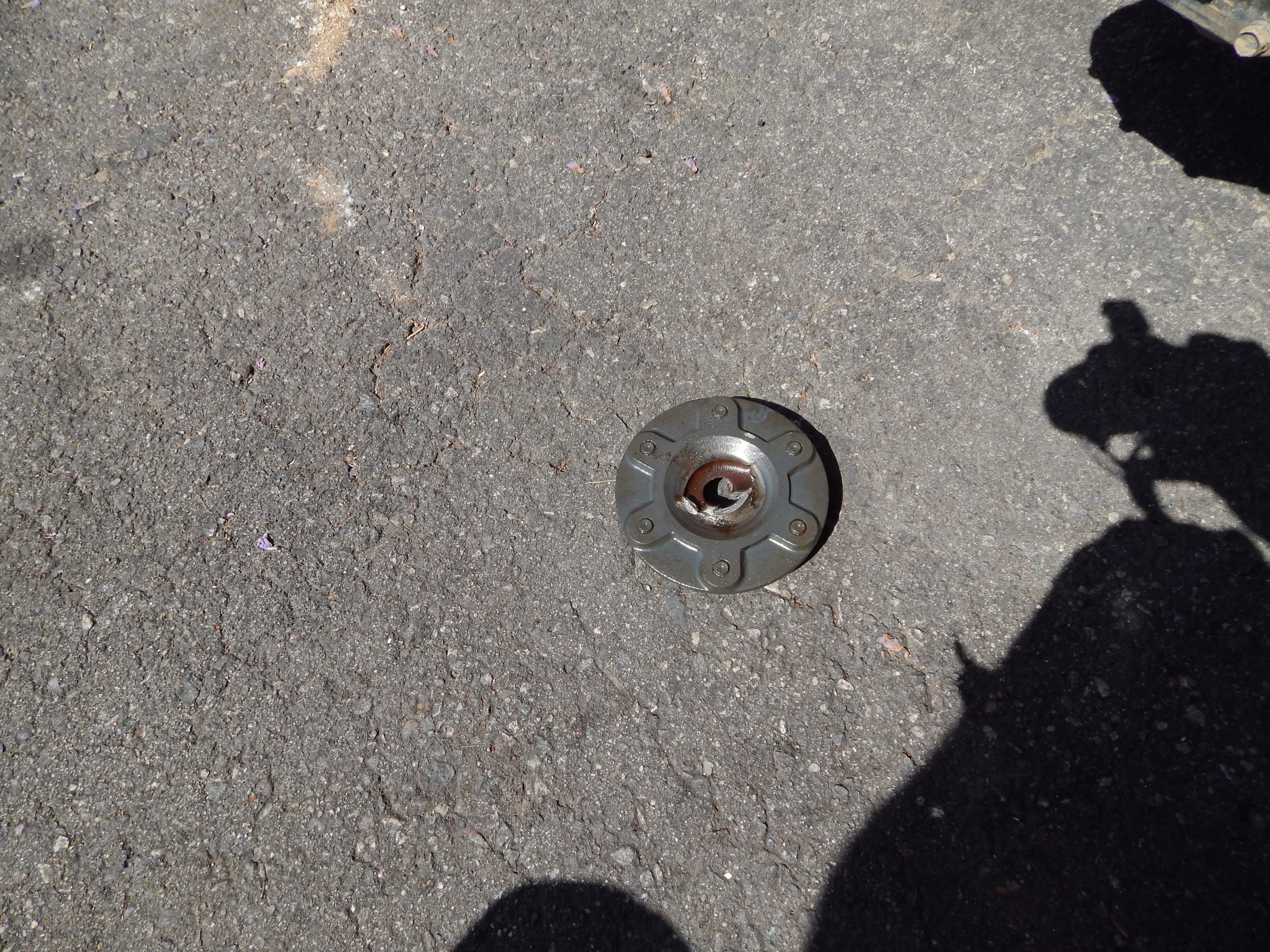

I just turned over 1000 hrs on my B7800 so I serviced it all up and put a new pair of front tires on it and took it for a spin to make sure everything was ok. I had the mower on it so I went chasing mustard weeds and at the bottom of a slope I turned right and heard a terrible crunching/grinding noise as the front end dropped.I looked and saw the left front tire and wheel flat on the ground under the place where it was attached moments earlier. On inspection I found the flange the wheel bolts to had broken off the axle and on closer inspection found that only about half of it had ever been welded together. I have no idea how it lasted 8 years and 1000 hrs after some of the stuff I've put it through. At first I thought I must have messed up somewhere but I torqued the wheels to spec and everything else I did was fine so I just can't take credit for this one. DSCN1602.jpgDSCN1599.jpgDSCN1596.jpg

Was it welded together when manufactured, or are we really looking at a machined part that cracked and then later completely failed? From the rusty part vs the clean break, it looks like you had a hidden crack for some time. The good news being that you were not in some sort of a precarious position with the loader in the air and turning or something like that when it failed. With a new part, that will be a quick fix. Tractor will be fine, you are fine, etc. Check the other side....
/ Broken axle #4
I'm not sure, but that should a solid casting, not two pieces of metal welded together. Looks to me like it had a fault from the get-go.
Either way, I would take it to the dealer whenever you order the new one. I'd want the factory rep to see that one.

I'm not positive but I think they are two different metals and the part of the flange that was never attached looks to be molded with a kind of cup shape and the clean part of the axle looks molded too.It's a real puzzle to me. I would prefer to order from Messicks as the local parts guy is a jerk but I might make an exception this time. I have another day to think about it with the holiday tomorrow.

I've been doing some research today and found several other instances of this axle breaking and they all look like mine so I am sure this is a manufacturing flaw,just too many to be operator abuse or accident.I spent 35 years operating heavy equipment so I know the difference between use and abuse.This issue reminds me a lot of the" silent recall " Kubota did with their poorly designed seats except this has the potential to be a serious safety issue. I have no expectation of them stepping up on this and will just bite the bullet.

Ok I called Messick's yesterday and after explaining my situation they connected me to Les in their technical dept. who called me back this afternoon. He said that he had gone back as far as he could in both their records and Kubota records and could not find any different part number for the axle.So he can't say that it has been upgraded or not.I ordered one and the seal and will look at it when it gets here and if it appears beefier I'll order another and if not I'll probably get rid of the tractor.

I got the new axle today,thanks to Messick's for the great service, and the only obvious difference between it and the broken one is the lack of paint on the new one. This is good ,I guess ,as I could see any cracks on the outside, but that's not where the problem was.I'm glad I only ordered one and hopefully the other side and this new one are not defective.
I don't want anything to do with the new EPA mandated machines so I will just keep this one and not use the loader for anything over a couple of feet off the ground. This axle was used on the B series from the 2710 to the new B26 so I would say buyer beware.

Differences could be in the material itself, the way it was cast, the way it was machined, and perhaps any heat treating or hardening. It would not necessarily need to look beefier to be stronger. Just for safeties sake though, I would take a good look at the opposite side and look for any signs of a beginning of a crack. I suppose you have already done this. I think you are good to go, and we wish you well.

One other thing,if you break one of these and have the threaded studs,they fit the new axle. The parts diagram says to replace them but I think that is referring to some of the older models that had press in studs. Gotta save a buck when you can.Just double nut them to remove and replace and you're good to go.

I got the new axle installed,waited 24 hours for the silicone gasket material to cure then filled it up and did some mowing.Seems fine, with no leaks,so I'm back in business. Looking at this after doing as much research as I could I would say the design change was going from pressed in studs to threaded studs and this was done before my tractor was built.In looking at pictures of other failures here on TBN there was one axle that appeared to have been properly welded but mine and all the rest were only welded about half way around the circumference of the axle.This makes it a quality control issue rather than a design flaw. If someone had shown me my axle and said it was out of an imported tractor I would have smiled and said "That's what you get when you buy Chinese".I have lost a lot of respect for the brand.
