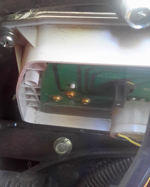

Dealer contacted yesterday, supposed to stop by today and take a look. Suspects sending unit. Waiting on him now.
   / Broken already!
#14
Dealer just left. No connection to sending unit. May have to take it in, they do that if needed, no charge. He wants to check wiring diagram to see how much disassembly is needed first.

   / Broken already! #18
There are three screws that attach the mechanical part of gauge to printed circuit board, all three of mine were loose... No gauge reading, little short stubby phillips screwdriver snugged them up all is good....
Little man in Indonesia (where my 1715 was assembled) took rice break...
Dale
Youæ±*e a genius! One screw was very loose, tightened up and have my temp gauge back!
