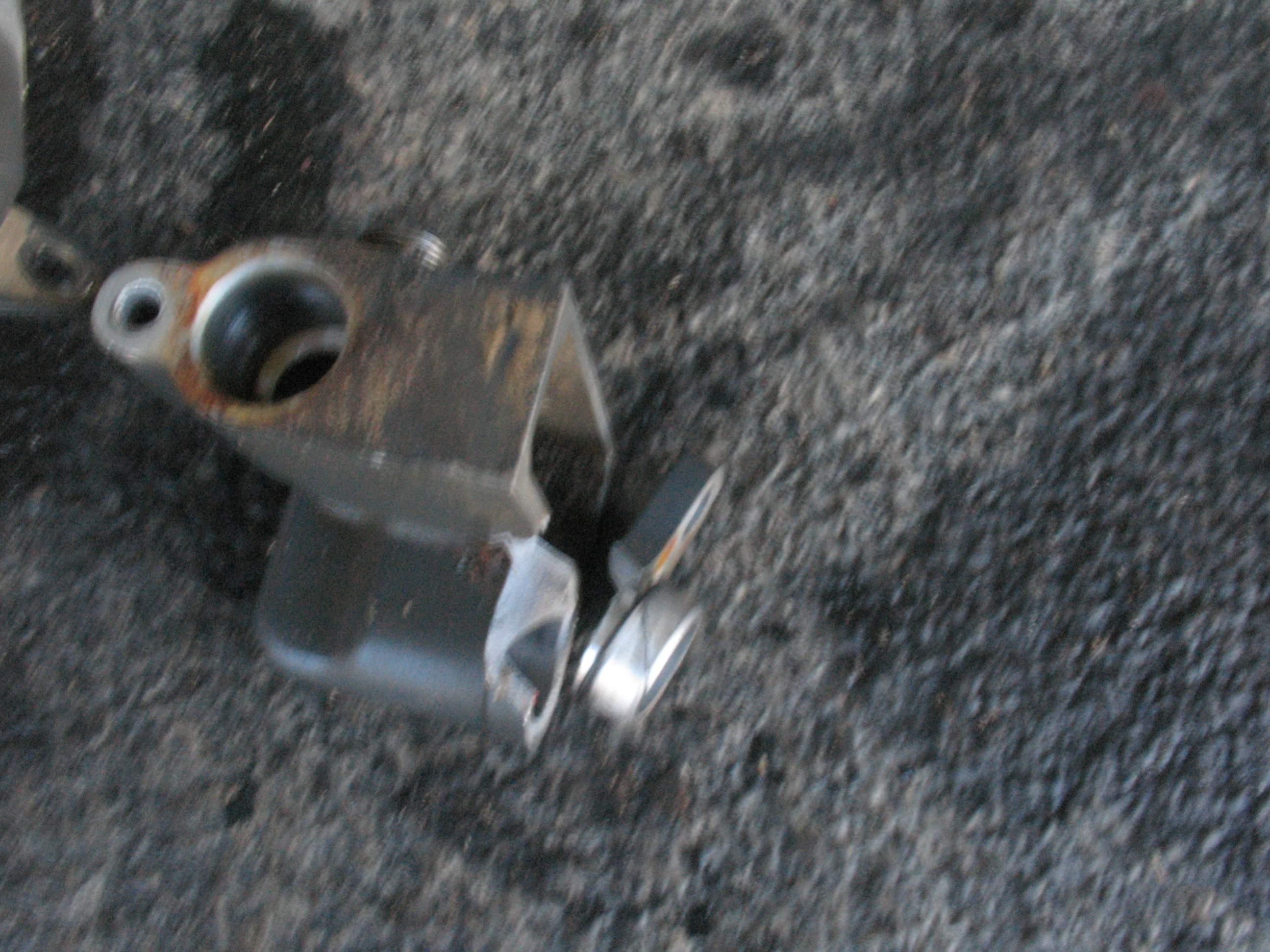

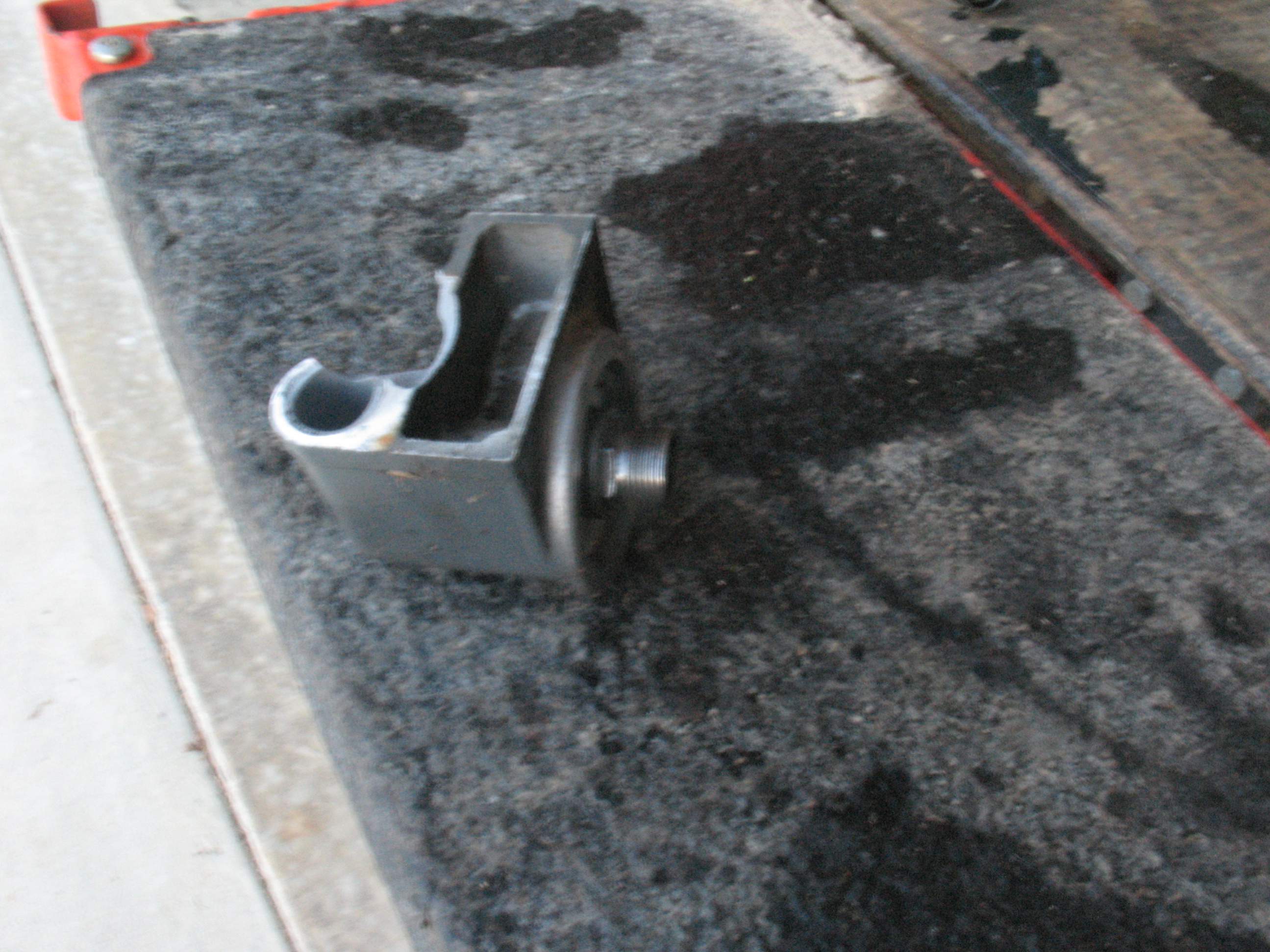

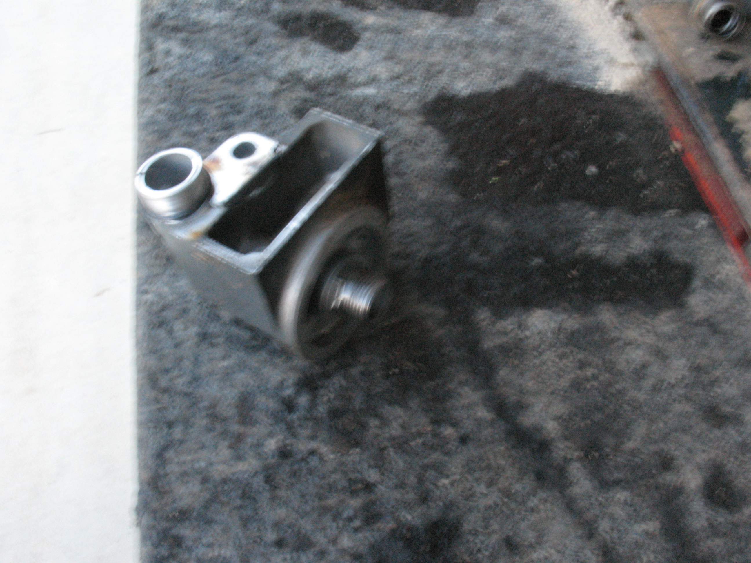

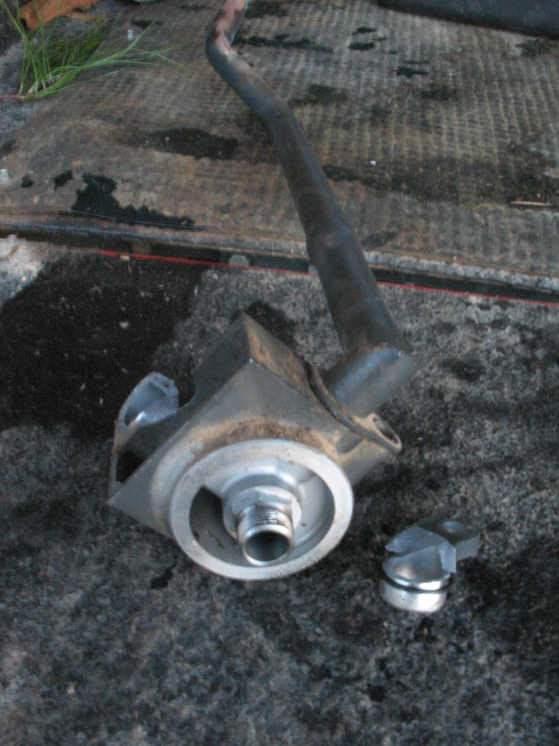

Well finally got the darn computer to work. The third photo is basically how it set into the tractor hydraulic reservoir with o ring seal held in place by one bolt, then the suction line sets on top as shown in 4th photo with o ring seal and the same one bolt. I have to install the suction pipe onto the filter housing then work that crooked son of a gun up thru all the other lines to push it into a rubber hose connection with a hose clamp. I guess you don't need much to hold a suction line
   / Broke my B26 today #12
I got the parts ordered,(not in stock of course) $50 filter housing, $30 for the filter, $4 for 2 O-rings
got some photos of the cast aluminum housing and ridged pipe connection. Something is wrong somewhere cant get the manage attachments to open up. I'll try later to put on some pic.

I might could be welded but likely would cost more than a new one. Aluminum welding isn't cheap. I have the foot on my outboard motor welded and it was a simple straight weld and it was $100. This would require some careful welding and then some machining to get all the excess metal of or out of the suction side. At least getting it off was a piece of cake once I got a socket extension of the exact needed length, 3" was too long and 2" was too short, luckily I got my swivel joint to fit on to take out that first bolt. The tractor is over a quarter mile from my house so of course I didn't take a Phillips screwdriver to loosen that on hose clamp or nut driver to take off the other one.

I got all my parts yesterday and started trying to reinstall everything. Pretty tricky snaking that steel pipe back up thru everything and no matter how I put it in place I couldn't qet it in place without being in a bind somewhere. I may have been bent a bit from the collision that broke the filter so I will just have to tweek it a bit if I ever get it all back together. I worked at it for over an hour trying the get the tube inserted into the hydraulic reservoir and get the holding bolt to start. Not a lot of room to work the fingers or any tool in there but finally got it to slip in most of the way and got the bolt started then couldn't find my ratchet anywhere and couldn't get the tube next to the pump to slip in without some heavy prying and then it started to rain so I had to abandon the fix for now. It is still raining today and supposed to rain all day. Tomorrow is supposed to be sunny but cool so maybe I can work on it then before I leave for Christmas holidays.

This morning I went back to the B26 and finished up the install of the new filter housing and attached the ridged pipe to the hydraulic pump, put back the oil (got it a little over full and will have to let some out) everything worked as it should and was able to put my baby back in the shed. Removal of a quart or so of oil will have to wait for a warmer day. That reservoir is weird, it wasn't even touching the stick and put in a gallon and oil started running out the dipstick hole. It went down a bit when I cycled the system and the new filter filled up. Sure glad that is over.
