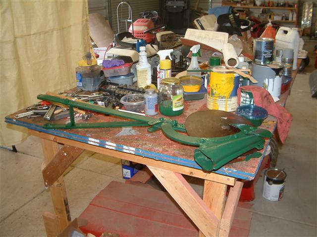

If using a drill, has anyone had trouble with the mechanical ones getting blocked up either partially or fully when drilling soft ground? Does anyone use an air drill to eliminate this?
/ broadcaster vs seed drill #14
I've never used my old Minneapolis Moline P3-6 drill in really soft ground.
Here's a photo showing the single disc opener, drop tube and the boot that accommodates the end of the drop tube. There's a scraper blade on the disc to remove any sticky mud. The end of the boot is raked backward to minimize dirt scooping at the bottom end of the boot.
There's also an adjustment on the arm that carries the boot so you can raise the bottom end if you think the boot might get clogged.
A fine example of early 20th century grain drill design:thumbsup:

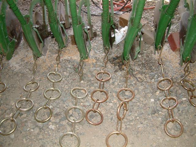

I just over seeded my front lawn with our old John Deere Van Brunt 14 drop Model B drill...
So...
I am partial to drills...
As others have said...
Better germination...
But finding a decent older unit at a fair price can be challenging...
Just as an aside...
Deere still keeps some parts available for those old units in stock...
I just purchased a tension spring for ours...
