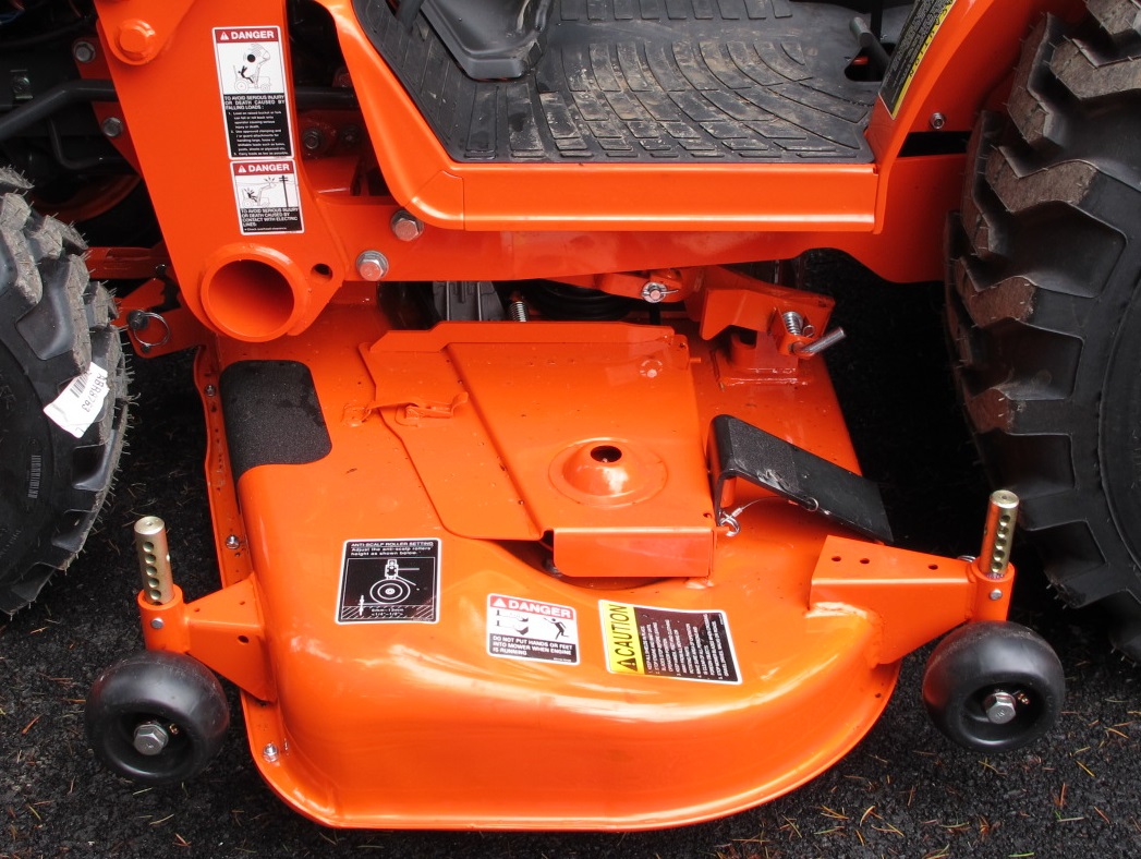

Howard92, I also have a B2920 and wanted to add rear wheel spacers for the stability issues. When I checked with my Kubota dealer he said Kubota offers 1 1/2 inch spacers but in the footnotes of his book it states that the spacers are not recommended on a 2920 if you also have a MMM. Apparently the concern is the spaced out rear wheels interfering with the rear wheels on the MMM. When I checked with Bro-Tec they said they had not heard of the issue. As you know the spacers are not cheap and I hesitate to buy them if I have to remove them to use the MMM.
Do you have a MMM with your machine and is there an issue with interference?
   / Bro-Tek 2" Wheel Spacers for our B2920 Kubota
I have read the same posts about interference problem with rear wheel spacers and a MMM. I can't answer because I don't have the MMM..... but I would think that a couple of hours with a cutoff wheel, a mig and a can of Krylon could move those rear mmm wheels over a bit and out of the way.
