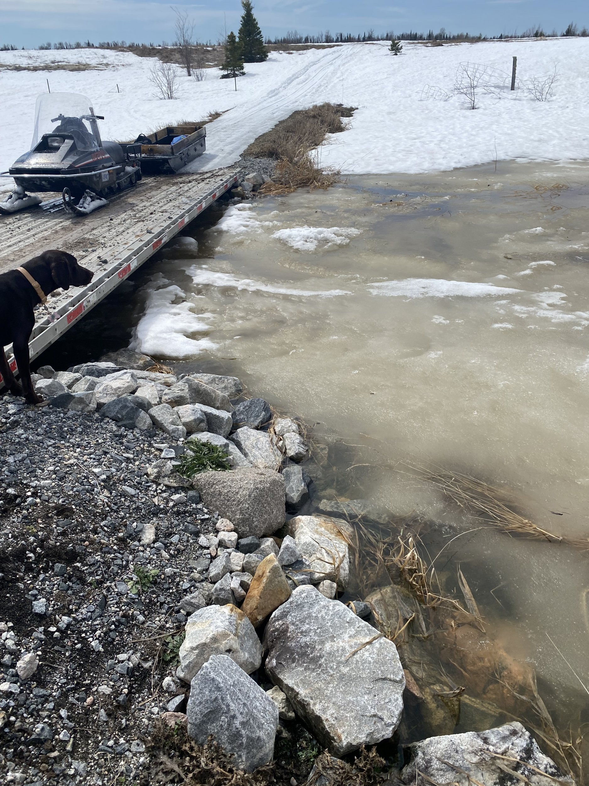

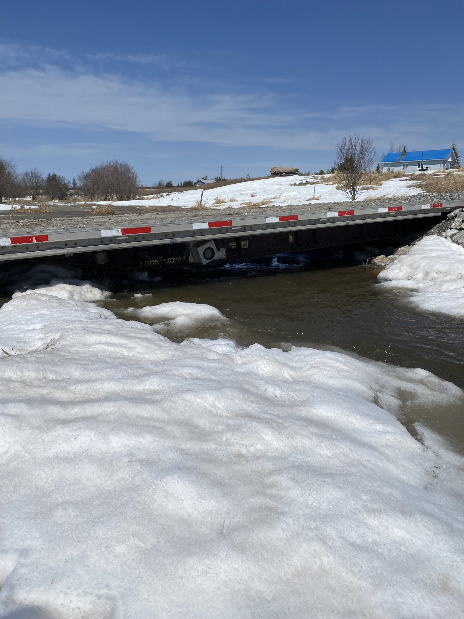

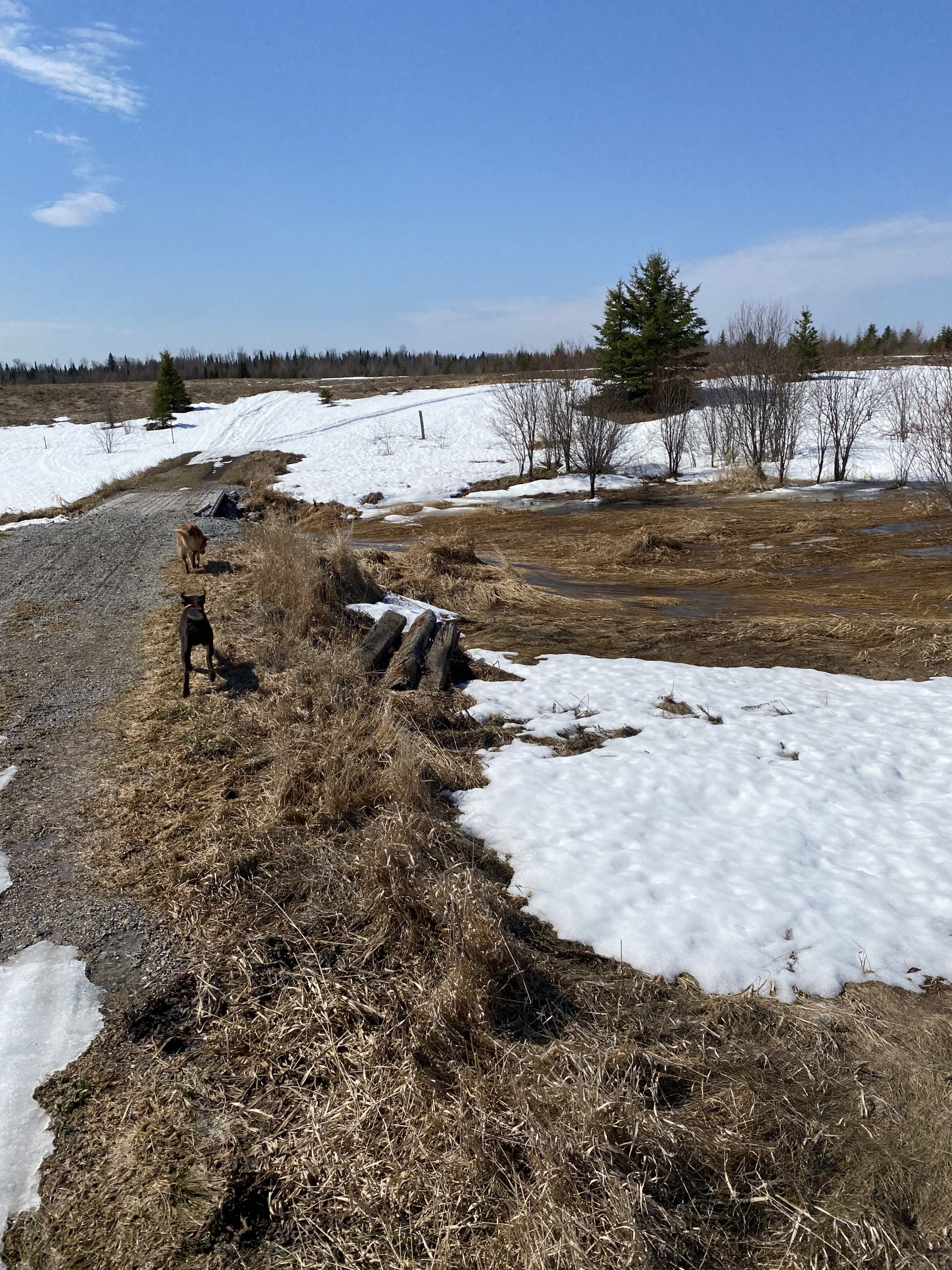

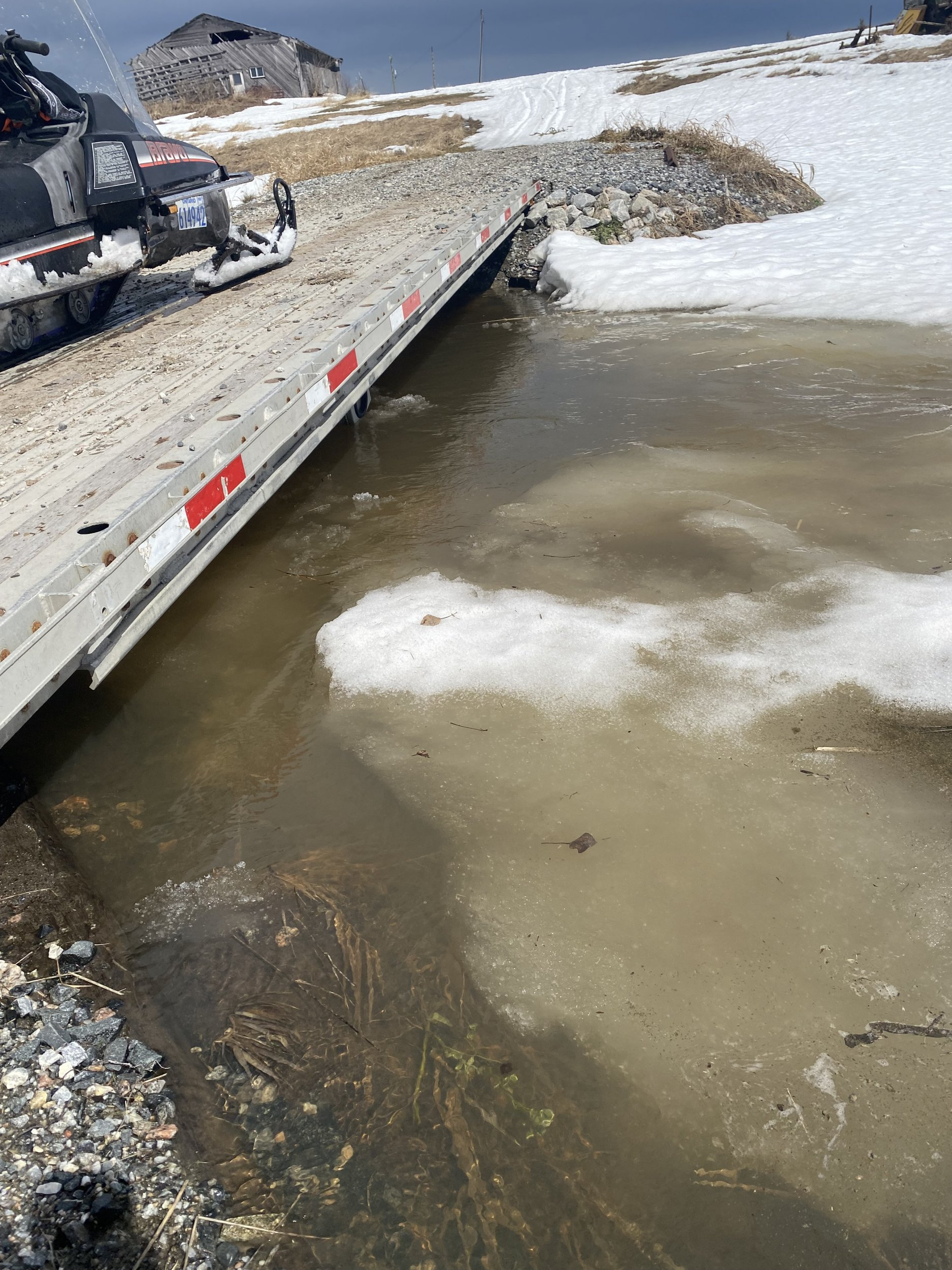

well i am happy i got that many rocks and glad it is has high as it is … all the snow melted in 5 days it dissolved crazy fast this year.
