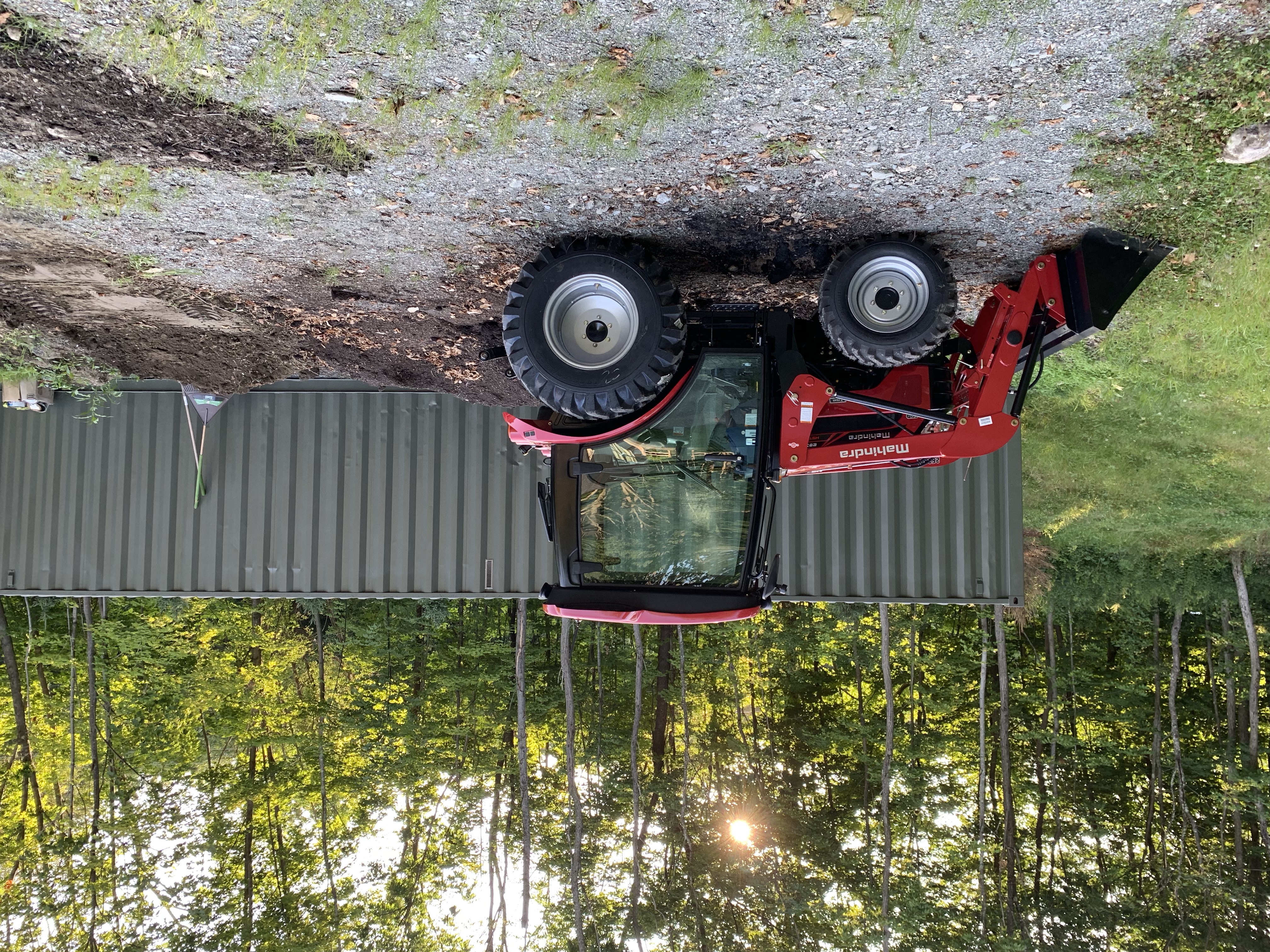

Not sure why photo is upside down, and tips on that appreciated as well. View attachment 615600
Love the 4 cyl engine it actually has more cubic inches than my 2660 and the 60 is a 3 cyl turbo would have liked a non turbo because i dont like setting there when i get thought idle the engine for 3 to 4 min according how hard i work the tractor to cool down the turbo . I think you can correct your pictures by always having the button you mash to snap the picture in the right hand , try that.

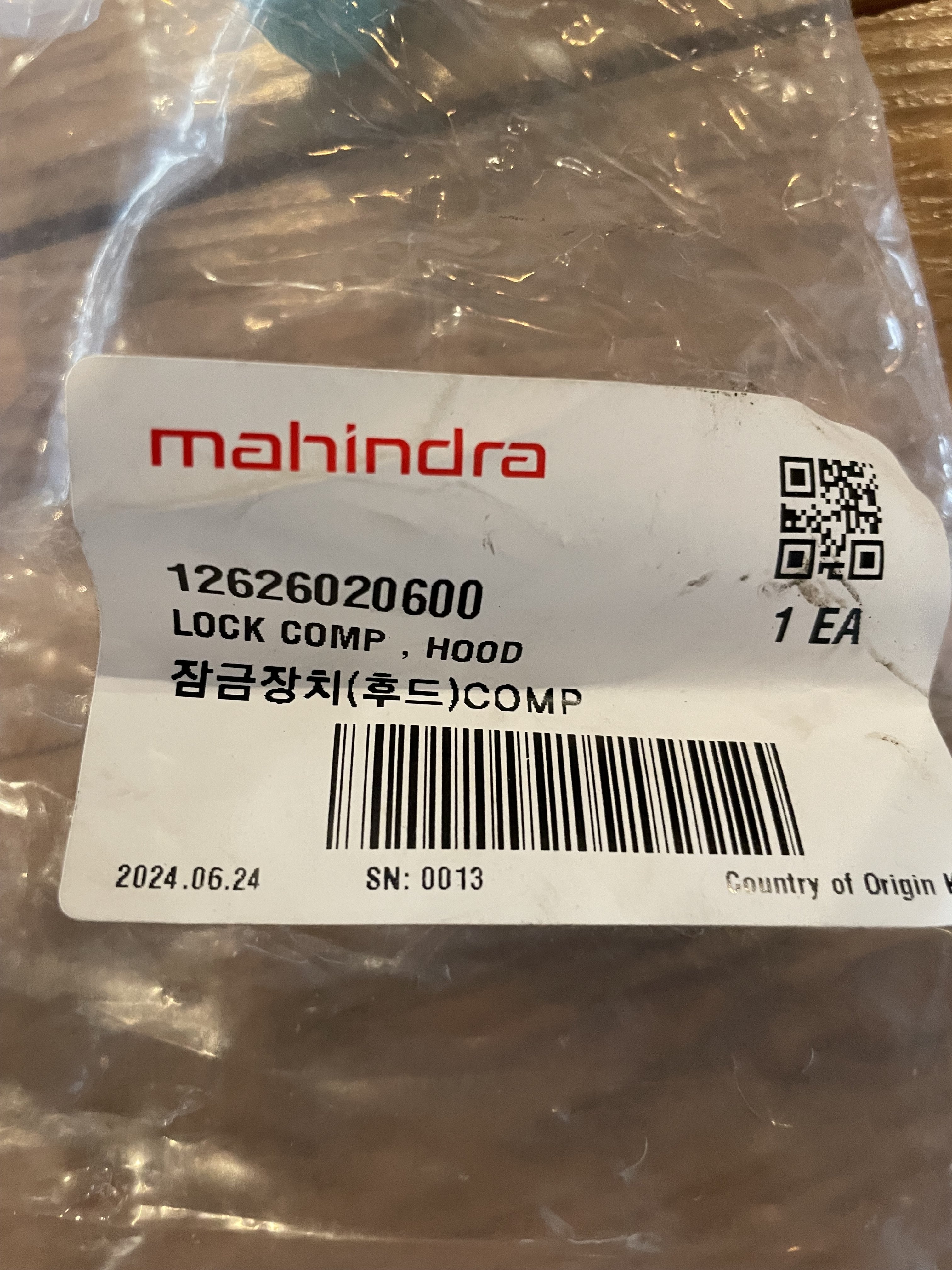

Replaced my broken hood latch. Took about 2 minutes and works like a charm. ***To replace, getting it off was a pain in the butt and I had to cut the latch from where it grabs the hood to hold it down. Probably should have done this a year or two ago.
Will try to avoid head on crashes and being rough on it from now on. The latch on the other was basically disconnected from the release and it wouldn't let go. Part number below for folks who might have this issue. Works on a couple of their tractors.
