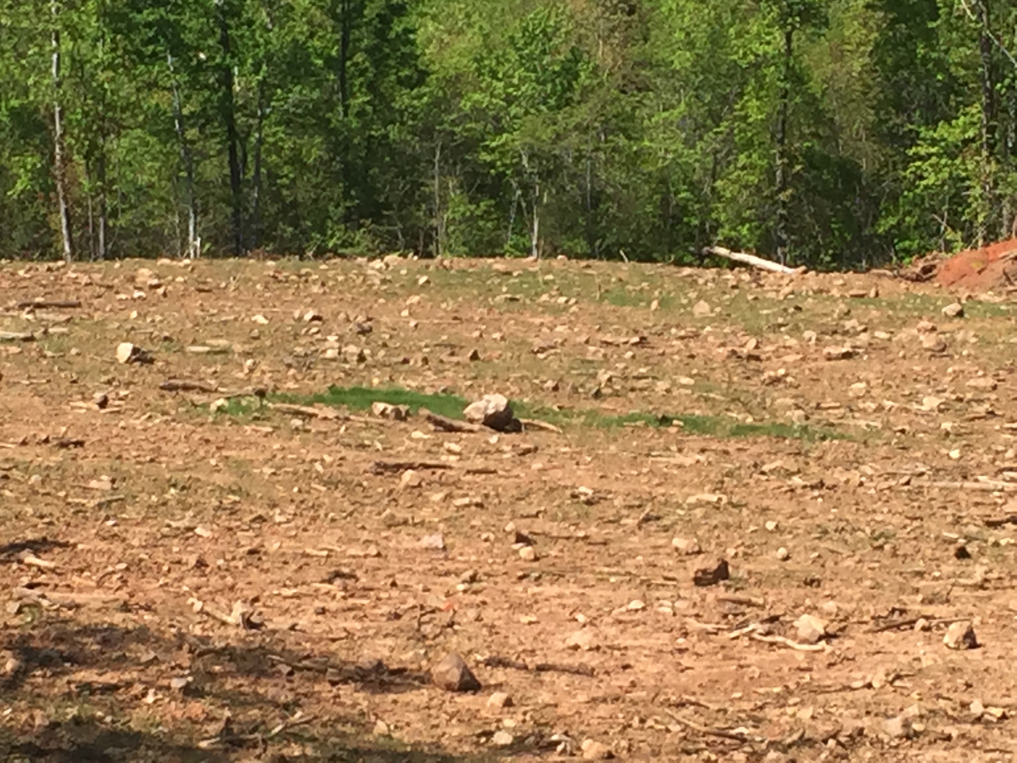

IMG_1165.JPGthis spring i plan on turning an old field into pastor. its an over grown area that is very rocky from small to 40-50lb rocks my question is what would be the best way to break up the ground i have a disc but don't want to destroy it should i plow it then disc? just looking for some ideas
thanks

its about 20 acres i now have a massey ferguson 2615 4x4
my plan was to plow it up then disc then rent a rock rake ( not landscape rake ) to windrow everything then use a skid steer to load the rocks into a dump trailer
I'm just trying to see if there is a better idea to break up the ground.... I've done a few other areas by just discing it up but those where not as rocky as the area I'm about to do and my disc has taken a beating I'm not looking to make the area into a golfing green it would be used for cows and hay the photo is an older pic of the area
thank you

I think I would run a rake over it first to get all the rocks that are already on the surface. Any plowing is going to bury some of these. That subsoiler attachment that I and Ken Sweet posted will work well for bringing rocks to the top of the ground. I think a rock rake on the FEL would work very well after subsoiling with the TR7 ripper. By the way, those things will sink about 12" into the ground if you have the power to pull it. You can remove as many tines as you have to in order to pull it.

Twenty acres to clean will take some time, why not start now? I would see how it goes on a small area maybe an acre so you can determine how large a rock you want to remove. Ripping with trip style shanks similar to what Sweet posted would be a good choice imo.
After ripping, raking and picking up the windrows of larger rock I would use a heavy duty cultipacker or heavy roller after seeding. Something to push the rocks down flush with the surface. The larger the rock you leave the deeper you need to loosen the ground to push the remaining rock down.

That is a ton of rocks. I thought I had it bad doing an acre, I used a box blade with the rippers all the way down and filled up 6 FEL buckets of rocks. It took hours to hand pick all the rocks. If I had 20 acres I think I would hire a small dozer and have them skim the top off into large piles on the edge of the fields. then go over it with a disc or rake, or plow either way its a huge task.
/ breaking up hard/very rocky soil #16
What's under the rocks when you dig down? Is it just more rocks that will keep popping up as you drag the top ones off?
